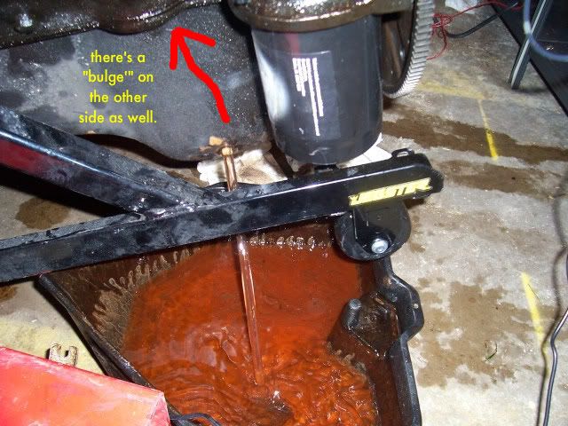

It won't work as the pan has two "bulges" to accomodate the dipstick on either side----technically you can run two dipsticks on a crate engine.  This was to make the crate a universal drop in.
And, also the hole would still be there.
