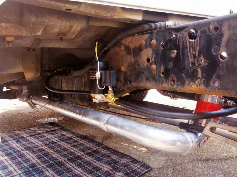

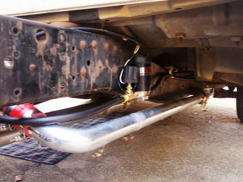

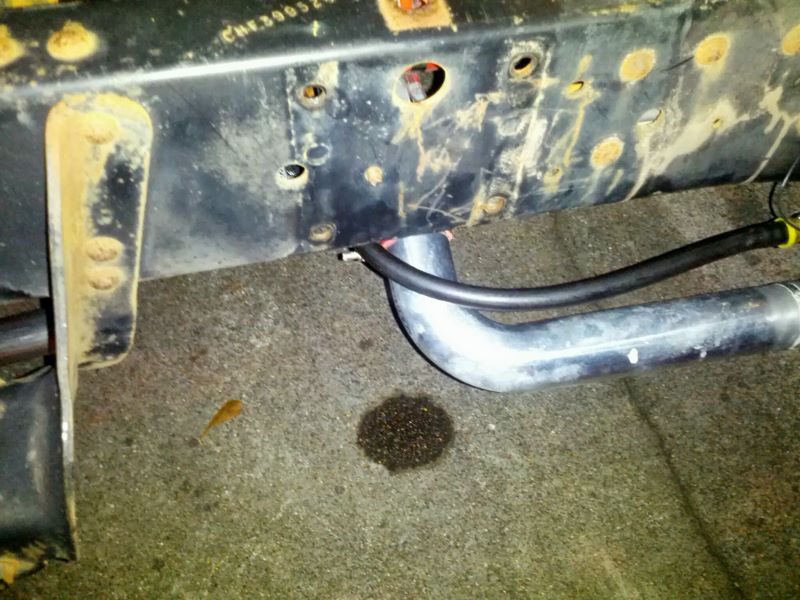

Sunday, September 8th, 2013:
Finalized the wiring for the 2 oil returns and warning switches for both Driver and Passenger side.

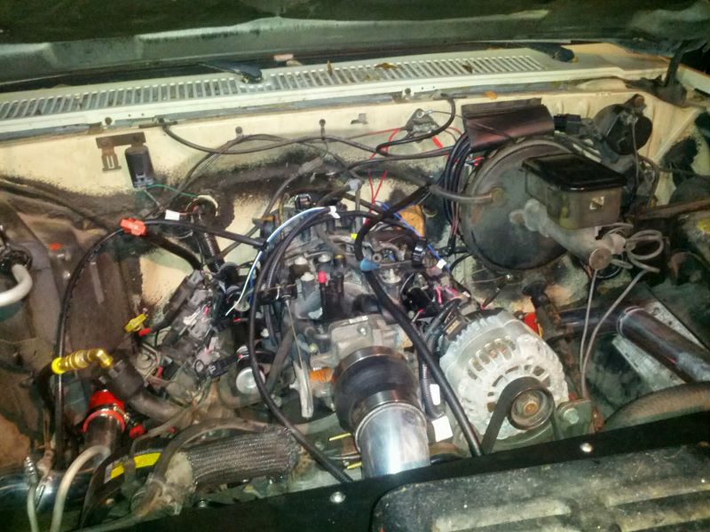

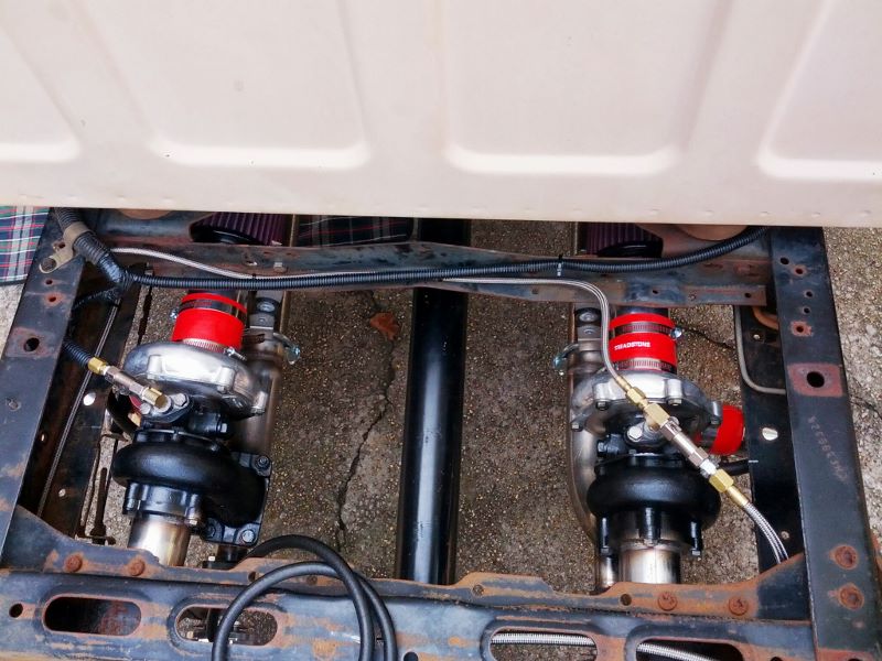

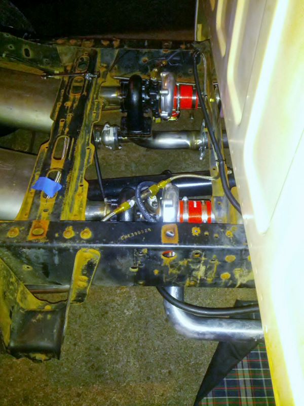

Tuesday, September 17th, 2013:
During the week I finally found an auto parts store with enough 1/4" vacuum line to run to the Turbos, so I got them setup and routed throughout the truck for both turbos (didn't get a final pic, was too late at night) and I connected it to the passenger side of the intake and I tapped the Blow off Valve into the brake booster line.

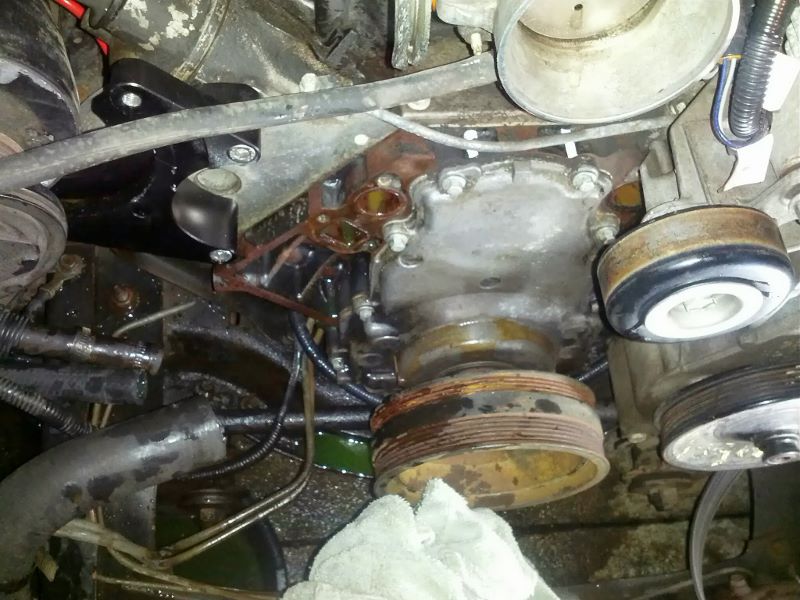

Thursday, September 26th, 2013:
Got home and pulled the AC compressor, AC mount off the truck and removed the water pump and found it leaking at the back. I had to counter sink one of the holes as I am using the high mount AC with the Original Compressor. Got it all back together and filled the engine and radiator with water and let it run up to operating temp to very there were no air pockets. Fans came on and everything looked ok.

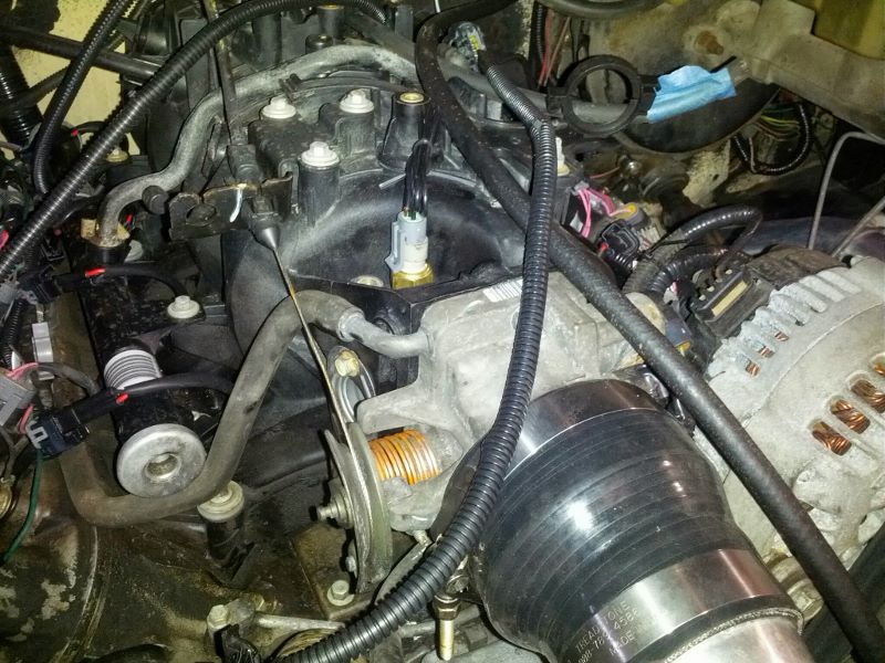

In this post, from research it said to swap the ECM from Red 15 to Red 52, this is NOT correct!, so I swapped it back...
http://forum.73-87chevytrucks.com/smforum/index.php/topic,12120.msg206488.html#msg206488

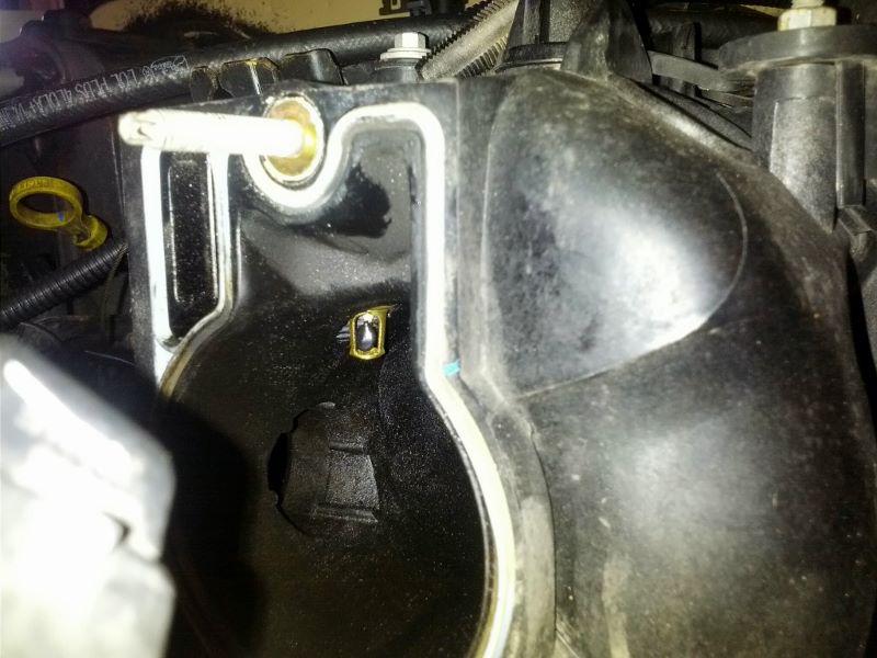

After making this switch, I am now charging at full capacity.
Now I needed to mount the IAT. I choose to tap the intake where the EVAP was with a 3/8" NPT and put in a 1991 Syclone IAT in its place. After drilling it out I then tapped it and now can splice the wires from the MAP into this to get the Intake temps. Hopefully he can start on tunning it soon!

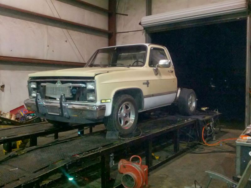

Friday, October 4th, 2013:
Had to go to the dyno shop last night and replace a header gasket on both sides that were leaking. Replaced the with new MLS gaskets and put it up on the dyno.
Hopefully today we can get a run out of her.

Saturday, October 5th, 2013:
Went by the shop to get the Speed Density tune started. After uploading the new tune we started playing with it and finally got it to idle (after running out of gas) and got the 02's down to around 14. Called it a day as we both had something to do. No videos as it was just us working on the Computer.
Monday, October 7th, 2013:
He got it running without dumping gas, but now I have a new problem. The EP381 pump is running out of steam and won't allow it to do a full pull. Now I am trying to source a new pump.
