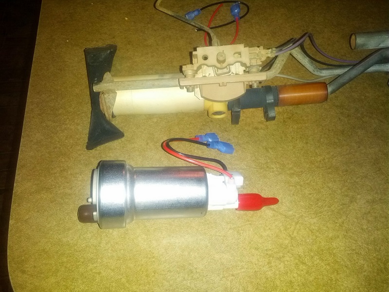

Friday, October 9th, 2013:

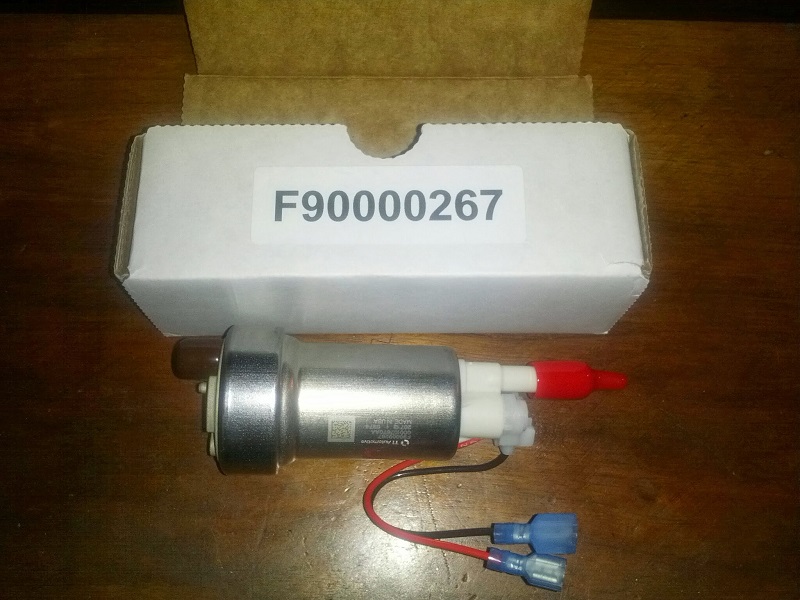

Ordered a Walbro F90000267 pump from Andy at
http://www.squashperformance.com/
Monday, October 14th, 2013:
Pump got here, now I just need to get it connected to the factory sending unit.

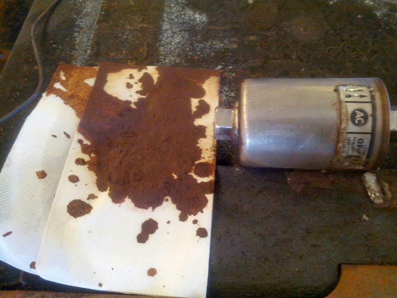

Went back to the dyno shop to determine the issue. Took enough braided line to bypass the filter and a new filter just in case. After getting everything pulled apart to bypass the filter I went to unbolt the inlet side and found an issue. Proceeded to pull it completely off and noticed some off-color tint. Grabbed a napkin and below is what I found. Apparently in my haste to get this going I replaced all the fuel lines but not the filter.
After getting the new filter on the initial pressure drop (not surprisingly) wasn't as bad, so reconnected the gauges and It was reading 50 at the pump and at the fuel rail. Then went to rip on it and it still was dropping but not as bad. We made a few changes to the fuel curve and it got somewhat better (we were dumping a lot of gas due to the previous lean condition) but it still was dropping to 30lbs right when the turbos were trying to spool (in neutral). Check voltage at the pump and it was reading a steady 12.4, and went to 12.6 at high rpm, but I ran out of time.

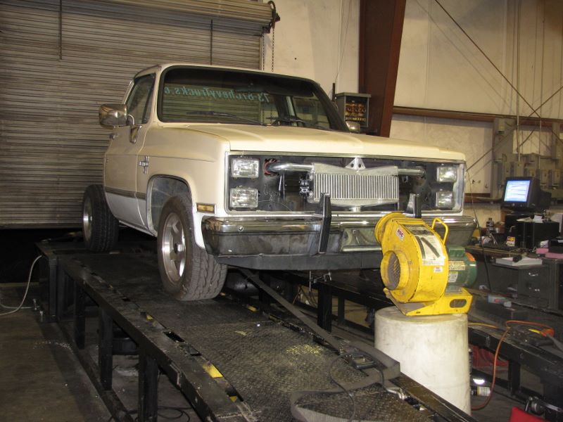

Tuesday, November 19th, 2013:

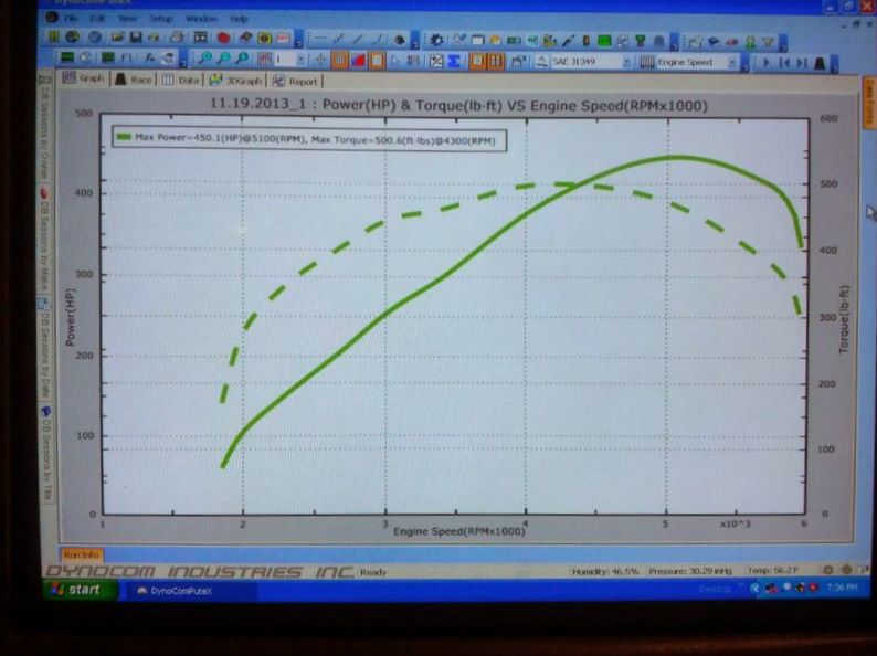

After a month we have the fuel sorted out enough to get the truck on the dyno at hensonperformance.com and do the Speed Density Tune for drivability. Still dropping fuel pressure, but we were able to pull to 6000rpms. Truck made 450.1hp @ 5100 and 500.6lb/ft at 4300 with 7.7lbs of boost all while spinning the single leg on the drum. Now I can get it back swap in the limited slip 3.42 axle, install the caltracs and get the bed put on and figure out the fuel filler and eventually install the 430 Walbro.

The drivetrain is probably eating about 80hp. If the wheel wasn't spinning it would probably have a different curve maybe more power.
Since this is a completely stock LQ4 that I never opened up I am going to be conservative with it. It is currently giving 7.7lbs of boost, I probably won't go over 10lbs, but I need the bigger pump in it first. If I can get near 550hp I will stop.

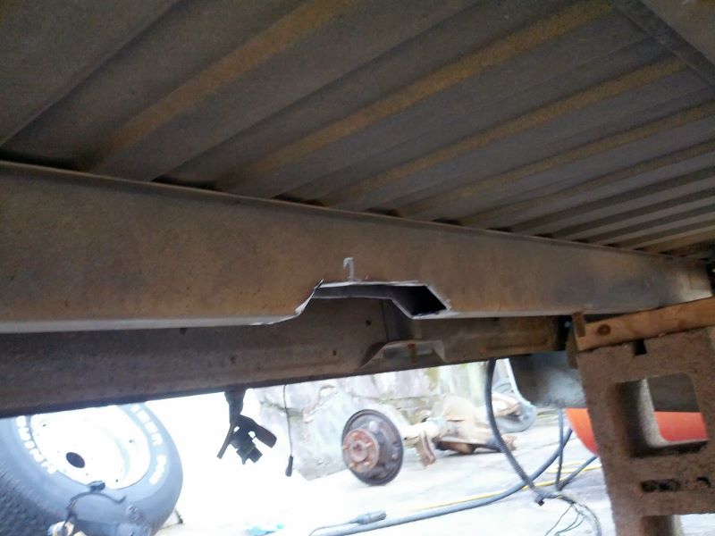

Saturday, November 30th, 2013:
Put the bumper back on the truck to have a tag, and set out to get the speedometer set. Simple task with Dakota's and I put a few miles on it. Got all the necessary tools to install the bed. Due to the Blazer tank you HAVE to notch the bed sill. Once that was done, with the help of my wife we got it set it on and ready for a photo op. Ran out of daylight so bed isn't bolted down.
quick pic of the notch before cleaning it up.

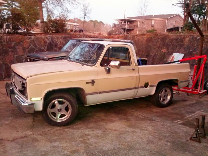

Monday, December 2nd, 2013:
Got the final bed nut tightened and took a few pictures out in the field. From about 20 feet away you can't really tell anything is going on from the side, well apart from the intercooler in the front, but...

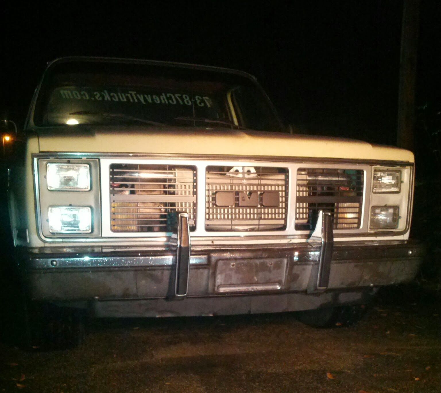

Got busy mounting the Aftermarket Grill (have a billet one, but it needs to be notched to clear the intercooler) install. It now has an identity crisis. I also got my hotwire kit and new sending unit wiring to mount the Walbro 430 pump on the stock hanger.
Tuesday, December 3rd, 2013:
captured a picture of the truck before leaving for the day. I sure haved missed driving it. I have driven only it for the past 2 days.
