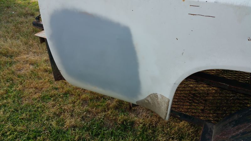

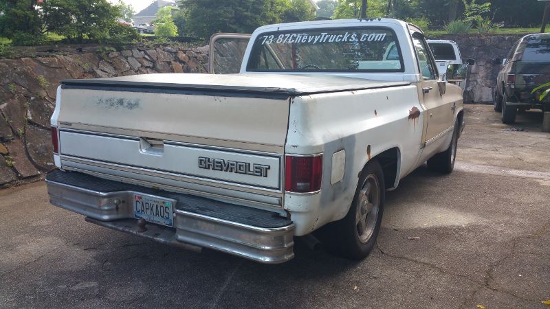

Friday, May 15th, 2015:

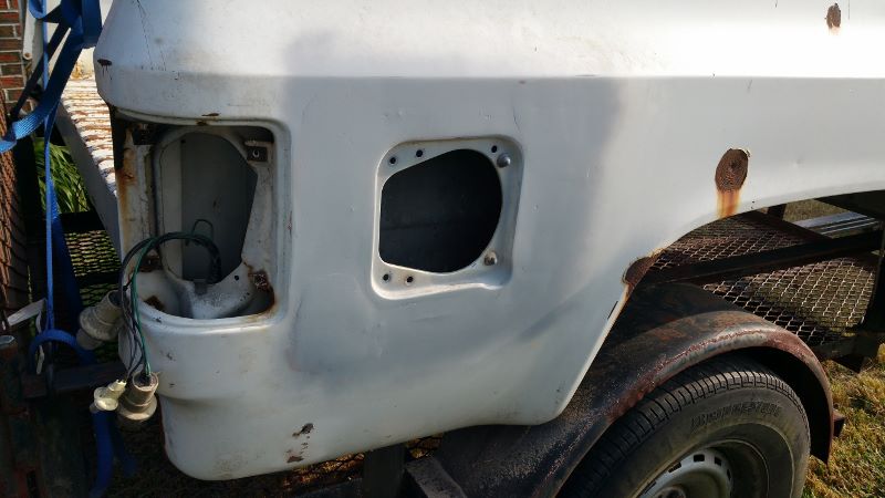

I was supposed to have a passenger side door opening for the bed but it didn't get here in time so the body guy ended up just swapping each to either side. I still has times it will bareley open but it does work.

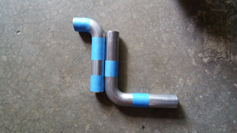

Sunday, May 24th, 2015:

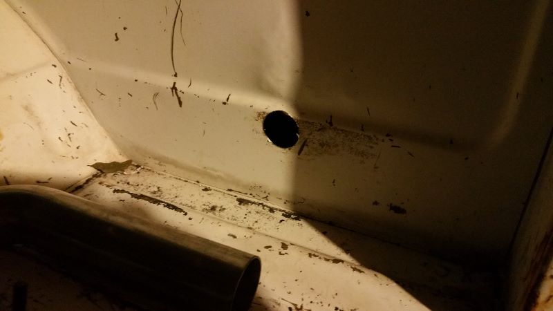

I started on the beginning process of getting the hole in the bed for the Blazer filler. Had to go buy a few more hole saws and body saw blades but it was a start. When I ordered all of my piping for my turbo setup I also ordered some stainless tubing for just this reason, you can see one piece in the foreground here.
Posts: 18512
Re: 1987 R10 Driver
Reply #332 on:
December 09, 2015, 09:45:09 pm »

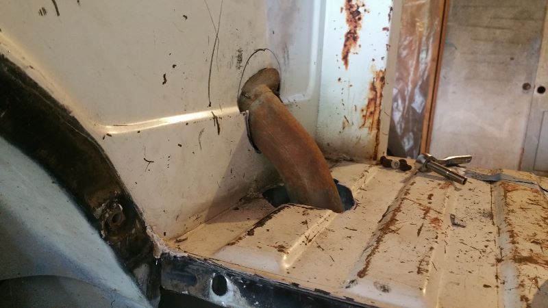

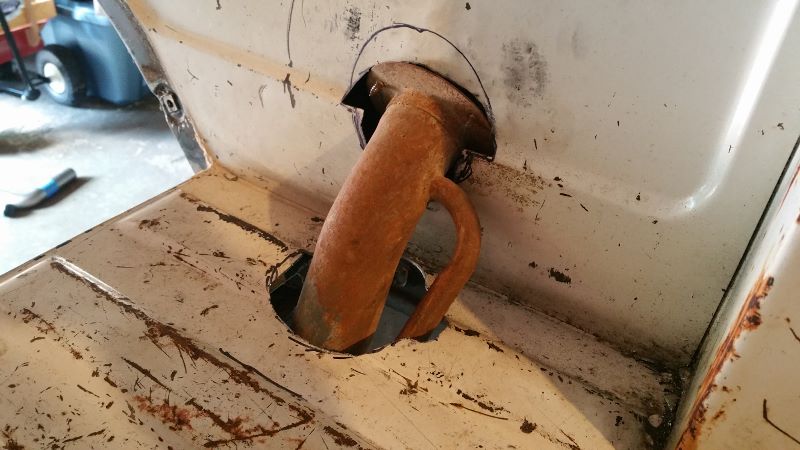

Monday, May 25th, 2015:
At this point I had worked on this for a while. I had a fab'd filler I was working with to see if it was going to work (it ended up not working). I did get the fill piece and the filler mounted in the hole, but the filler wasn't going to work with what I had. It needed to turn into the cross sill...

Thursday, May 28th, 2015:
Due to space confinements and the location I needed to drill a hole in the cross sill I had to remove the inner fender on the bed. It was at this point I realized that I had to have the Blazer filler neck to make this happen.

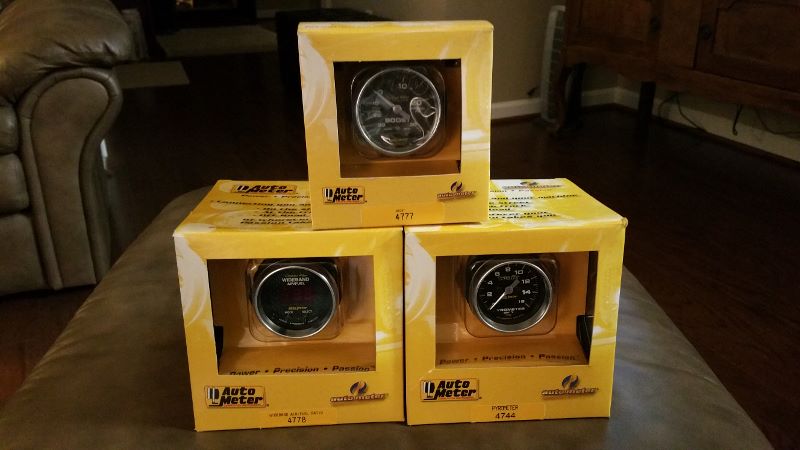

Friday, May 29th, 2015:
I had ordered some gauges for my Pillar Pod that I was going to actually use. I got carbon fiber to closely match my Dakota setup. I purchased a EGT, Wide Band and Boost. My plans were to get them connected and in used before Power Tour. I can tell you now that didn't happen, and it still hasn't happened...

Saturday, May 30th, 2015:

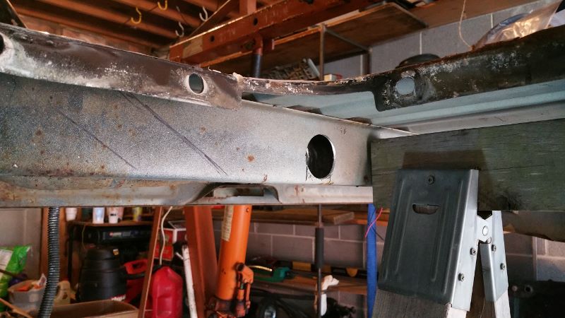

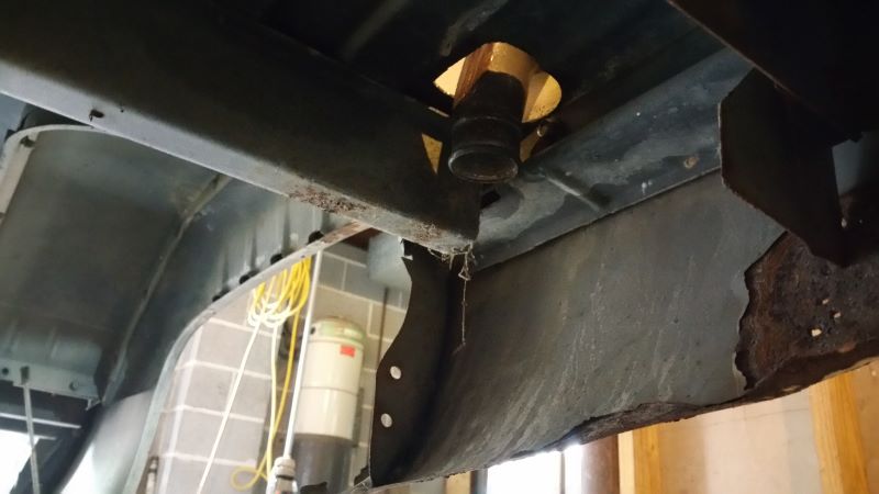

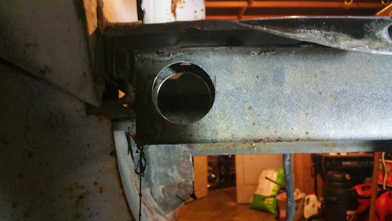

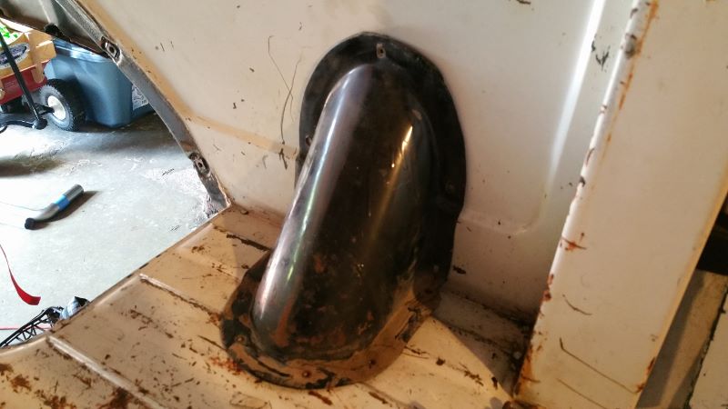

Back on the Filler and bed. I got the pieces of stainless tape marked where I wanted to cut them. I went to a buddys to have them cut on his band saw that afternoon.

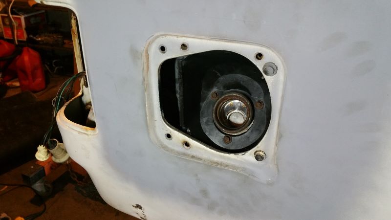

I drilled a different hole in the cross sill near the end of the wheel opening.

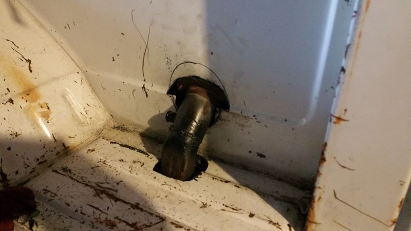

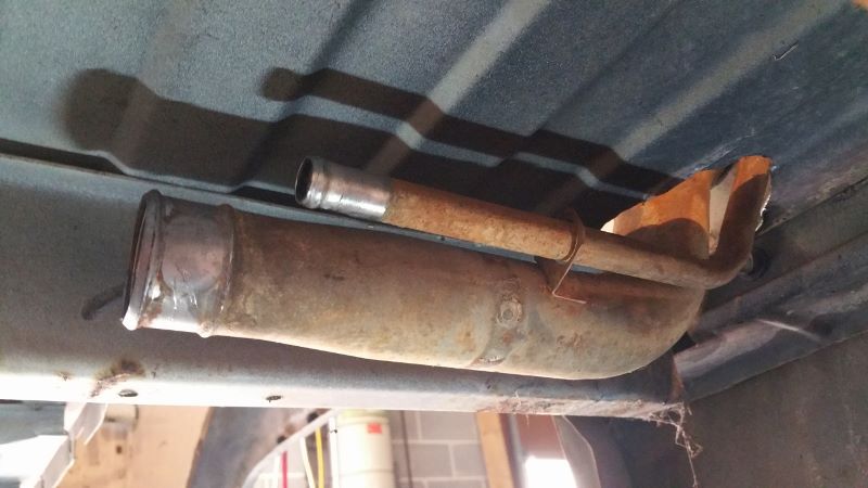

I kept waiting for the Blazer filler to get here and I finally stole the filler from my 2WD converted Blazer so I can get this one on the road. Not what I wanted to do but Power Tour was getting closer and I couldn't wait. This is it installed
View from the bottom
View of the Vent hose opening.
View of the Blazer filler cover (that is STILL not on the truck)
Posts: 18512
Re: 1987 R10 Driver
Reply #336 on:
December 09, 2015, 10:03:14 pm »

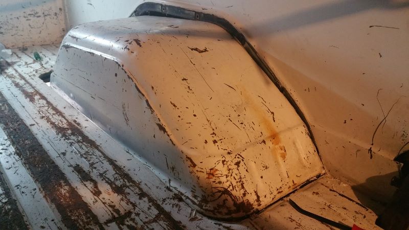

Sunday, May 31st, 2015:
With all the pieces (hopefully) in place I removed the matching bed from the truck.
Had my brother come over to assist, not shown, but the bed was in this position A LOT while we tweaked the tubes. I should have cut a slot in the cross sill and plated it, but at this time in the game it was WAY to late. We worked on it for 3 hours sneaking up on getting it on there.
This is the Money shot. After a number of hours working on this I had him follow me to a gas station I knew I could not fill it from. I dropped it in the filler and watched it, safely out of the rain.

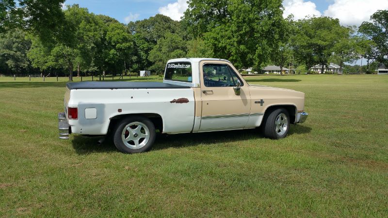

Monday, June 1st, 2015:
Since it was so late I took a few pics of the truck with the new look..

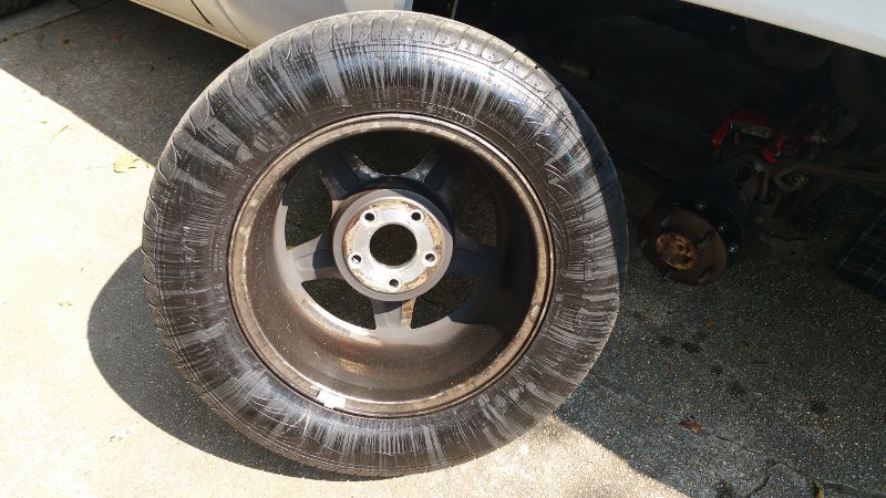

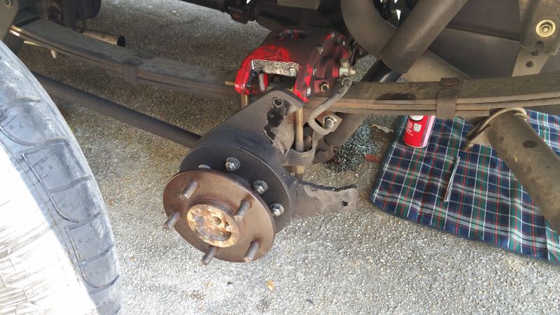

Sunday, June 7th, 2015:

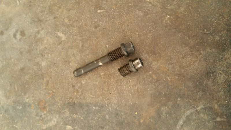

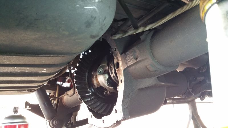

The seal on the rear end had gotten to the point I really wanted to replace it prior to leaving on Power Tour. With seal in hand I proceded to get after it. With the wheel removed, you can see it was pretty bad. Keeping in mind the truck was not washed for probably a good 6 months...

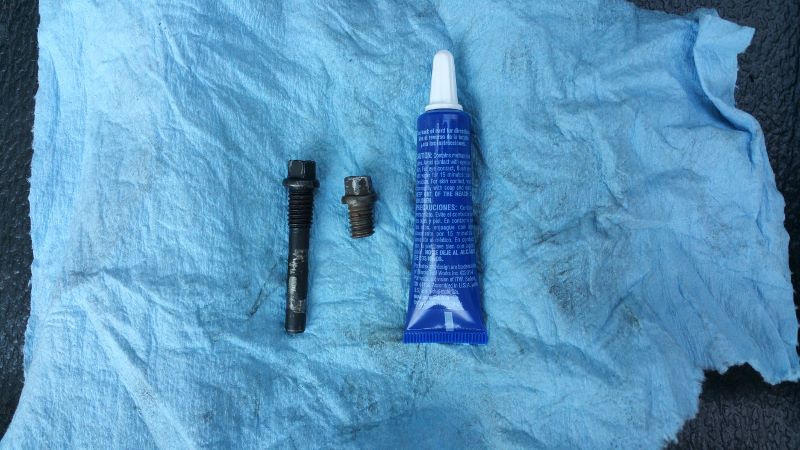

I pulled the pumpkin cover to get the cross pin out to remove the axle.
Probably couldn't see it in the above pic, but when I removed the pin, I found I had an issue...
Since Power Tour started in 2 days. I chose to drop the pin back in the truck and follow it up with some lock tite and hope for the best.

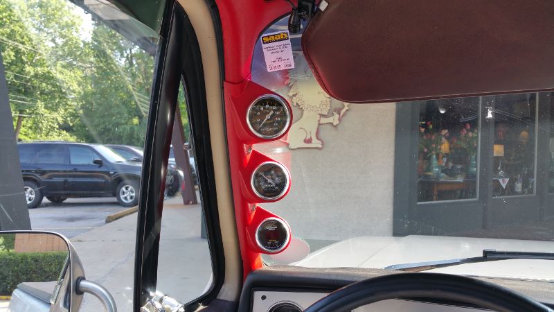

Thursday, June 18th, 2015:
I was dropping off some Pillar Pods that were ordered and someone wanted a picture of them and my new gauges installed (which are STILL not hooked up)

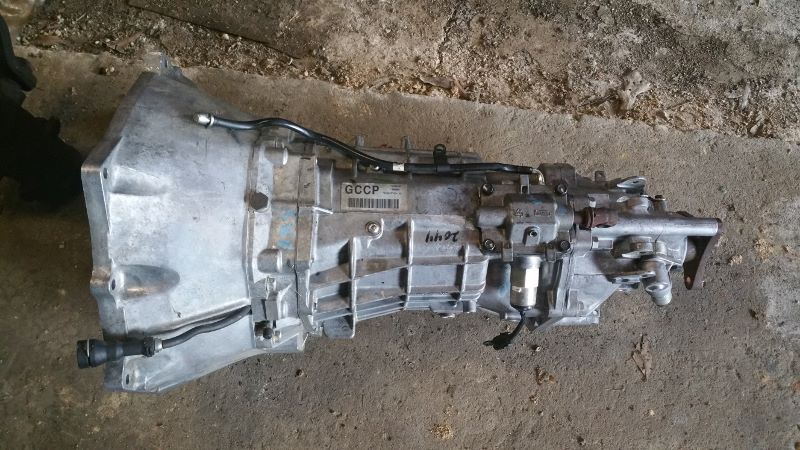

During the week prior I was browsing Craigslist as I normally do and I found a T56 out of a 2007 CTS-V. I recognized the number as the guy that welded my turbo setup for me. I called him, we made a deal and I got this thing from a REALLY good price. It probably won't go in this truck but I didn't have anywhere to put it, so.. Plans are to drill out an F-body Tailsection for an HHR mainshaft and swap everything over to make a stronger trans.

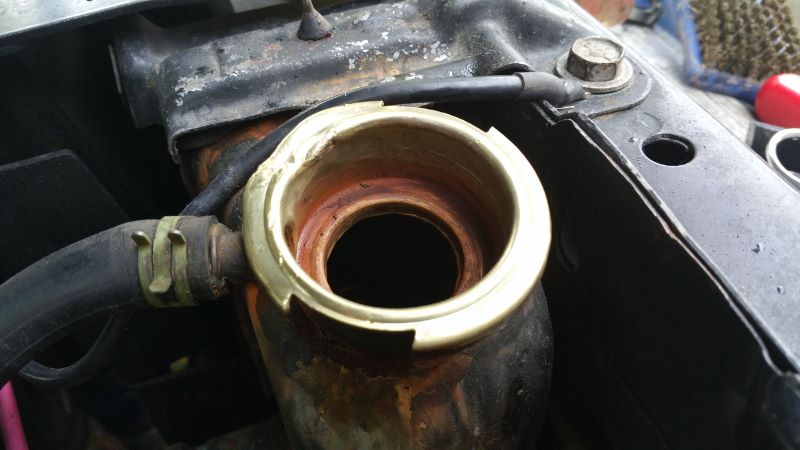

Saturday, September 5th, 2015:
Ever since returning from Power Tour I have been topping off my Anti-Freeze. I planned to go to LS Fest on the Sept 11th, so I had to figure this out. I cleaned off the radiator and drove it pretty hard for a few days and this is what I discovered. I have no idea how that dent got there, but apparently I have leak. I ended up putting the aluminum radiator I had in the truck prior back in. Since that time I haven't had any issues out of the truck.
