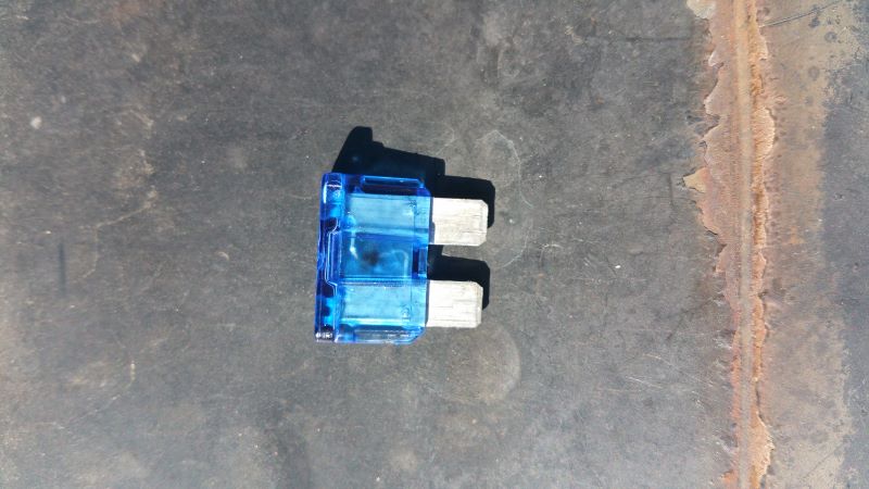

Sunday, January 17th, 2016: I was out in the truck for lunch and it started overheating.  After pulling over and inspecting everything I found this blown fuse, replaced it and was on my way.

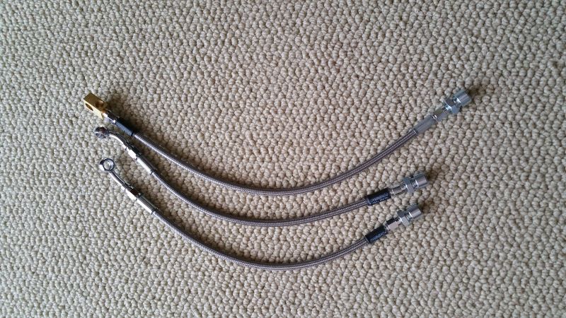

Wednesday, March 19th, 2016: I got the braided lines in from Inlinetube.com  This is what I used to fix the bursting factory brake flex hoses. I modified the bracket during this time but is wasn't permanent.

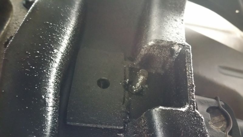

Also during this time I started hearing a loud clunking noise from under the truck when shifting from reverse to drive.  I got home and got under it and discovered the nut, washer and lock washer were no longer on the transmission mount.

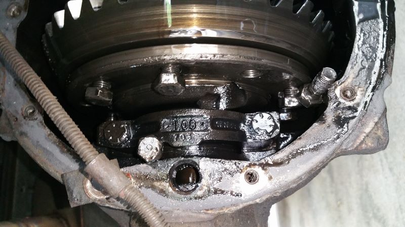

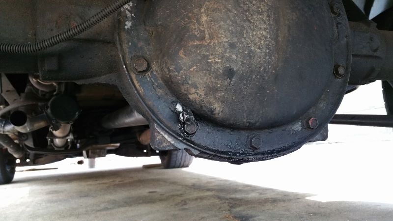

Monday, April 24th, 2016: This day I drove to work and on the way back from lunch I discovered a large oil puddle under where I had previously parked.  Getting out and inspecting it had a familiar smell but I couldn't place it.  On the way out I realized it was gear oil.  Upon inspection I found a bolt trying to exit my diff cover.
After getting home and pulling the cover I discovered the following.  It appears the person who put my rear gears in missed an important part of the equation, thread locker.  Needless to say my gearset was toast.

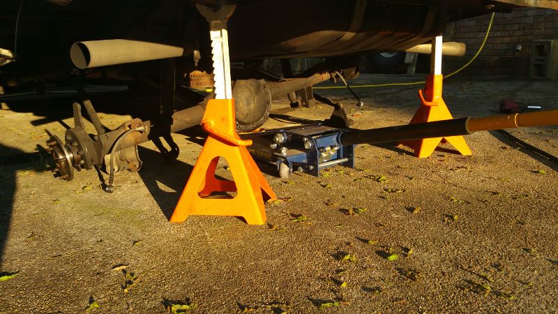

Wednesday, April 26th, 2016: Spent the evening pulling the rearend out to take it and get it fixed.  I got it back in on May 5th.

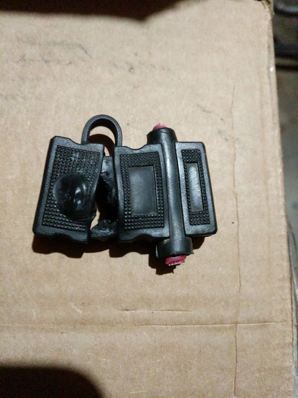

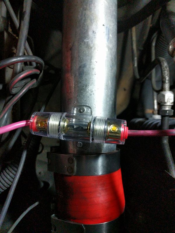

Saturday, April 21st, 201:  Remember the blown fuse from April 2016, well that happened again a while later the fan would randomly stop working.  During this week it stopped and didn't come back on.  And I found the issue.  The fuse holder was Flawed.
I contacted Perma Cool and talked to them about this and they told me that they had updated the kits with a new fuse, so I had them send me an updated piece.  This won't flex and blow like the last one...

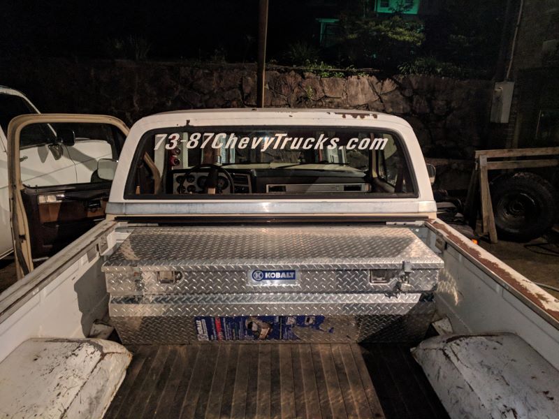

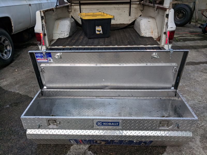

Sunday, July 9th, 2018: Picked up a In Bed Aluminum Tool Box that I could mount in the bed and put important items in for the trip, jack, tools, extra parts, etc along with some parts that I could sell.  I spend the evening cleaning it up.  I also ordered a replacement key for it as they were using pad lock latches..

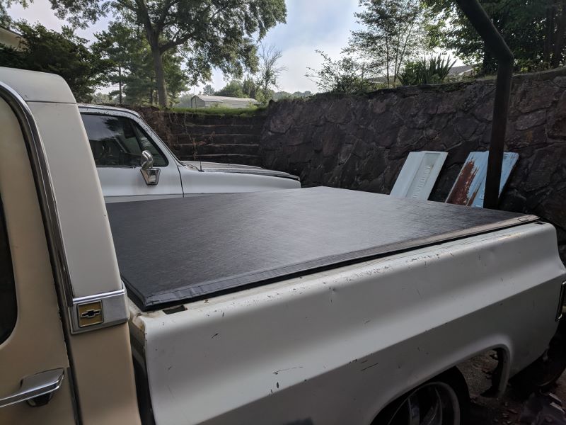

Monday, July 10th, 2018: Spent the evening mounting the box to the bed using the factory bed bolts to hold it down.  I discovered that it was going to be a pain to access it with the Extang FullTilt cover I had on the truck, but I ordered a new cover material anyway.
Wednesday, August 15th, 2018: For my search on a new cover I ran across the TruXedo Duece and ordered one.  This cover rolls up from the back, but the front portion flips backwards on a hinge.  I got it installed this evening.

Thursday, September 6th, 2018: Picked up the new Crew Headliner proofs this week, this shows how the Duece Cover flips back.

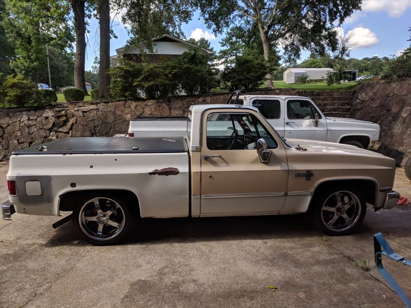

Saturday, September 8th, 2018: Drive up to LS Fest with Live85 and walked around the show.  Talked to by buddy Rick Squires (STS Turbo) who is in business with Holley now and a buddy Bryan snapped this pic of my truck.

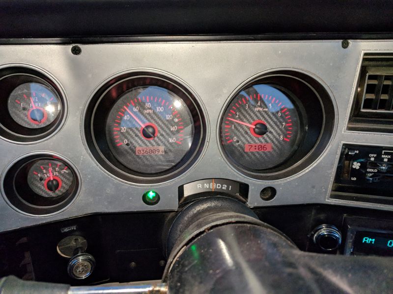

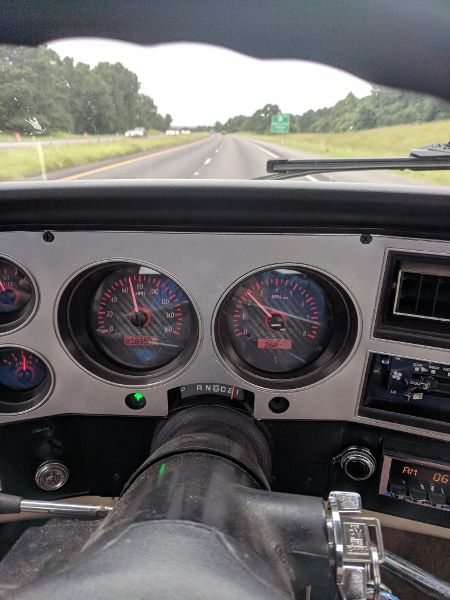

Friday, July 12th, 2019:  While driving to the All Chevy/GMC Nationals we got stuck in traffic which came to a stand still.  During all this when traffic started moving, the truck wasn't.  I had to gas it to make it shift to second.  We ended up making it to the hotel but only after the trans temp hitting 300 degrees.

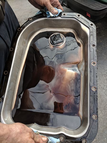

Saturday, July 13th, 2019: I decided to risk it and have them pull the pan and see how bad the damage was and put a new filter and trans fluid in it.  Hard to tell from the pictures but that is alot of trash in the pan and the magnet is coated with metal.  In adition to the smell that rushed out when the pan was dropped.
We went ahead and went to the show and met up with a number of friends but we left early so I could hopefully drive it home.  Supprisingly it made it and we took the interstate the whole way and never stopped.  All 200 miles.  Trans temps were around 240ish.
20 miles from my house I had to stop and needless to say I drove the last few miles home in second gear.  Truck was at 38991.7 miles and the trans was toast.
