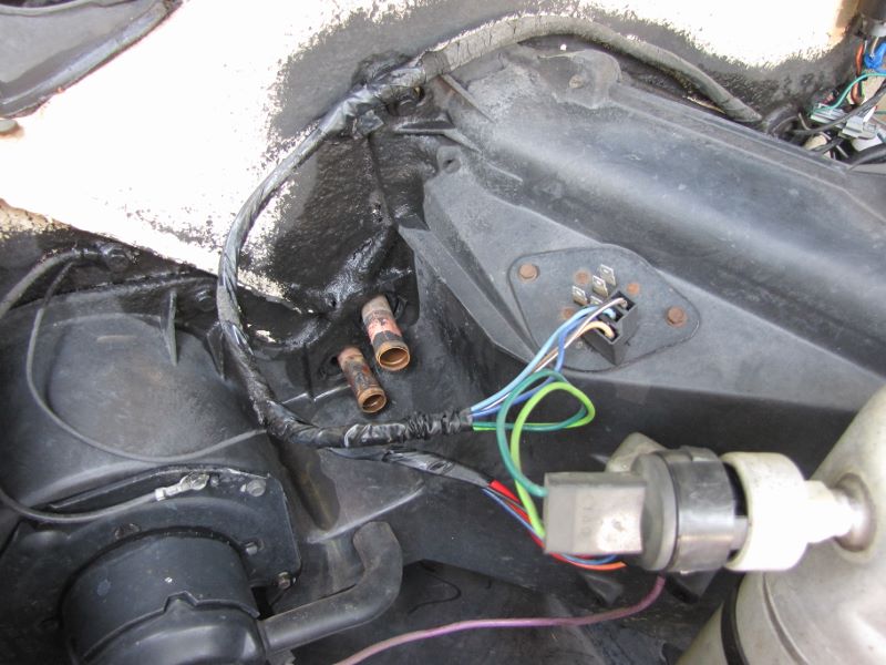

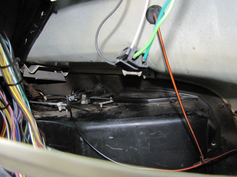

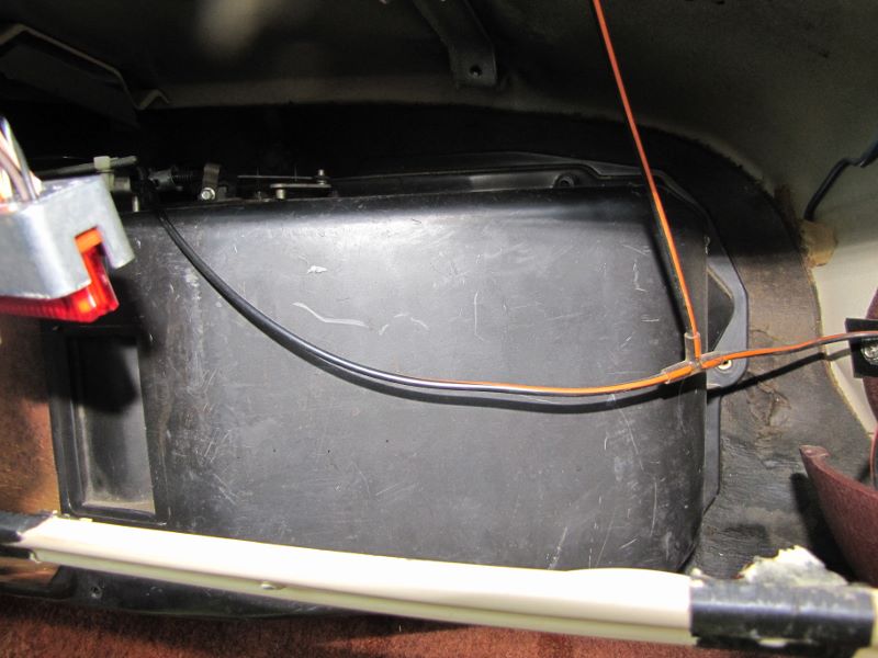

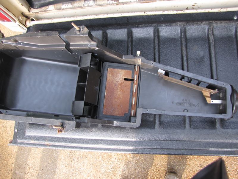

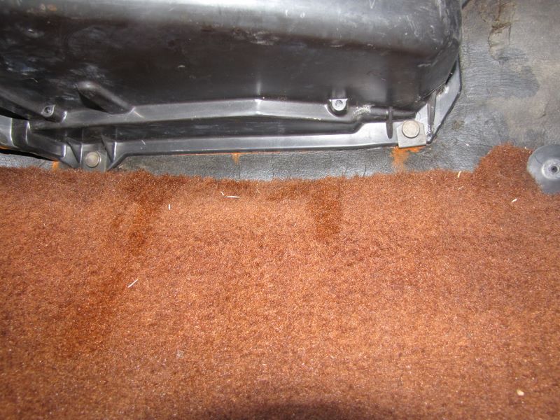

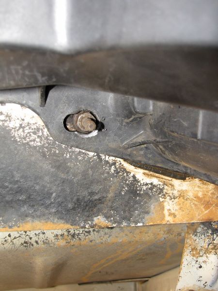

Thursday, May 15th, 2014: Heater core started leaking really bad.
Saturday, May 17th, 2014: Picked up a replacement heater core on Friday and started to remove all the required components.
Removed the heater hoses, removed the internal bolt and cable assembly, remove the outer bolts, dropped the inner fender and removed the 2 lower bolts.  Pulled the internal assembly out, cleaned it up and reinstalled.  (I lost a lot of pics on this and was running out of daylight...)
