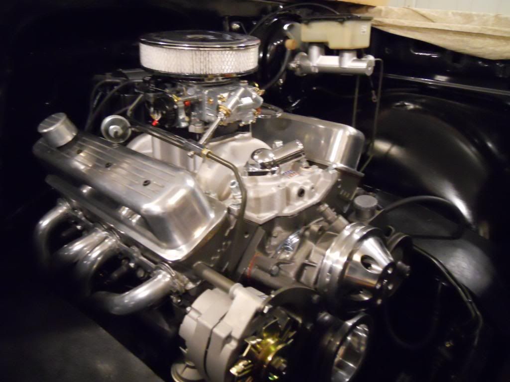

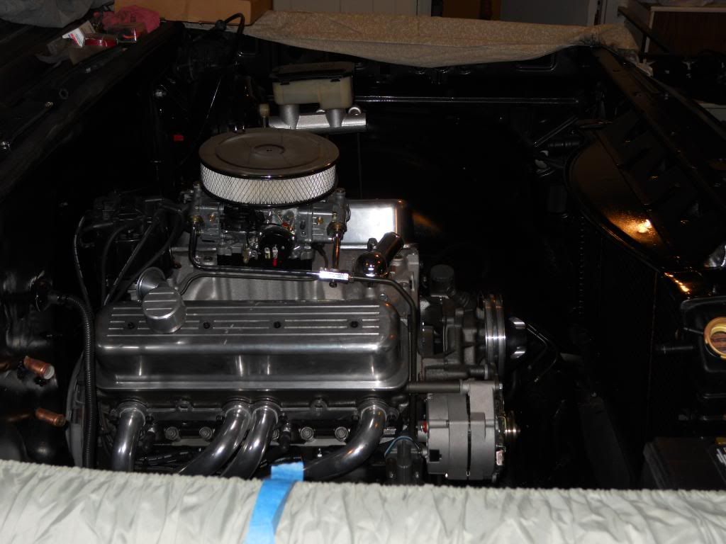

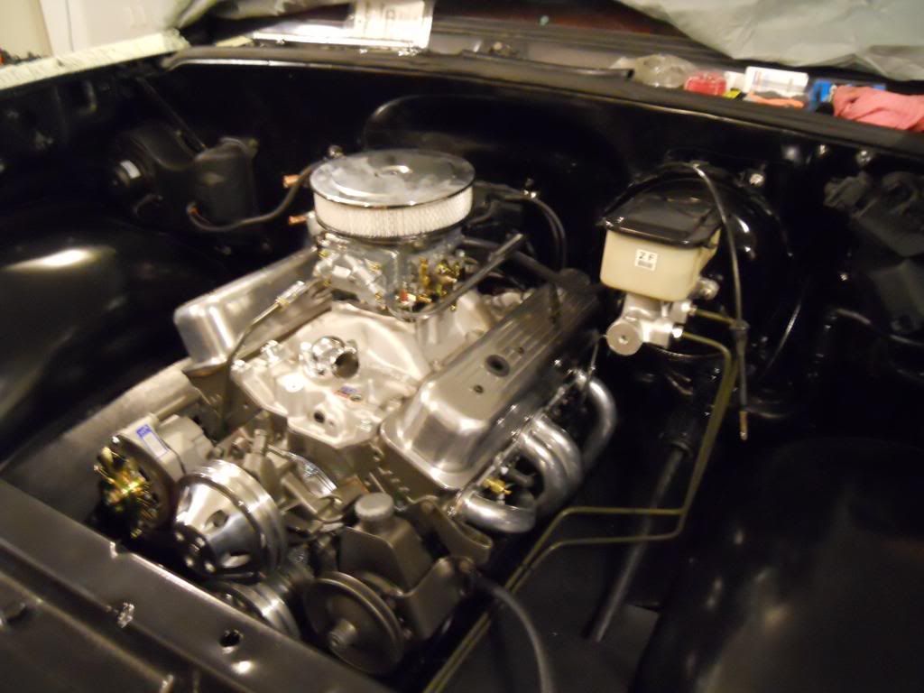

here are some pics, the engine is just bolted in the mounts, no trans yet. I will be making/modifying the crossember etc this weekend. The valve covers and air cleaner are not the ones I will use. It is dirty in the pics and most things are not finalized but it should give you the general idea.

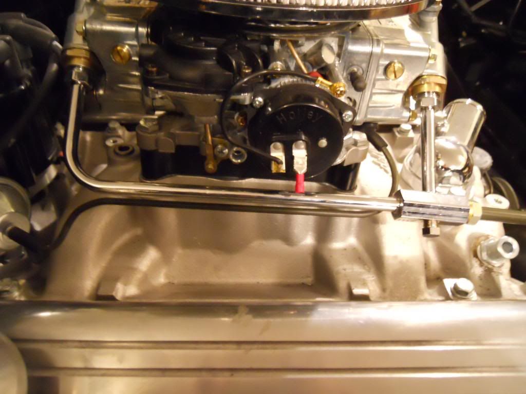

fuel line and vacuum adv.

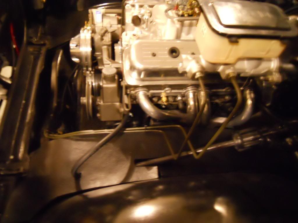

brakelines replaced
e fan mounted

I wish my engine was that dirty. I like those valve covers, but the air cleaner is too small for me.

Where are those valve covers from, I've never seen a set of centerbolts I liked until now.

billet specialties looks like -
