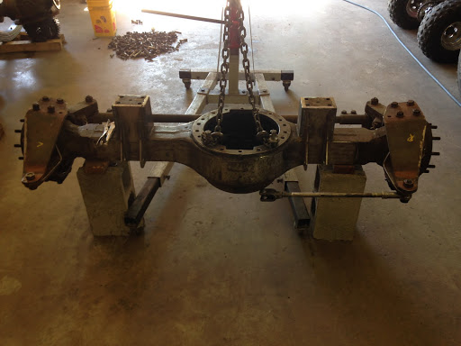

I bought the first of two required aerospace quality 3/4" female rod ends that I will use on my steering cylinders. The cheapest I have found these is $130.00/ea. At that price I have to wait for the budget to catch up before buying the second. The speed shop variety are much cheaper, but knowing the difference, and the margin of strength, and safety, I'll hold out until I can get the second of this part number.
Finally, the metal fabricating portion of this project is about to wind up, and come to an end.
Finished fabbing my leaf spring clamps/lower shock mounts:

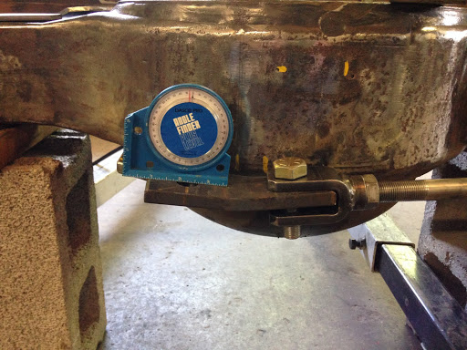

The final step in this phase of the project is the layout of the steering cylinder center support.
The white soap stone mark indicates dead center of the axle. As you can see with the differential offset the bracket will have to wrap around the differential housing to be properly centered on the axle.
I hate to make mistakes, and since paint pens, and soap stones are cheap in relation to the expensive 1/2"x6" plate that I am fabricating, I make myself ample notes to prevent any folly.
Setting up the steering cylinders with full right and left steering travel meant placing the location of the anchor pin end of the cylinder on the center support with the cylinder in the fully retracted configuration.
This photo shows the set up dummy cylinder as it represents the pin, and rod end location if the cylinder was fully retracted. In this view the steering is placed straight ahead. By steering fully right I can locate the anchor pin hole on the center support. Then vice/versa for the left.
However, that had to wait because the steering stop for each side was located on opposite knuckles the toe had to first be adjusted as not to mislocate the pin hole by drilling it before adjusting the toe.
Since I am switching the axle around opposite as it set in the 5-ton what was toe in now became toe out.
In this blurry view you can see the bars I used to adjust my toe setting at 1/4" toe-in with what would be a 40" tall tire.
50 odd years of out-in-the-elements seasonal changes and dust, and dirt blowing around made that tie rod a bugger to adjust. I finally used (to my chagrin) a 4' pipe wrench to break it loose. Then I fully unscrewed it and completely cleaned the threads of all of the foreign matter. Problem now is that I have to dress the chew marks off the tie rod where the pipe wrench gnawed it all up.
With that complete I could continue with the fab of the center support.

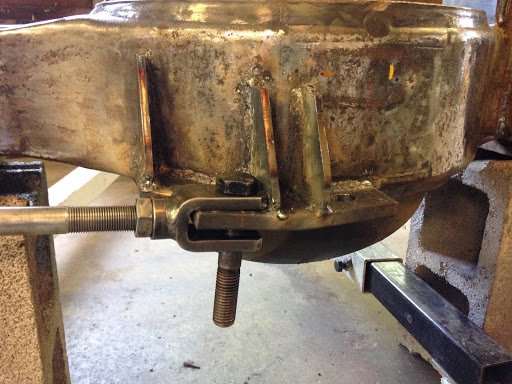

I finally was able to mount the steering cylinder center support. Had to go back and add a little more camber. Took forever, but I want to get it as close as possible to neutral so the steering cylinder pins don't bind up as the cylinders operate. After I modify the mounting clevises on the steering cylinders to suit my tastes I will need to go back and mount them and cycle them with compressed air just to be sure that there is no binding of the pins, or the rod ends. This is critical for reliability, and long life. The cylinder rods, and pistons are not designed for side loading, and the rod ends only specify a slight amount of side loading for continuous operation. If the cylinder rod, and piston is side loaded it will wear at an extreme rate on one side, and could even bend the rod.
Last weekend, setting up to be even, and level:
Welded on with bracing:
A clear pic without the cylinder set up jig:

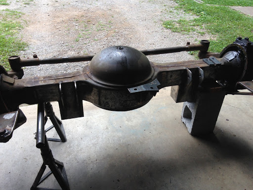

One evening this week in preparation for sand blasting the rear axle I experimented with polishing the rough off of the housing. I think it looks good. Going to do this to the front of the front axle housing.
Here is today. Going to do the bottom side:
Big, and cool, huh? ;)
A close up of the underside:

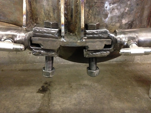

Since this is the steering cylinder mount any failure of any of these components is a potential for a real disaster. So, to avoid any possible issue with a cavity, porosity, or a weak weld, I dug this water line trench down to the upper weld. I wanted total penetration for a complete and overlapping securement. (now I know what a dentist experiences when looking for the bottom of a tooth cavity. 8)
After about 5 passes with a few extra amps just for good measure, I gave her a little dressing to make her shine.

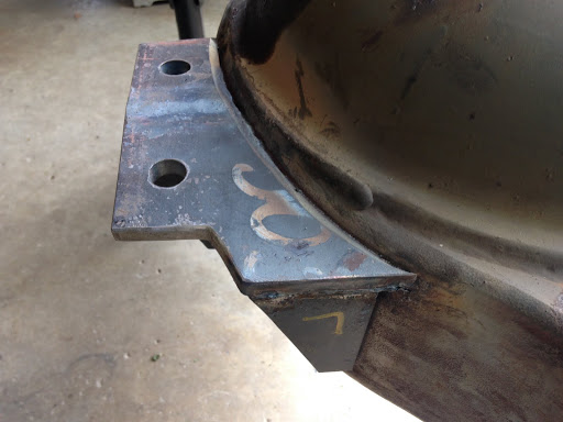

Then I went about adding the 3/8" flat stock to bring the mounting points up to the 7/8" thickness the cylinders are made for.
Side on:
A pic of the cylinder set up jig. As I say, next will be to focus on getting the cylinders modified for 3/4" anchor pins. (currently is 5/8") then I will mount them up to see if any material will be needed to be removed to eliminate any binding.
