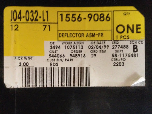

As I posted in the past, it is critical to me, with this build, to use as many GM OEM parts as humanly possible. I was able to aquire one of the last pieces that I need to finish the body of my truck and keep it all GM.
This is the front air dam that goes under the front bumper of 1981~1987(91) K/V series 4x4 trucks without tow hooks. This is the taller 5.25" air deflector as opposed to the 3.5" unit that was available on the C/R series 4x2 trucks.
This photo shows the parts bin tag with an OE date of February 1999. That put this part at 16 years old. I think we can call it a "NOOOS" part. Hehe.
After I reserached this part number, and knew what I wanted, I set out to find said part from the OE supply chain so I didn't have to use aftermarket. (again, as previously mentioned, not intended to slight the guys that use aftermarket, just trying to avoid it on this build) Anyhow, my local Chevy dealer found out for me that this part was long ago discontinued. A search of dealer inventory revealed two dealerships that showed to have one each in stock. A call to the first dealer proved their inventory to be inaccurate, and they didn't have the part. A call to the second was paydirt, and we were able to locate the VERY LAST K-series 4x4 front air dam available from GM. Just like the '91 Blazer V22 grille in this project I GOTS ME THE LAST BRAND NEW ONE FROM GM!!!!!!!. And even better, the dealer I bought it from priced it to me including shipping, for less, or about the same, than the aftermarket has it before shipping. How cool is that?

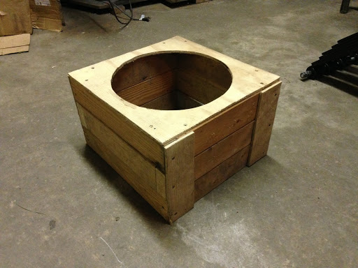

No that is not a new appliance for my bathroom. I made a box to drop my front differential down into that I could seal up with a trash bag and not have to worry about getting blasting sand and paint on the gears and bearings.

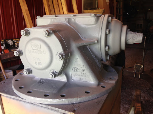

Sandblasted my front differential:
Then put the primer on it.
I am using DuPont epoxy primer. It is tough stuff. I love using it but hate putting it on. During the front end sheet metal phase I had trouble getting it to lay out. I did some experimenting to see if I could improve the application. The TDS calls for 8~10psi at the cap if you apply it with a HVLP gun. This just causes the epoxy to spatter. I tried thinning down the epoxy with some reducer when applying it to the front end sheet metal. This worked slightly, but not satisfactorily. The formula calls for a 4:1 mix of epoxy resin, and activator. I did a 4:1:2 formula of epoxy/activator/reducer. Then I dialed my HVLP gun up to 40psi. This trick worked. I got good coverage with no runs, and no spatter. My 1.4mm tip HVLP gun is not ideal for epoxy primer, but I made it work.
Then I put the color on it. DuPont chassis gloss black.
The differentials, springs, shackles, and lower shock brackets will be gloss black. The axle housings, steering knuckles, tie rod, and frame will be gold. I think it will look good under the blue body.
