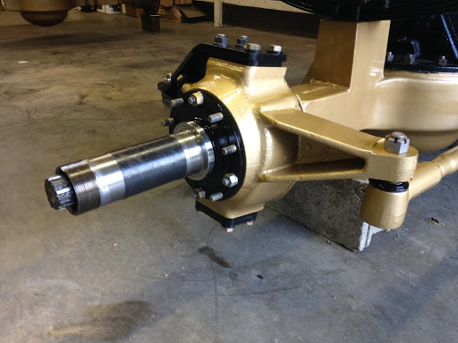

And finally I was able to find time to put the front axle back together.
This pic shows how I painted the spindle since it will be visible after the truck is put together. Nuts, studs, and lock washers will be painted later as well:
Then I added the hubs. All four hubs will be coming back off so I can sandblast them and paint them. I need to add more lug studs. Just wanted to get the frame rolling so I can mount the body. :)
