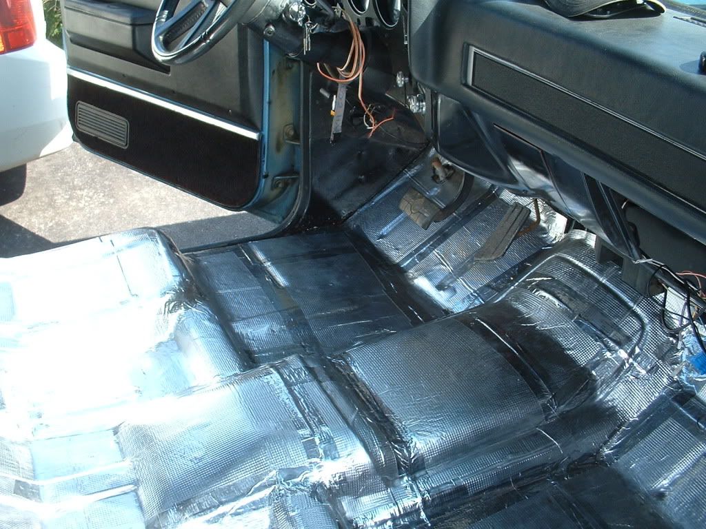

Offline Armor
  • Posts: 139
Re: dynamat?
« Reply #10 on: August 16, 2009, 05:23:17 pm »
i used b-quiet for my cab also, and i must say i really like it. The sound drop is fantastic, even with my louder exhaust, and with the windows up you barely hear outside. Windows down gives the pleasant sound from outside, so its not as droning as it used to get going down the road.
Mine came in the roll, but there is no smell at all(i think its almost all butyl rubber instead of asphalt) and i could not be more happy. also i was able to turn my radio down from 35 to 25ish as there was less noise in general to overcome.
heres a pic of complete(minus the back wall i did that afterwards)

Hey Armor, is B-quiet all gooey on one side, like dynamat? Or is it more of a foam?
Offline Armor
  • Posts: 139
Re: dynamat?
« Reply #12 on: August 17, 2009, 08:42:04 pm »
it VERY sticky, but it not runny or anything,  if it touches the surface it will stick well, but you can pick it up a bit if needed, but once its rolled down with a little roller, it doesnt come up at all. SIDE NOTE- gun wash will get it off panels, if like me your attempting to get factory buckets in after finishing the floor.
