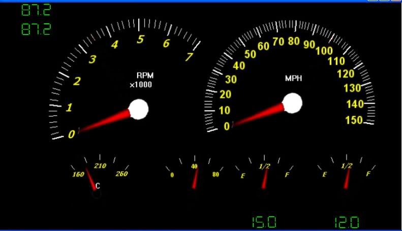

That is an idea. I might just do that. I have re-done the dash to take out all the gauges. So now the instrument cluster is flat with a 7 inch wide screen in the middle. So the wiper switch and heater controls are covered. The fan controls are now push buttons. And the heat/defrost controls will be ran by servos. Here is a picture of what the instrument cluster will look like. I have not put it in the truck yet but it works good on the bench.
The 2 numbers on the upper left are inside and outside temp.  The small gauges are water temp, oil pressure, left and right tanks. The bottom numbers are the gallons of gas in the tanks. And I used the 150mph so that 75 is almost straight up. I can't remember where I found the graphic for the instruments.
