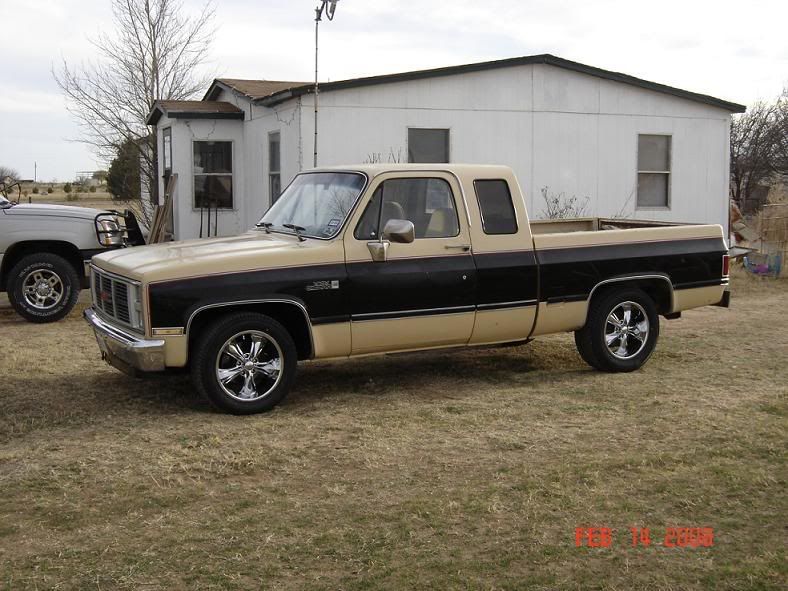

I have DJM upper and lowers on mine, and honestly i cant tell the difference to where the wheel sits.
Before (not the same shot, but as close as I have)
After
