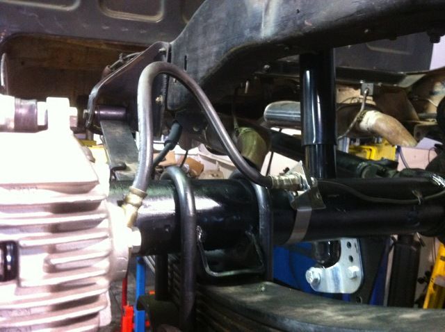

Got my steering box brace and got it installed....
Then decided the other side needed on as well so I copied their design on the other side. Triangles are strong......

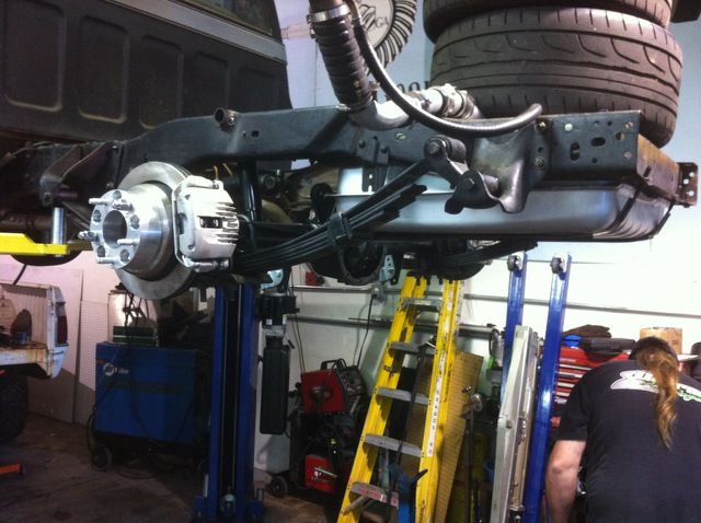

Dropped it off to my buddies shop to get rid of the heavy 14bff and get my 10 bolt built with an eaton posi and 3.73s. Also am getting a new shock mount setup welded in and the axle tubes welded up. Should be pretty buller proof when its done.
Mtrhd329
Posts: 133
Re: ***79 stepside 5.3l/4L60-E Swap***
Reply #114 on:
October 15, 2014, 05:01:42 pm »
Got tubes welded posi in and 3.73s installed. Now im missing the axle spacer kit that came in the posi box. Always something. Now when it gets here I can get some two leg action.
