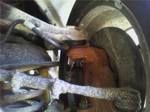

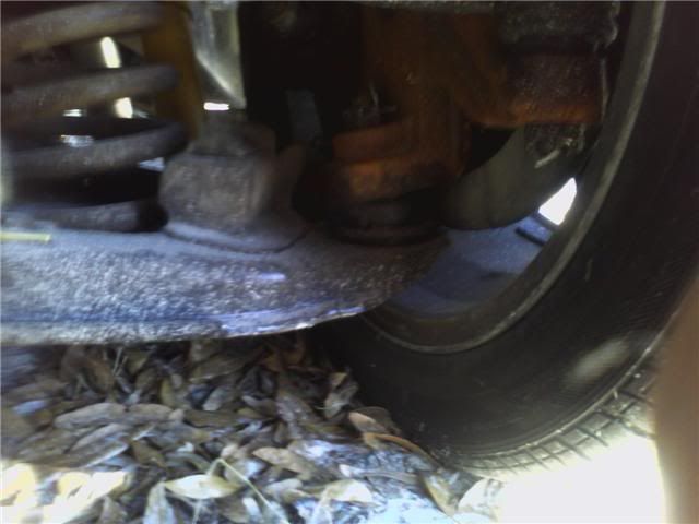

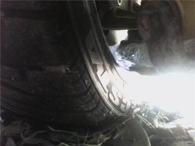

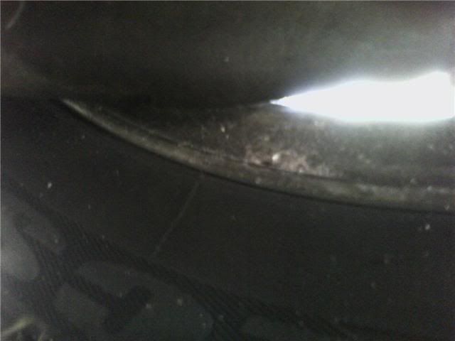

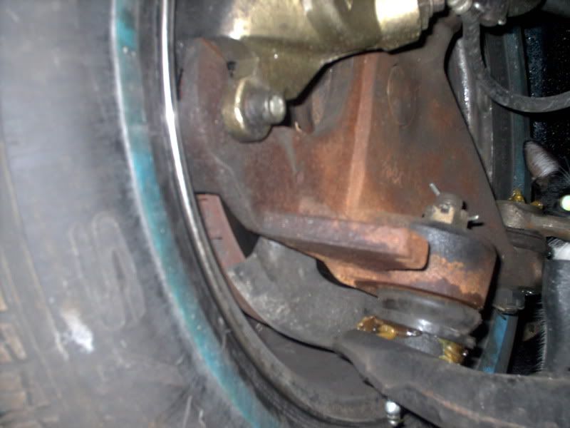

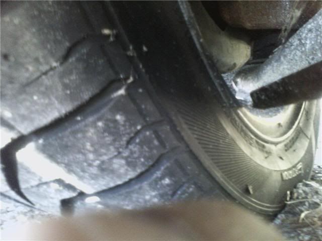

Yea, well here's the pics, Im not clearing 17's with clearanced arms, so I know I can't fit 15's......
I dunno how much these help? I'm just bout to give up on it, and throw some 22's on it and paint it, and drive it. haha

Except for picture number 1 which I can't tell.  It looks like you are clearing.  And based on the pictures you haven't removed "that" much metal from the control arm.  I have had to cut the whole ridge back on some with 15" wheels and reinforce them.
My truck that currently has the Impala SS wheels isn't lowered, but the truck they were on was lowered, but it used LCA's and springs.  They will fit with some trimming on ones with spindles though.
If you spin the wheel does it still rub now?  I didn't read back, but how much drop do you have and how??   Spindles = who and how much, Springs = ?
