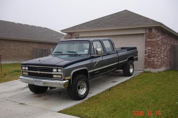

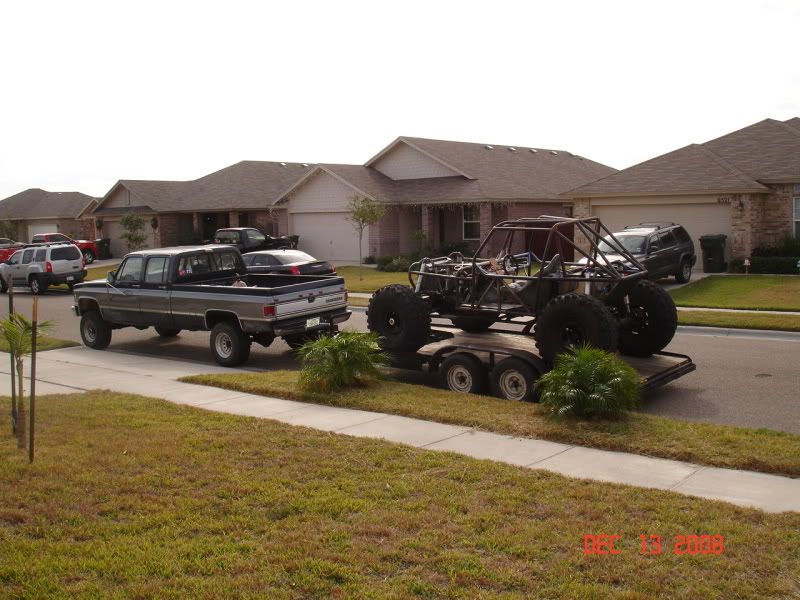

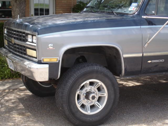

Been viewing this site for a while now, lots of great tech and interesting projects going on.  Thought i would drop in and introduce myself.  My name is Fred, i have a 1989 v3500 that i have  repowered with a 12 valve cummins and nv4500 5speed. I recently upgraded to h2 wheels and 315 allterrains.  I built it primarily to tow my rock buggy with.  I have been driving with the swap for about 2 and half years now, but of course i still have plans for it that i will probably be working on forever!  Otherwise, i am very happy with the way it has turned out so far.  Anyways, here are a few pics.(have better pics somewhere but i cant find them, will up date when i do)   Like i said, i have been on here for a  while and have gotten lots of great information, tech and ideas for my truck, so i though i would contribute my project as well.     -Fred

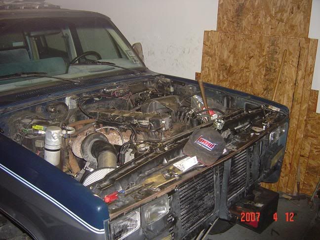

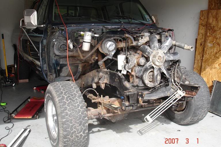

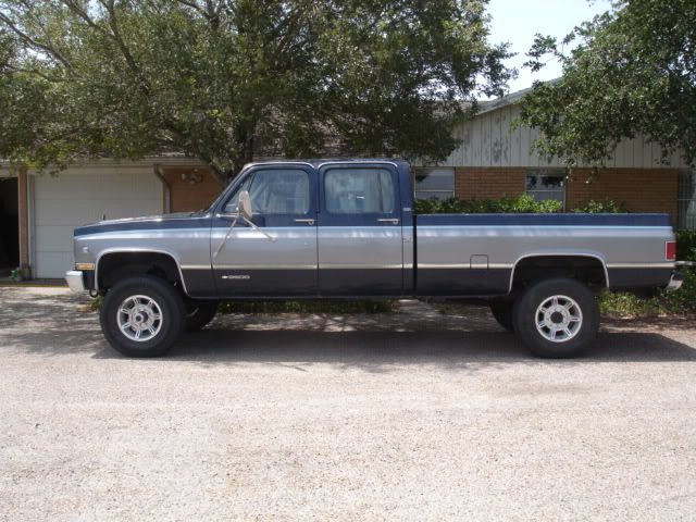

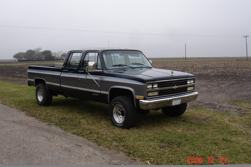

hears a few more from when i got it and a couple from the swap.    Thanks for all the welcome's      -Fred

sure no problem.  Main thing I can tell you if y'all haven't started yet, is to get the motor as close to the firewall as possable,  which might require you to dimple the firewall/tunnel to clear the top
two bellhousing bolts.  This will help with The main fitting issue which is the clearence btw the fan and the radiator
