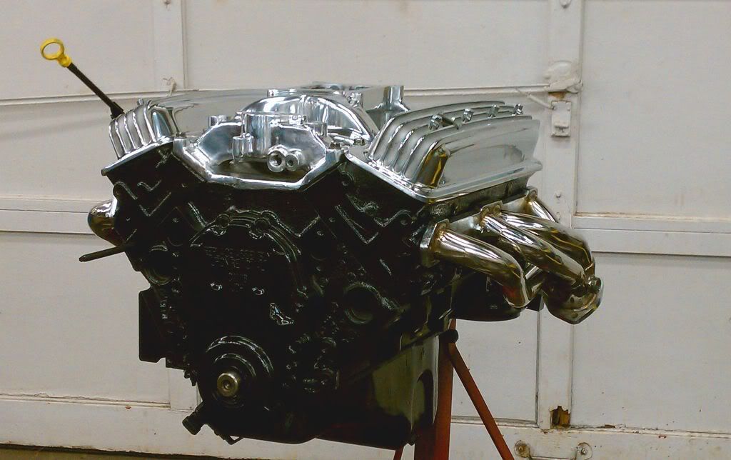

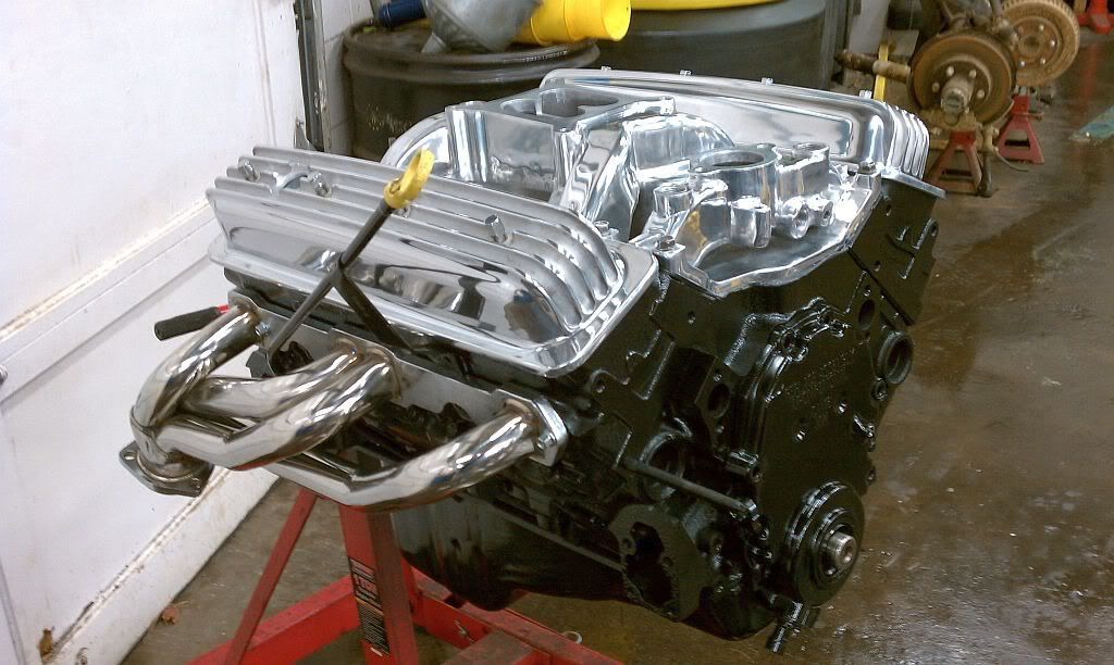

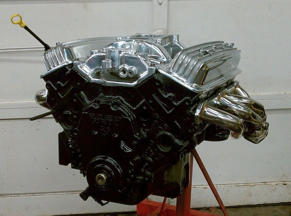

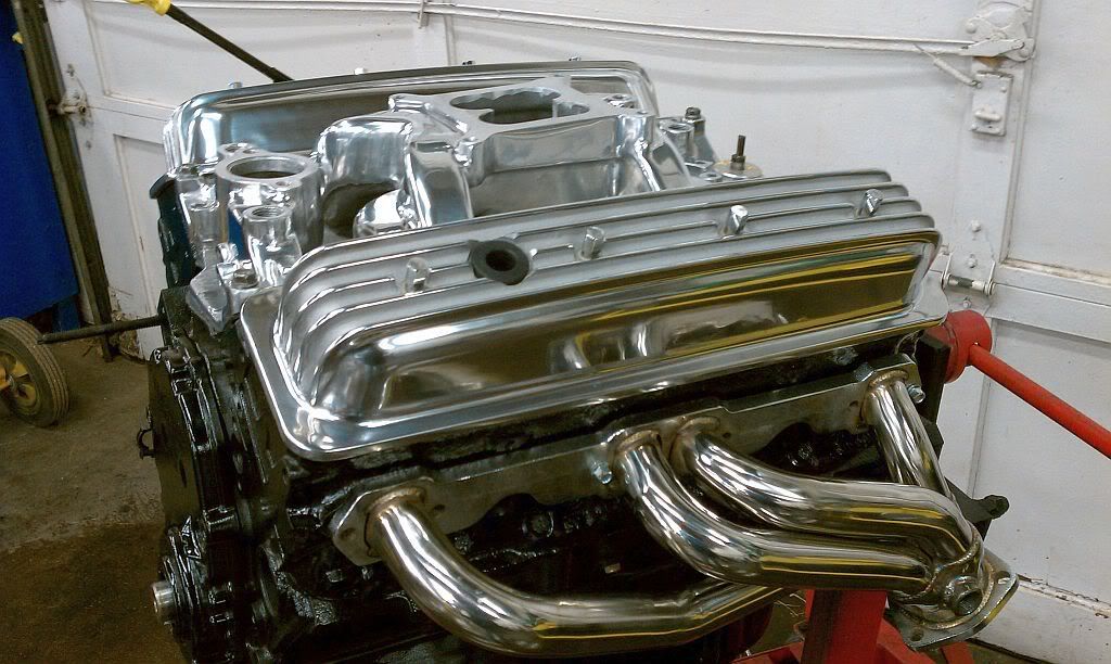

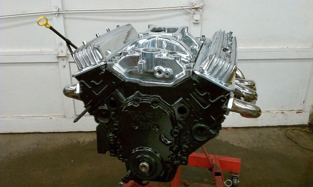

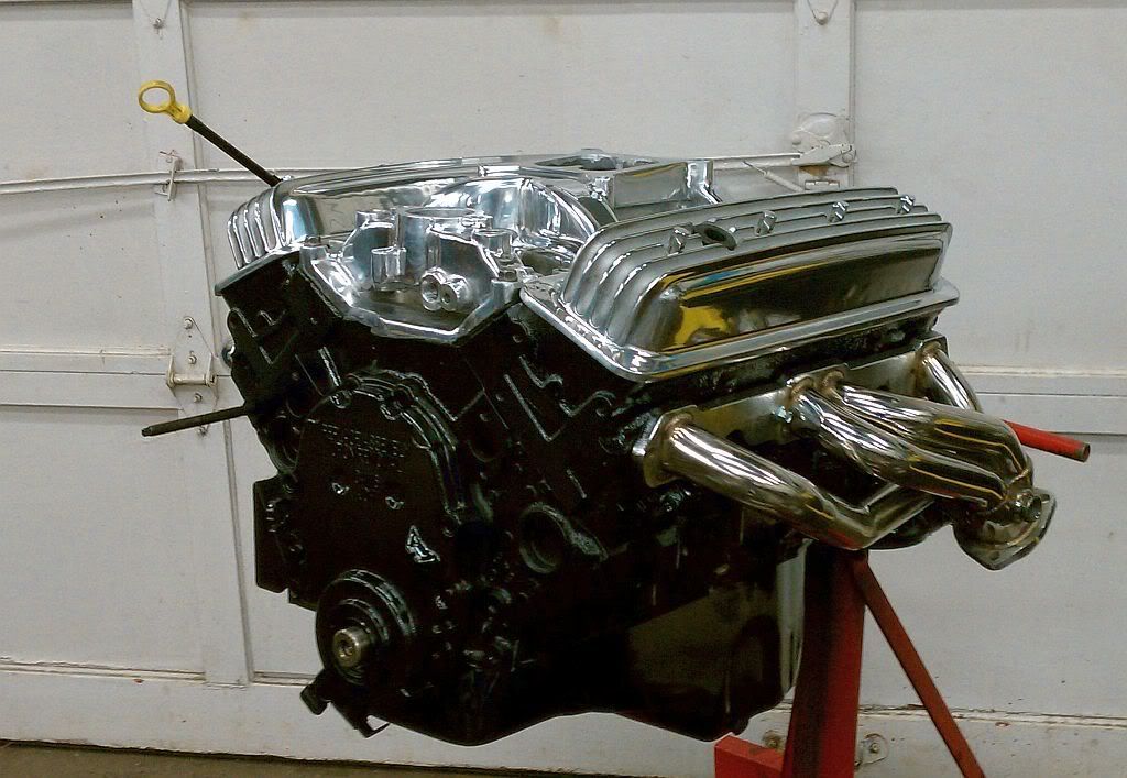

I painted the engine yesterday. Decided to go black with this one. I used Bill Hirsch engine paint and this stuff seems pretty durable. First time using it (actually second) but first time for myself. http://www.hirschauto.com/
I need to paint the waterpump and do a few odds and ends but it's essentially done. Here's some specs and pics
It's a 99 roller vortec .030" over, 4 bolt, new crank, resized powdered metal rods, forged flat tops, Howards roller cam HRS-180235 Duration 270/280, Lift .488/.495, Vortec heads, mild porting, 30° back cut on the valves standard interference angle face and seat, PP 52027 Intake, old school new style valve covers, shorty headers and MSD ignition.
I built a 700R4 and 208 T-case to take the place of the th400/205 that's in there. I'm going to swap the axles with the 3.42's I have to replace the 3.07's and there's a spool in the rear  ::)

Oooh, shiney.....lovin the valve covers

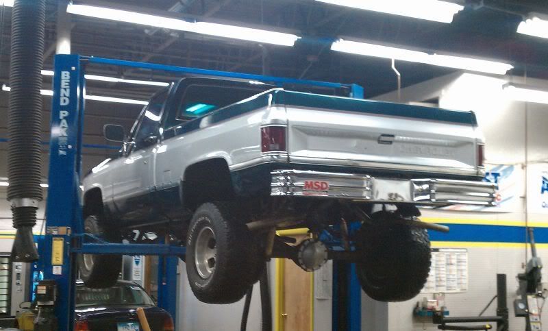

« Reply #58 on: January 12, 2012, 08:40:24 pm »
Update:
Axles are swapped out to 3.42:1 from 3:07, Drivetrain is all together, exhaust, fuel system, everything.... Well I just don't have the time to finish it. Seriously considering selling it as is and taking a beating. I got an offer for $3k which is stupid to take but in the interest of time I might just let it go.
