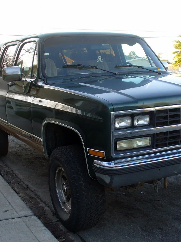

Here's a few pictures of my Cummins powered Suburban.  It pulls like crazy and best of all, I'm getting 26 mpg on the highway.
1990 ¾ ton 4x4 Chevy Suburban
-Gear Vendors Overdrive
-Upgraded Holset HX-35 turbo
-NP205 iron transfer case
-3.73 gears
-2" Lift
