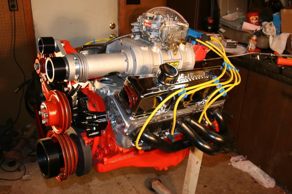

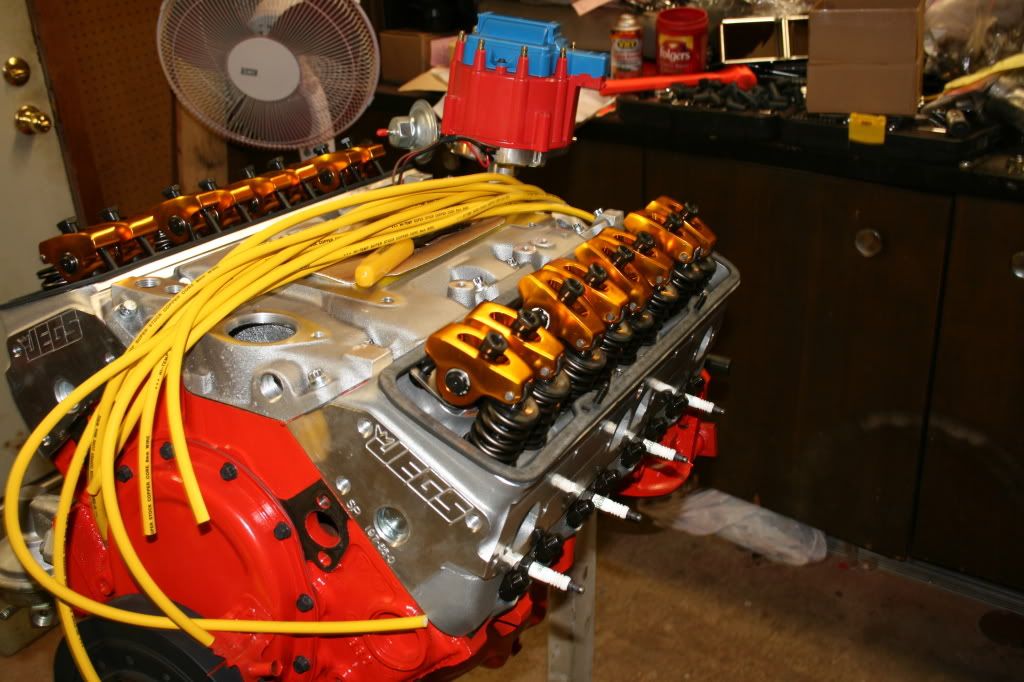

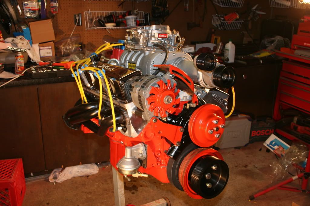

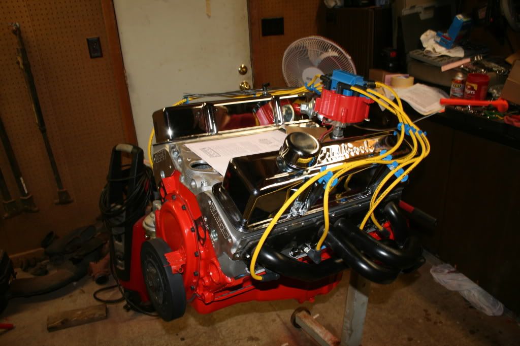

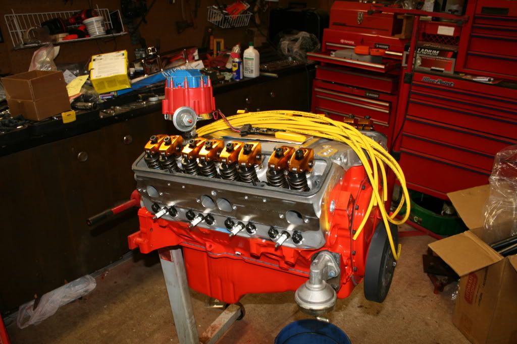

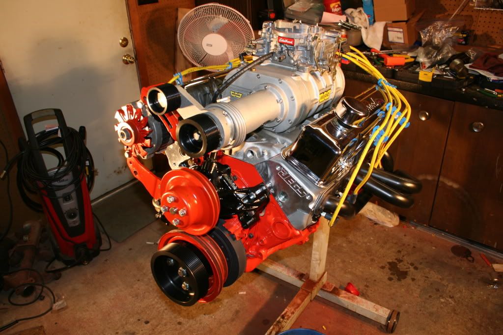

Just an update. I hope to get started on this in about 2 weeks or so. I have to finish up painting a couple sportbikes before i can really get started... I wanted to update a couple pics of the motor.  I am actually about to change a few things on the motor i have built for the truck and repaint it b/c i finally decieded on a paint scheme for the truck and the 07 R1 i am building to match the truck...
Here are some pics of the motor.

Engine looks great but I had a question about your harmonic balancer. Is that a stock one.  If  it is you may break it with that superchager.  You may need a steel one with a double key.  Also I think the crank would need cut for a second key.

lol oh know afterit idles you would know it was not a sleeper by any means lol.. It is a aftermarket balancer rated up to 1000hp and 10000RPM.
it has a radical cam like 246/256-517/525 @114 LSA best i can remember. And i hate to break it to you but i ma actually gonna paint all if it again. Heads and all.. I dont like the aluminium and i dont like chrome. May even disasemble blower and change color on it. not sure yet... All in good time... All in good time...
