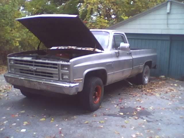

The pretty green "Abandoned" sticker was what first attracted me to her.  It was love at first sight. I bought it from a woman whose estranged boyfriend "borrowed" it, retarded the timing so it wouldn't start, and gave it a less-than-appealing new coat of rustoleum in silver and orange. He then parked it on the street somewhere (hence the sticker). She towed it home, and got disgusted. I saw her ad online and jumped on the deal for a mere $200.00  :o .
The "New Flowmaster dual exhaust" (as stated in the Craigslist ad) was not all it was cracked up to be.  The right side pipes were laying in the back of the truck...

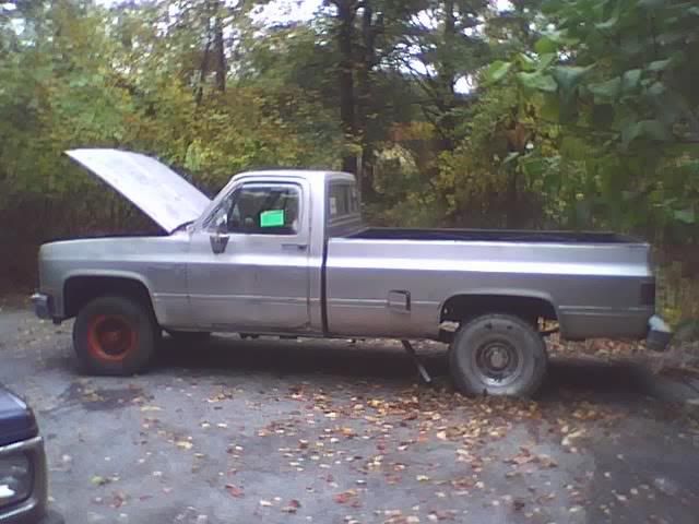

and the left side pipes were hanging on for dear life.  The rocket-scientist owners boyfriend must have used slip-joint pliers to tighten the clamps  ::) .  OH! and her front rally feet sported bald 235/75/15 sneakers, and the silver rear feet were wearing 33 x 11.50's ... good for the transfer case, huh?

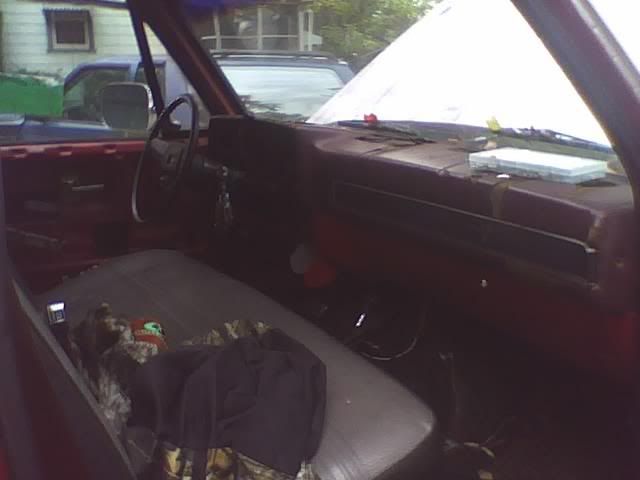

Oh man... This has got to be THE WORST dash I have EVER seen in a CK... the seat is gorgeous for a bench, but the rest of the interior is... well, shot.

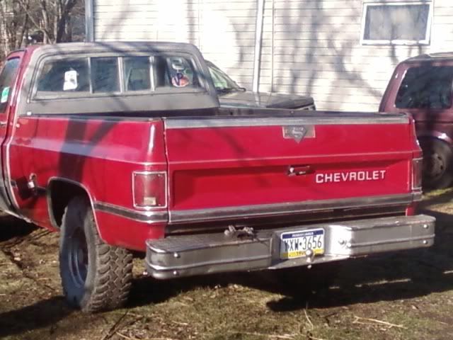

The bed is straight as an arrow.  The only flaws I can find are a broken fuel door hinge, and one small rot-spot on the right bedside, rear lower wheel arch.
Absolutely GORGEOUS original rust free gate, complete with superman emblem  ::) .

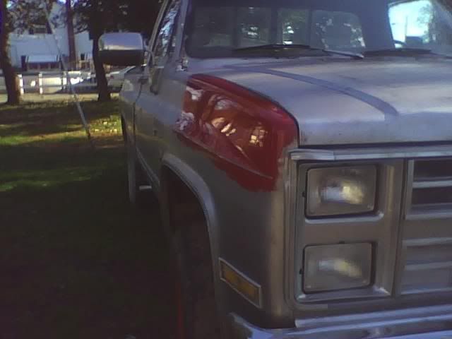

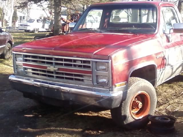

Decent black rally's under the hideous orange paint, but a rotted right-fender  :-\ .

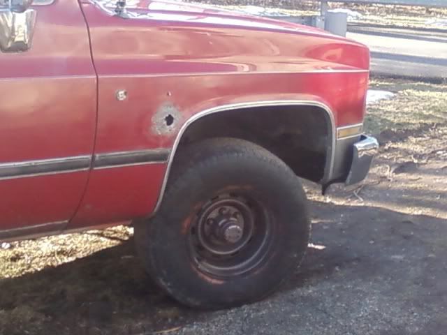

Even the grille is nice.  The Left fender is pitted like it was peppered with stones. Strangely, it is ONLY above the body line??? No where else.
If you give an idiot a can of spray paint, and something valuable... You will regret it.

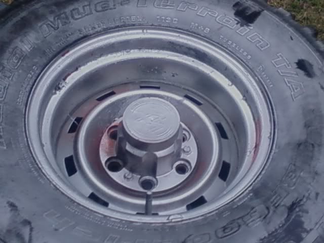

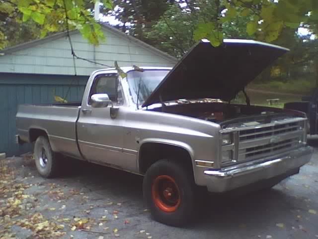

Ok... a VERY GOOD set of 4 BF Goodrich All-Terrain 235/75/15's, beauty rings and center caps, compliments of my '84 Silverado parts truck.  I sprayed the rally's flat black (should have been gloss).

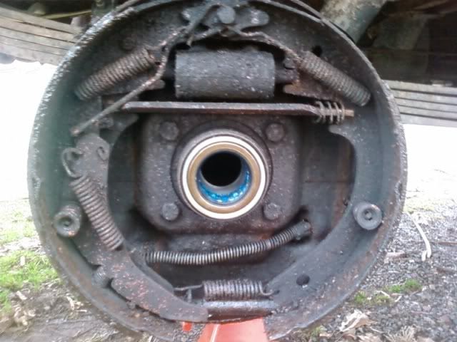

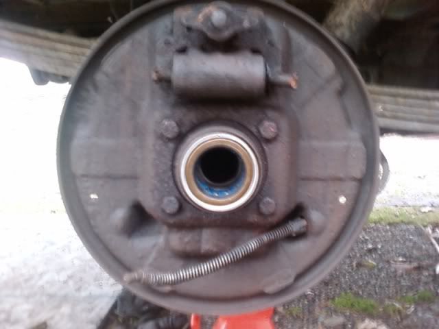

A bad wheel bearing and leaky seal discovered while checking her out for state inspection. So I installed new ones.
After trying to clean up the brake shoes, I noticed a bad wheel cylinder also  >:( . SOOOOO..... Off they came.
Then re-assembled with new shoes, hardware and wheel cylinders.

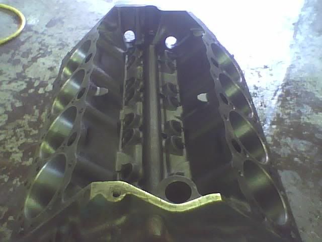

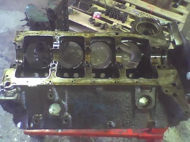

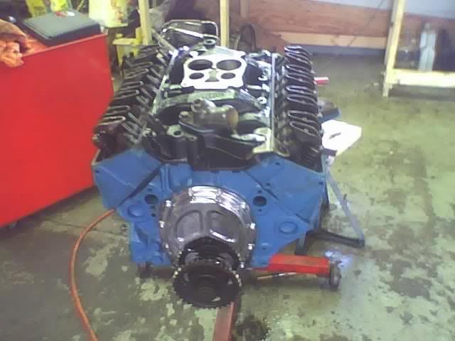

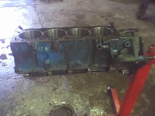

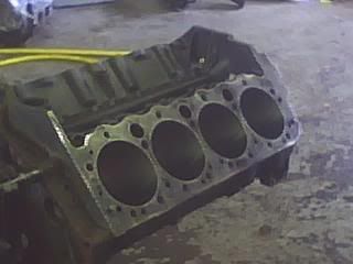

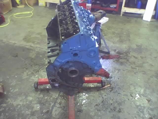

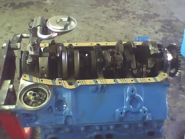

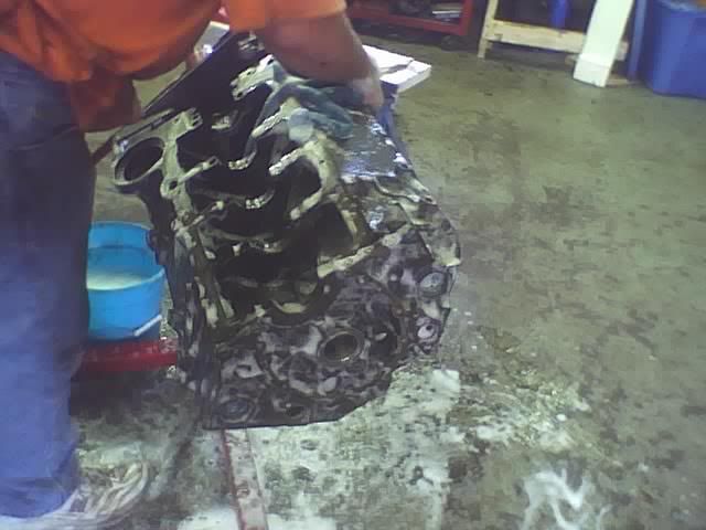

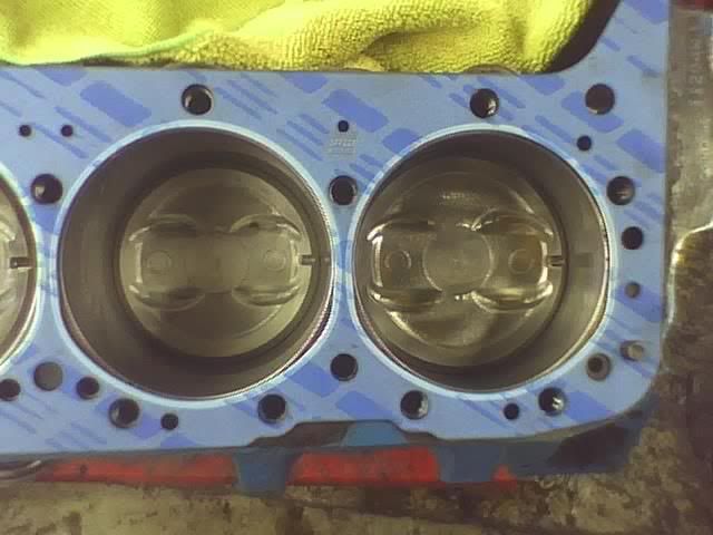

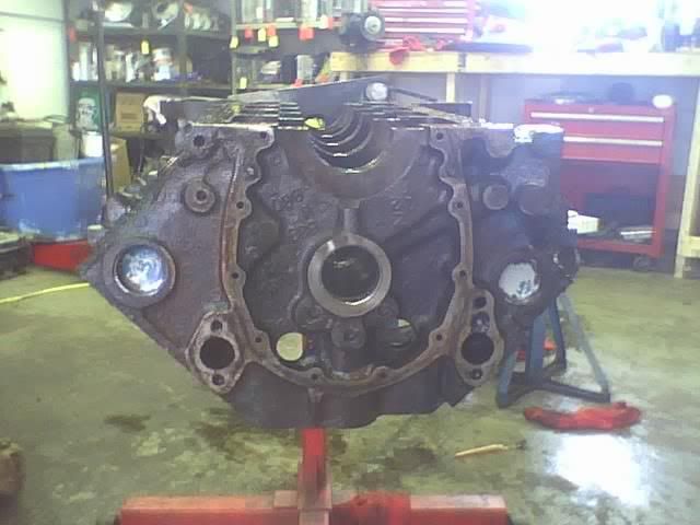

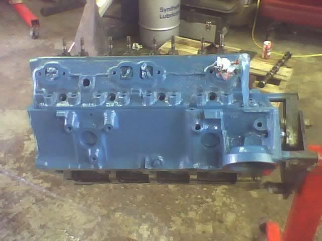

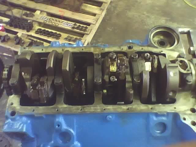

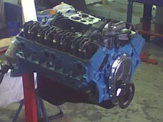

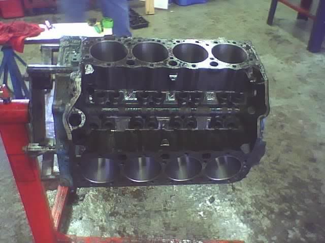

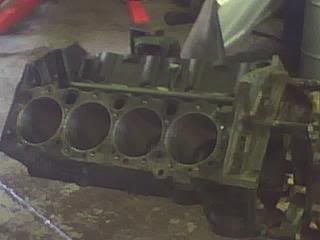

Rebulilt 327, bored .30 over (355), new everything except the stock aluminum 4bbl intake from an 86 Camaro, start to finish.
Our second argument.

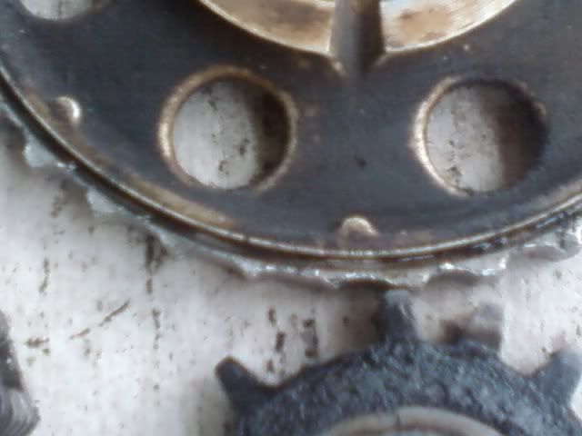

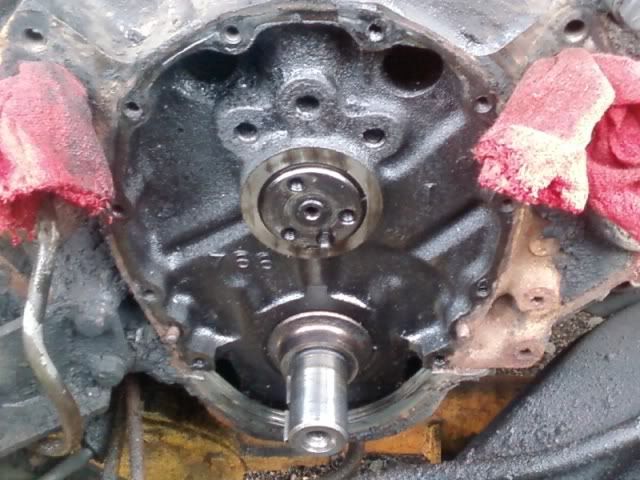

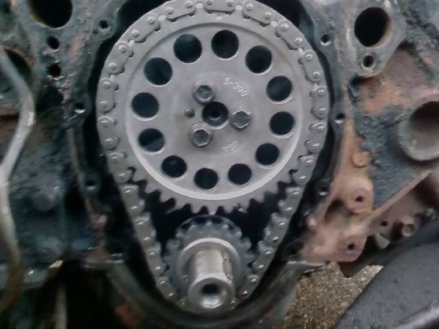

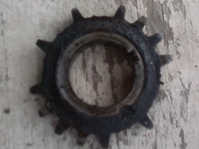

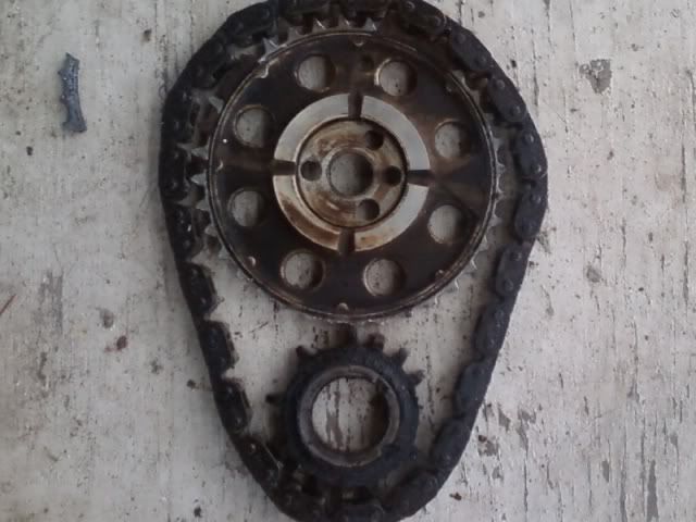

I have not had a chance to install the rebuild yet, so I am running the original 305 for now. On my way to work one day, she stalled on me, and would not re-start.  Sounded like a pretty serious timing issue.  Here's what I found:
YUCK!  These gears have not been out of here since Moby Dick was a minnow!
Cam gear...
Crank gear...
Surprisingly clean and damage free crank/keyway, ect...

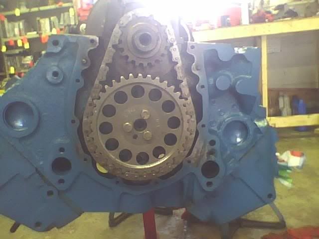

New timing set...

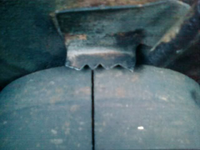

5 degrees BTDC...
Happy times.

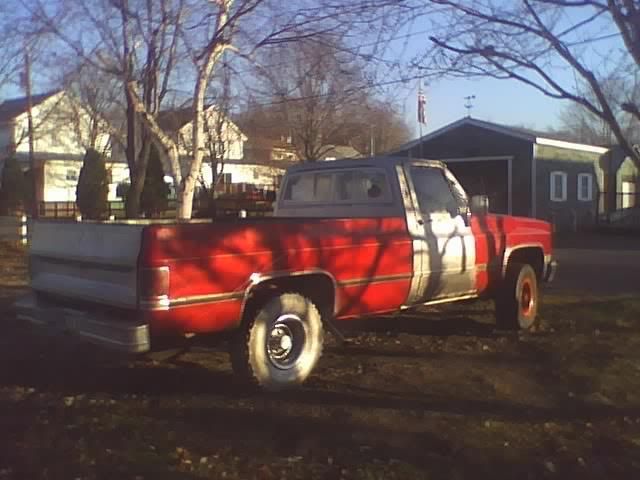

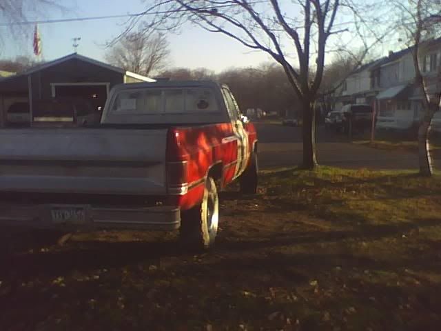

Cleaned up and posing in my yard.  She is far from completely healthy, but getting there one step at a time!
