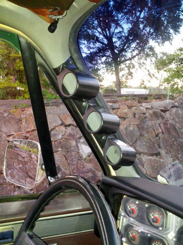

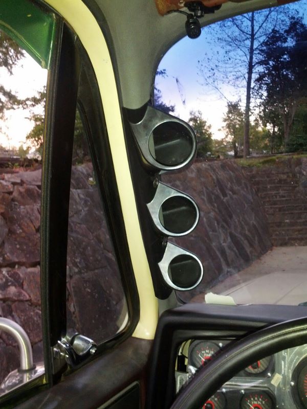

« Reply #264 on: October 21, 2014, 10:07:56 pm »
As of this weekend this is the Triples mounted in the truck.  There are 2 injection points on the part that serve really well for a screw location, I also opted to put the 3rd screw at the top inside edge.  These are #8 Trim screws.  I am looking for source bulk in the correct length, but for now I just trimmed them to fit.  I highly recommend using screws to secure these.  I made them to fit all models but it was a compromise for the 73-80 style as it has slightly more tension on it, these will require screws.
Pictures is the pod mounted on a 81-87 a-pillar.  This coming weekend it will be painted Red to match the interior color change of my truck and I plan to texture it also.  Right now we are working out the minimum order and pricing, once that is out of the way it should be a matter of weeks before they are available.
As always feedback is welcomed.

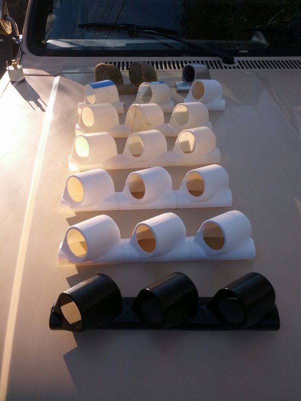

This is almost all of the iterations of these (missing at least 2)
View from the front:
View from the Side:

« Reply #265 on: October 21, 2014, 10:23:14 pm »
They look great!  Perfect angles for viewing!  Can you image the windshield side of the pods?
...This coming weekend ... I plan to texture it....
I didn't quite grasp your meaning.  Will the finished product have a stippled texture to match the OE trim, or will it be up to the installer to texture it?
