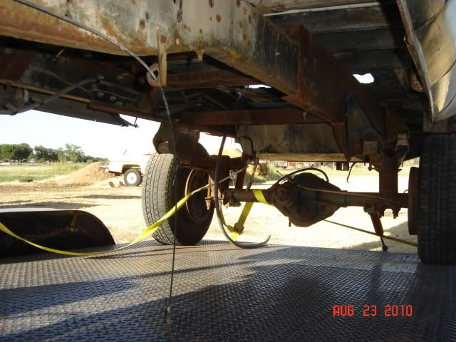

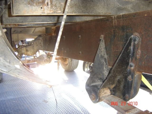

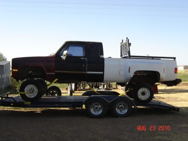

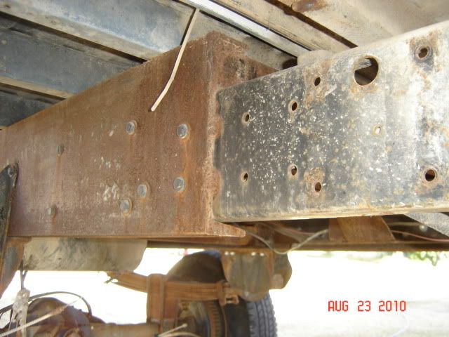

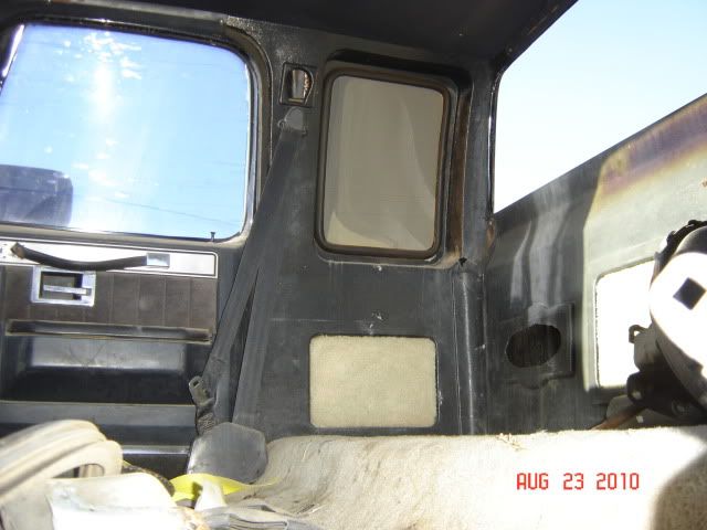

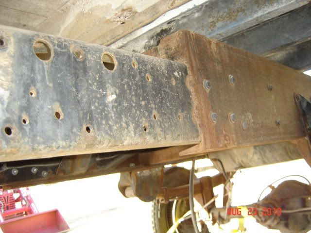

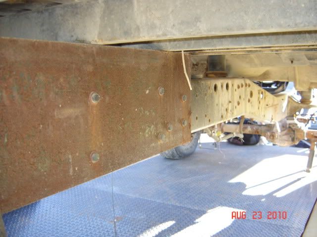

Ok, here are a few more pics that I promised so you can see more of what Im working with
Heres the frame mods they did for the long bed. I dont think its going anywhere, but it cant be lowered much more because the blazer tank sits over the rear axle. They had to install a 3 inch body lift to make the bed and cab match, not sure I like that alot, but it doesnt bother me to much.
I am going to go the dually route, and either 19.5s or 22.5s. Im not a big fan of th 24s

These trucks are built on a longbed frame, so in order to put a shortbed on it, youd still have to cut 4-5 inches off the front of the bed to make it fit, and then of course the rear frame rails. Youd have to either cut a crewcab frame down, or stretch the longbed frame. I will start doing a better job of posting the ones I find here, but there are a few guys that do an awesome job of helping me do that here, and it is appreciated.
