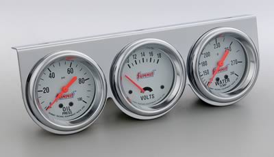

you can put the after market gauges in it
like this might find one cheaper
http://www.summitracing.com/parts/SUM-G2973-V/

no................. i mean how.  i will buy a good guage. i just need to know if its easy as pie, or super trouble.   is it a one wire clip. or all new motor hookups?  things like that.    exactly how is the question.....

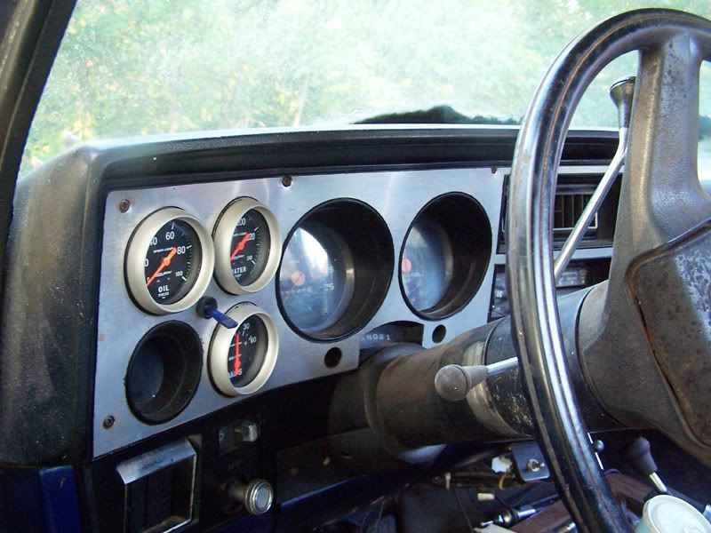

You will need to add the proper probes, yes. Not overly hard, but not the easiest install. You need to run the wires/sensor leads, and mount the gauges. Wiring the lights can be done a couple ways. Splicing directly into the wire going to your factory gauges, or doing like below. Sensor leads are run through the fire wall. If it is a mechanical gauge (Which are more accurate) you have to be careful not to kink the lead (The manual for the gauge will explain). A simple drilled hole, and grommet is the easiest way to get through the firewall. Mounting the gauges is up to you. Replace the factory like below, add pods, or get one of the cheesy brackets like Alley linked.
Just google "water temperature gauge install Chevrolet." That will tell you where you can mount the probe. Same can be done for oil pressure, and voltage should be pretty self explanatory.
Here is my Dad's old install if you need some inspiration.
http://i13.photobucket.com/albums/a269/Mrjunior/Truck%20Project/100_5698.jpg
http://i13.photobucket.com/albums/a269/Mrjunior/Truck%20Project/100_6004.jpg
http://i13.photobucket.com/albums/a269/Mrjunior/Truck%20Project/100_6005.jpg
