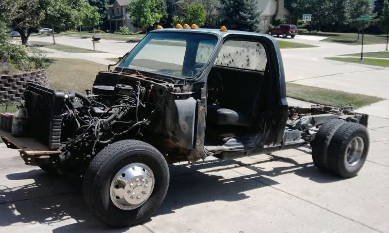

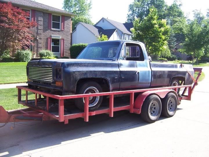

This is my "78" chassis cab project, I had a 78 body sittin in my garage all summer and it had too little rust to send to the scrap yard and one day i came across a 86 C30 flatbed with a 350 and turbo 400 trans that i ended up only payin $400 bucks for, the cab was completely shot so this was a perfect platform to start with, basically my plans with the truck are after the body work and interior are done id like to swap a 12v cummins in it, but first things first im at the point of deciding what color to paint it lol
The 78 rolling chassis i started with

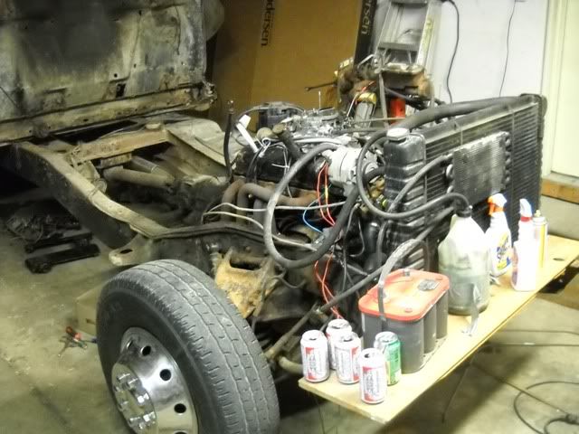

The 86 donar truck
Backing it into the garage to tear it apart
I had to take it for a quick spin around the sub

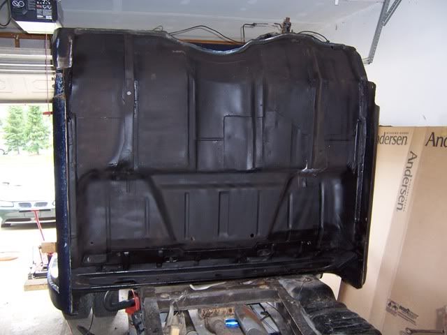

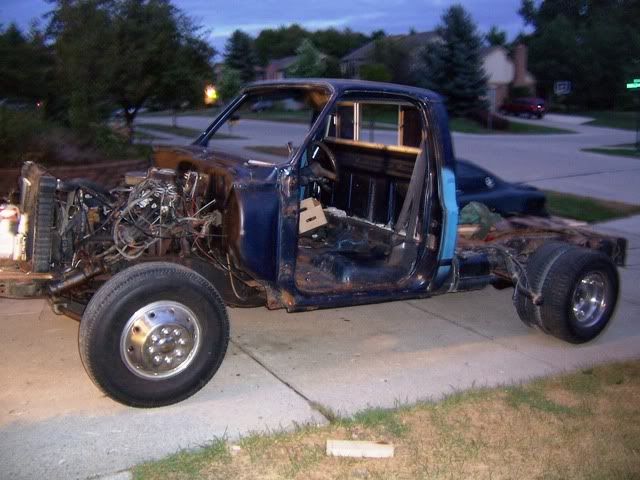

Old cab coming off
78 cab on and painted before dropping it down

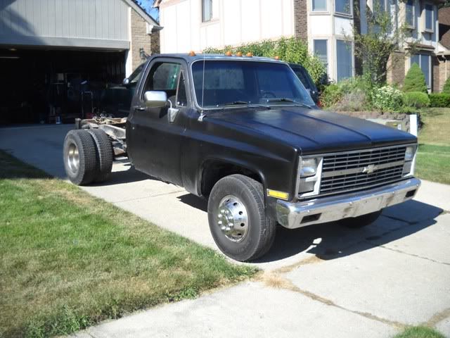

First look with the new cab
Test fitting to get a general idea of how it will look
The only thing i have to modifly is i gota add about a 3 inch strip of sheet metal to close the gap between the bed and cab, i guess the chassis cab trucks were a little longer, and im gona have to do a mini tub on the rear wheel wells to fit the duallys, unless i decide to put a small lift on it and go 4wd, but i gota see what my bank account will allow,

There is no difference between a 1/2T pickup SRW and a 1T cab/chassis DWR, all regular cab long bed pickups have the same dimensions and wheelbase.
If it isn't close enough (and it isn't based on the pics) you have something mounted incorrectly.

The cab and core support are mounted in the factory locations and everything fit fine there, but it is hard to see in the pics (ill have to take a side shot) but to have the center of the wheel well centered with the rear wheels there is about a 3-4 inch gap between the cab and bed

hmmm cut the frame that much shorter?
Re: 78/86 Chassis Cab dually thing
« Reply #8 on: September 19, 2010, 12:00:08 pm »
Neither the front or rear tires are actually centered on these.  Was the bed actually bolted down in that picture?

Wow I see what you are saying, yea looks like you need that frame shortened up about at the front of the door(underneath), or front of your bed(underneath) It'd move the front wheels backwards and the rear ones forward. That truck could really look nice.
i think its just the angle of the picture but the front wheels are centered in the wheel well, but no i dont have the bed bolted down yet
