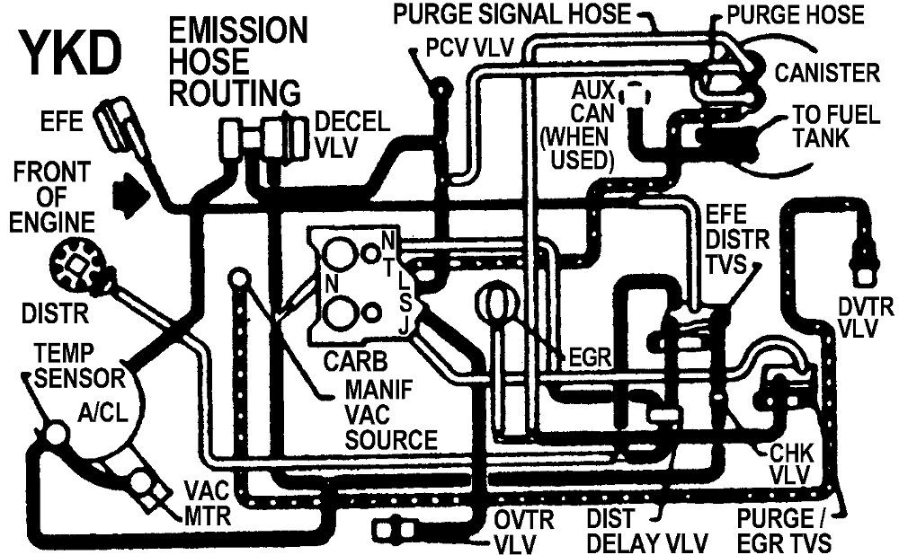

Much appreciated! I was able to find this vacuum diagram on autozone.com.
It's pretty much the same as what's on my air cleaner. One problem is that the four-port thermo-switch on the air cleaner does not appear on the diagram. Another is that I ran a vacuum line straight from the ported vacuum source on the carb to the vac advance on the distributor. Looking at the diagram however, I see that that circuit is much more interesting than what I've done. I'm probably over-thinking this. I do that a lot. I'll hit it fresh tomorrow and post up pics of specific issues.

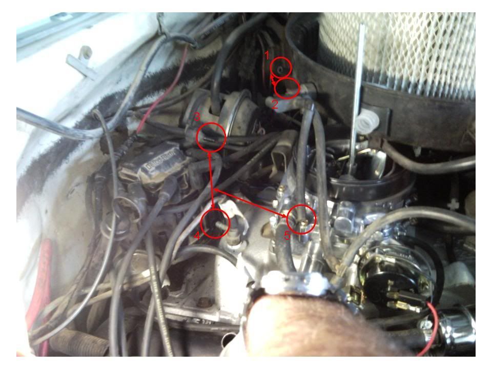

Well, I made my best guess today. I have a couple questions below, but I was able to fire it up and it ran. Just needs some tuning and I should be good to go.
Question #1. According to the vacuum diagram above, the vacuum source for the vacuum advance comes from port N on the carb. I assume that's a ported vacuum source, but can someone confirm that? I'm questioning it because it looks like the ported vacuum switch (on the thermostat housing) is also involved in the circuit and I don't know what its role is.
Question #2 is the pic below. If it doesn't make sense, then just ignore it. I'm pretty confident it's right. Anyway, the red circles are the connections that puzzled me and the arrows are how I hooked them up. Number 1 goes to the inner sensor on the air cleaner. Number 3 I think goes to the vents inside. Number 4 is obviously the manifold vacuum source.
Thanks!
