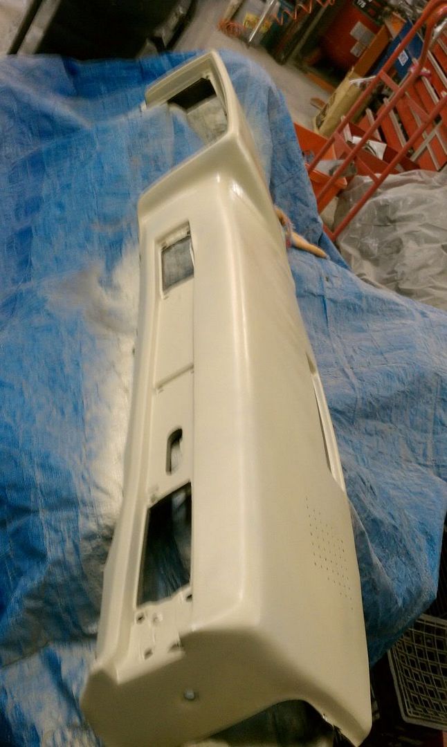

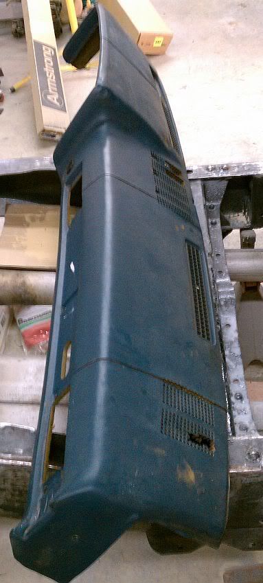

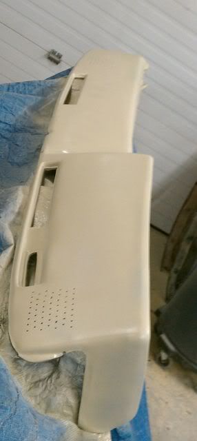

I'll post pix of the one I just fixed...
Re: Any Ways To Fix Cracked Dash?
« Reply #18 on: January 02, 2011, 09:20:15 pm »
I took a beat up dash pad I had and in between watching paint dry I decided to see how it would turn out if I actually tried to fix it. I ground down all of the areas around the cracks and filled them with seam sealer. Later I wiped the whole dash with laquer thinner and put some body filler over the rough areas. I primed it and it looked pretty good. I decided since I don't really care about it to try making a stronger texture. I shot it with spatter paint and plan to DA the whole thing. Then I'll paint it and see how it looks/holds up.

What did you fill the speaker holes/areas with?

I pulled out all of the foam under the speaker holes and put duct tape over the top. I filled it with foam and then used body filler over the top. I used the coverlay I had laying around as a template to redrill the holes. I'll finish it up tonight and see how it looks.
