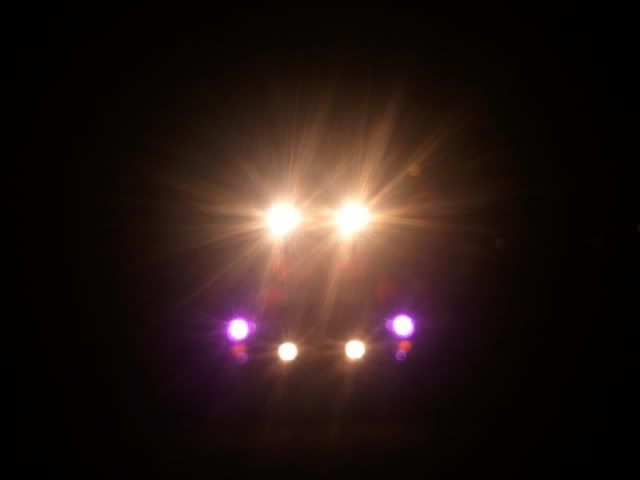

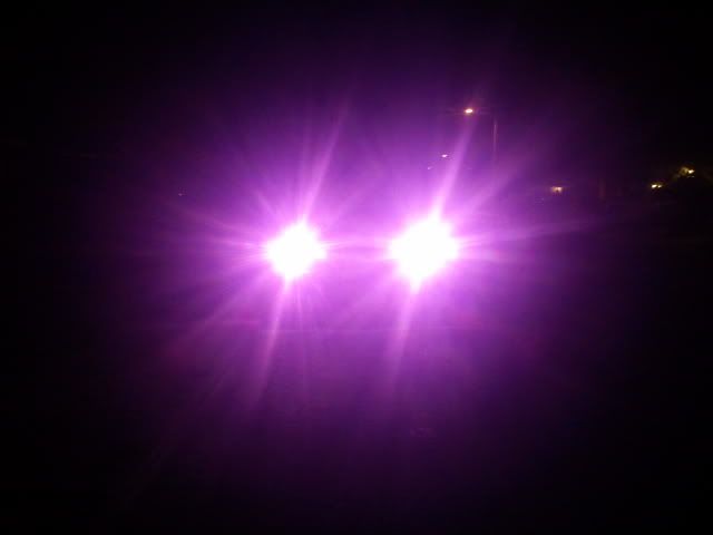

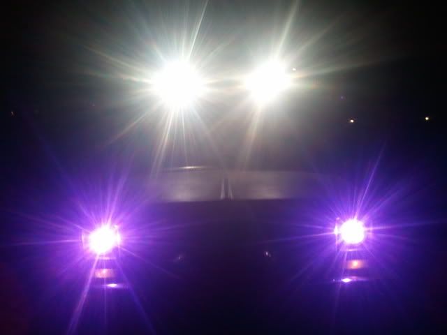

After sone researching, you are quite correct. It is not a true projector. But, it does project the ligt
ht in mostly a flat line. It is not an ellipsoidal projector, like I want. The lense in the front really doesnt do much of anything, but im looking into retrofitting OEM projectors from a lexus or something into my housings! Also, I got my hids installed, and will get pictures up soon. Heres a teaser with all of my lights.
Re: Projector headlight conversion
« Reply #18 on: March 21, 2011, 11:23:37 am »
Spaceship...

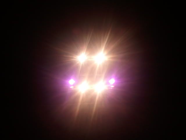

Haha. Yeah, if you look at it from a distance, its a big smiley face. I'm going to turn my KC lights into Angry Eyes by black taping the inside upper corners so they slant in a little.
Kinda like this, but not as crappy.

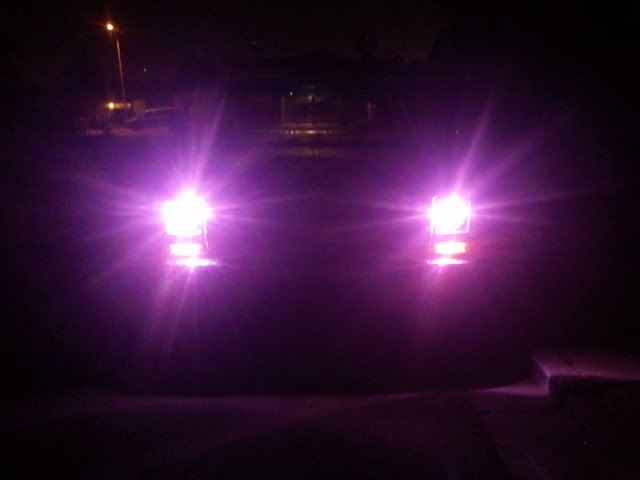

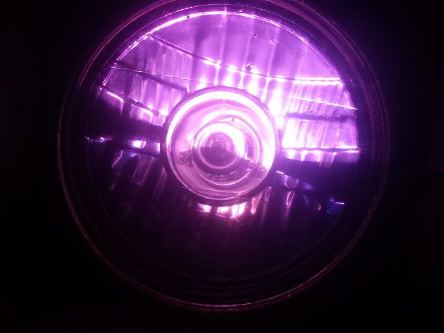

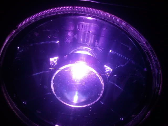

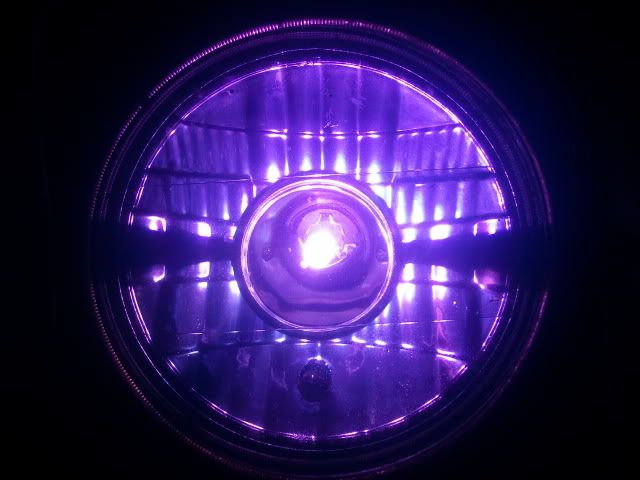

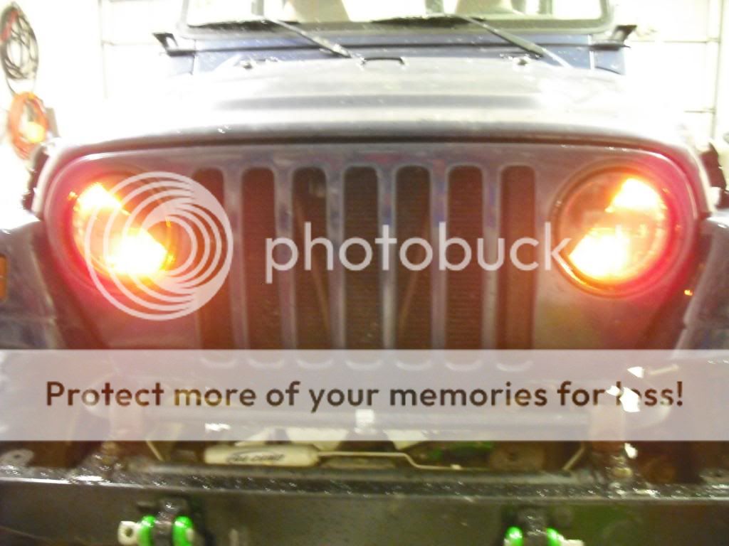

Okay, I couldnt get pictures of the actual installation because my friend was hounding me to put the camera down and just install them. But I will go out and take some pictures of how everything was installed in a couple of days. For now I have some comparison pictures. And a couple of random pictures of my variety of lights. now, My HID bulbs came with a metal shroud on them, it directed all of the light upwards. I removed that shroud, and I have before and after of with and without shroud. The no shroud pics look a bit bluer because they werent quite warmed up yet.
Head on with shroud
Head on no shroud
Above with shroud
Above no shroud
Head on close with shroud
Head on close no shroud

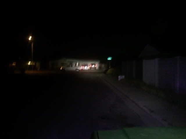

The High and low beams dont look different head on, Because They DO NOT get brighter, They move foreward and backward, which changes where the light projects. So when you hit the highs, the light just projects Up more.
Low beam in cab
Low beam head on
High beam in cab
High beam head on

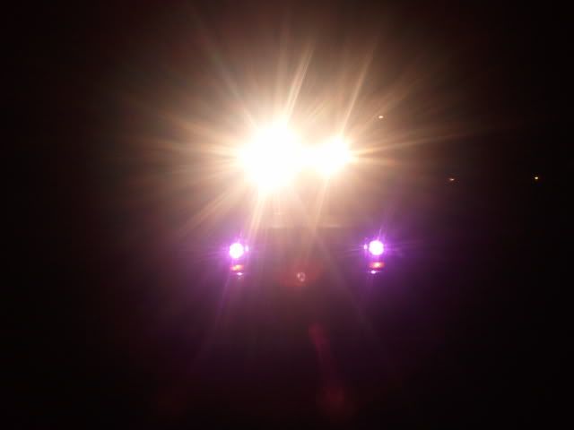

Headlights on ground
Headlights with 100w fogs on ground
Headlights with fogs far
Headlights with fogs close
Headlights with 120w KC's on ground
Headlights with KC's far
Headlights with KC's close
Headlights with 120w KC's and 100w Fogs on ground
Headlights with KC's and Fogs far
Headlights with KC's and Fogs close
I made my KC's have "Angry Eyes"
You cant tell in the pics, but you can tell in person, Angry eyes far
Angry eyes Close

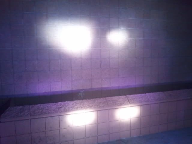

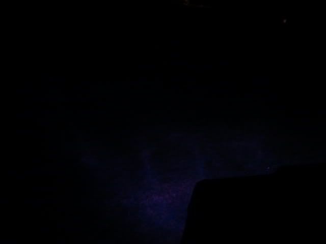

Low beams on wall
High beams on wall, you can see how the light just moves UP
High beams, KC's and Fogs on wall, IDK why my driver KC is all sloppy like that
Thats All I have for now, I hope you like the Purple! I certainly do. Ill get pics of the install in a few days. I have to move my battery to show most of the wiring.
