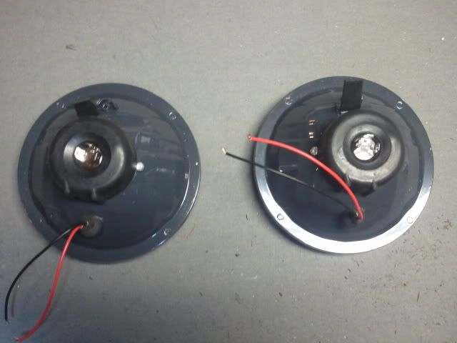

The conversions....
The install...
First, remove your headlight bezel and original bulb
I went ahead and replaced the plastic grommets for the adjustment screws
Re-mount the headlight bucket
Put the ring around the conversion light
And install into bucket just like a standard replacement
Install the wires just like normal, I had to remove them from the plastic clip, because it was contoured to the shape of a sealed beam.
And if you want, hook these wires into your parking light circuit or to a separate switch, I left mine unhooked for now.
Re install your bezel and adjust, and Enjoy. Here are some after photos. I got the black housing, because it is a projector housing and it DOES NOT rely on reflection. The projector lens in the middle magnifies the light into a flat beam onto the road, and the housing kind of reflects light, but it mostly relies on the lens. The bulbs they sent me were very dim, as they had a blue film around them. So I replaced them with a 15$ set of Sylvania H4 bulbs(the bulb type the housing accepts) and it is like 5 times as bright. Yet, the projector design is intended for use with HID lights. So, standard halogen do them zero justice. I am ordering an HID kit in the next week or so, as I hate having dim lights. ONE of my 65w 20$ pair of fog/driving lights is brighter than my High beams. )= So, I ordered HIDs and I put 100w bulbs in my fog lights to help get me by.
