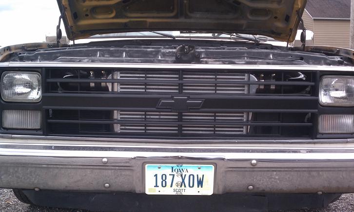

Well with a little more work and some luck she should fire up tomorrow. Where we are so far-
2004 5.3 90k miles
60# injectors
Walbro 255 lph fuel pump
Master Power T70 .68 A/R exhaust housing turbocharger
TiAL Q Blow Off Valve
TiAL MV-S Wastegate
KB Racing log manifold
Custom down pipe and cold side with intercooler
Swapped to 2 bar map sensor and screw in type IAT
New 87 fuel tank and sender
New Fragola Push Lock Fuel Line
New Dual Pass Radiator
Custom Modified C4 Corvette dual fan setup
External trans cooler we had laying around
Belltech 3500 spindles
Western Chassis - doesnt quite fit right flip-kit
Rear Disc conversion courtesy of Virginia 4x4 and Advance Auto

« Reply #86 on: June 21, 2011, 11:11:04 pm »
Its not too bad, should be able to get up around 500 at the wheels how it is, that'll have my fuel pump just about maxed. Got a few loose ends to tie up, wanna do the interior, probably a rebuild on the tranny this winter, see how the whole setup works with the 4.10's. Etc.
