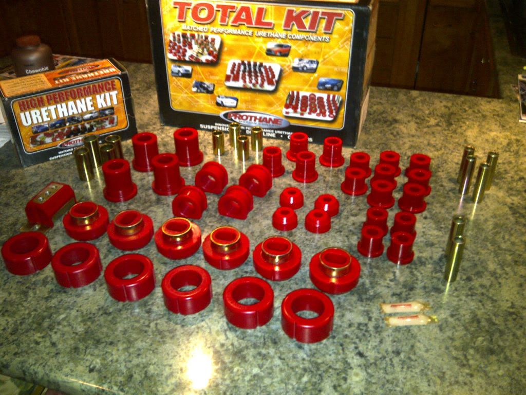

so i got the bushings tonight, and i have all the old ones out, only 1 shell was a little bent up but fixable. now im going to start on sandblasting everything and getting them painted, ill keep you updated with pictures and everything. im really glad the new kit came with all the body mount bushings, does anyone know of a good source for a bolt kit with body bolts and leaf spring bolts or anything?  thanks   -kyle
