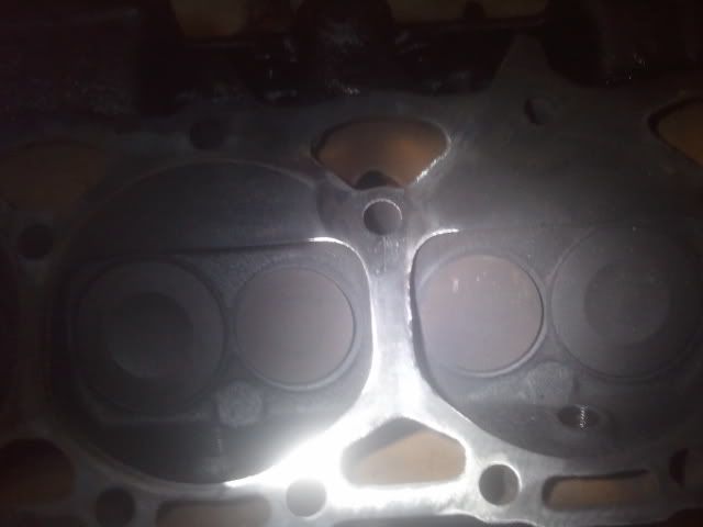

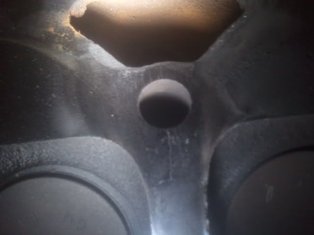

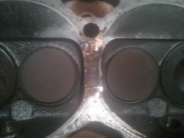

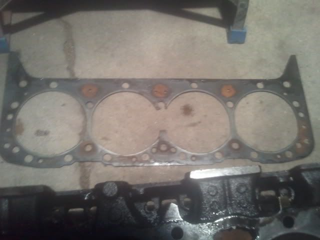

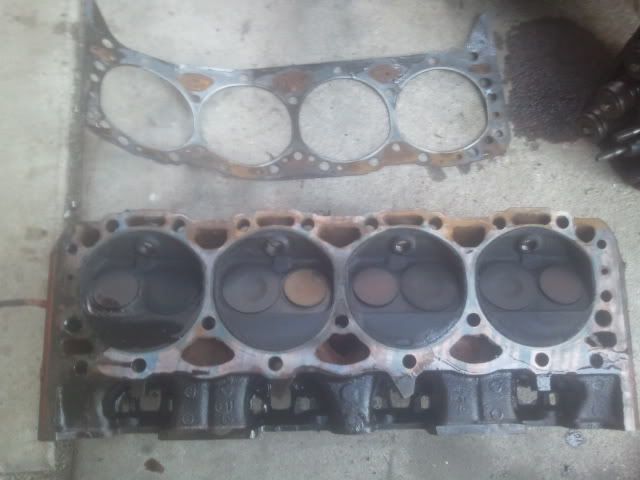

Aaaaaaaarighty then. I jumped on into my engine bay tonight. Pulled my powersteering pump off, valve cover, and all the head bolts. popped the head off and flipped it over. The gasket was in fact blown.
So I grabbed a peanut grinder with an abrasive pad and started cleaning up the head to put the new gasket on. And where the gasket was blown, I found this.

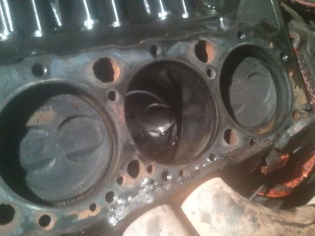

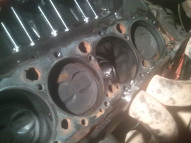

The block doesnt look too bad. The number 5 piston is SHINY!!! I guess it was burning a very small amount of water. Theres a small amount of surface rust where the gasket was missing.
Better look at the piston, kinda.

That one blew real good! Keep the pics a comin man!
Grim 82
Posts: 1651
Re: Hopefully not a cracked block....
Reply #19 on:
June 04, 2011, 02:47:32 pm »

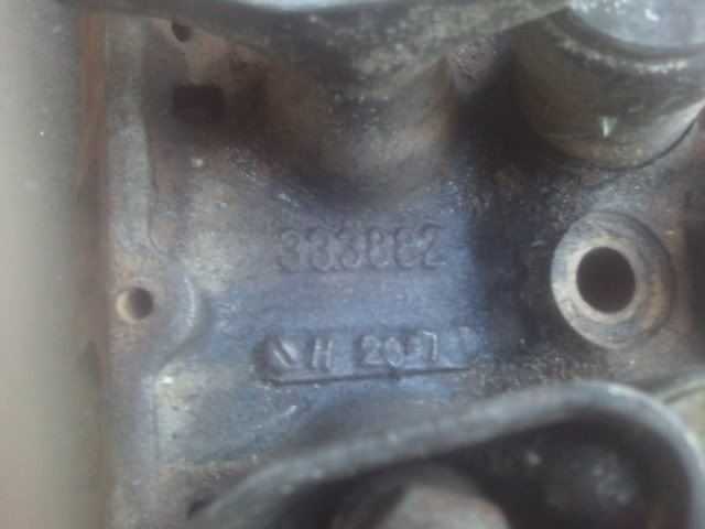

I think you found the problem. What casting are those heads?

June 04, 2011, 03:00:28 pm »
Ill check the casting as soon as i get home for ya, grim. Theyre the stock 79 350 heads.

Snapped a pic of the numbers real quick.

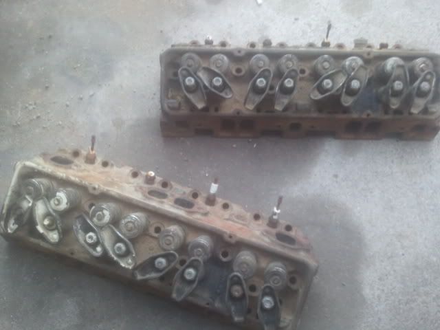

Okay, my dad picked up a set of stock 350 heads from a friend of ours for free basically. I just have to buy him a 45 dollar soft top for his CJ-7. Now, these heads are ugly. The spark plugs are kinda rusted in from sitting, covered in paint, and just gross. Im going to take them to the machine shop and have then crack checked and gone through, but should i take them my heads and use the parts from my heads on the new ones? Springs, valves etc? My heads were just gone through a year ago so i know the parts are good. Should i have them use the best parts from both sets? What do you guys think?

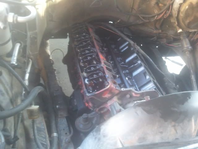

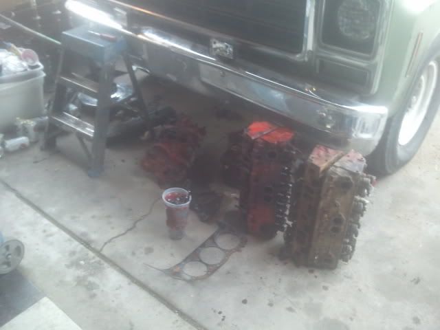

Popped the other head off. I talked to my dad and he said it would make sense to take both pairs of heads to the machine shop and have them use the best parts to make two heads.
Pulled the other valve cover, nothing out of the ordinary.
Rocker arms and pushrods off.

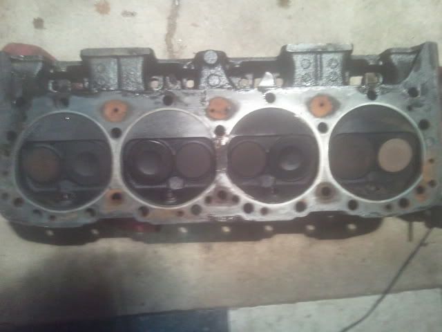

All of the head bolts and the head off. I took a dead blow hammer and smacked it under the intake ports at the front and back of the engine to break her lose then wiggled her off.

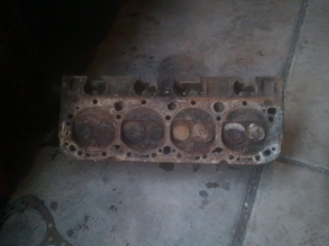

Nothing wrong with the Head gasket and nothing wrong with the head(as far as I can tell).
On the number 7 and 8 pistons, the head bolt in the middle end corners were soaked in oil. So I'm assuming that since I didnt use any thread locker on the head bolts when I assembled it, oil leaked past the threads into the cylinders.
Casting number of the new(to me) heads.
The new to me heads. Poor spark plugs. And the heads were sitting in the rain for a few years(I live in Arizona, so they didnt see MUCH rain).

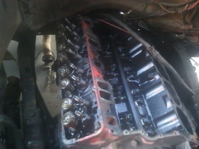

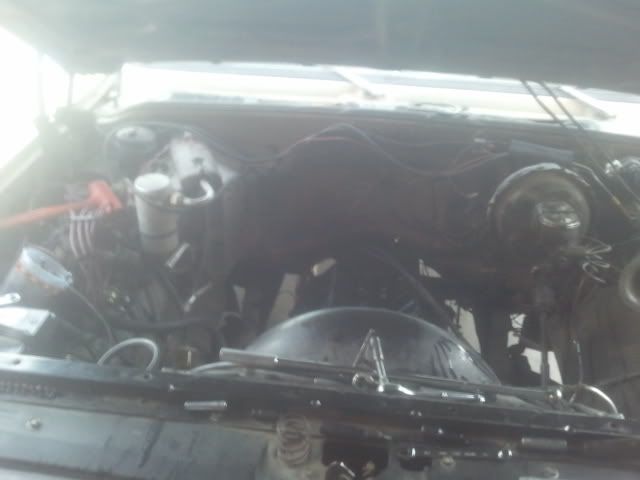

Most of my parts under my bumper.
My mess of an engine bay.
And the passenger side mating surface. Doesnt look too bad.
Now, what can I have the machine show do to these heads to make them better flowing and increase my performance but not break the bank? Just something simple.

I looked up the casting numbers of the heads.
My old heads:
Casting # 462624
Year 76-87
Engine application 350
Valves 1.94/1.50 or 2.02/1.60
Horse power range Not listed(horse power of engine rated at 350hp stock)
Chambers 76cc
Notes PRONE TO CRACK
New to me heads:
Casting # 333882
Year 70-80
Engine application 350 or 400
Valves 1.94/1.50
Horse power range 150-180
Chambers 76cc
Notes Intake flow 137.2 CFM Exhaust flow 95.4 CFM
Will these heads be safe on my engine considering the fact they are rated at 150-180hp and my engine casting number said 350hp 4 bolt main in a truck?

June 08, 2011, 01:59:58 am »
From what I have heard, the notes on the 882 heads should read 'prone to cracking'. I have a set of them on my 406 currently being reworked for a bad valve guide, but they have been worked before and I was told they have 2.02 valves in them. That motor makes 400+ hp and they worked fine until oil started pouring into one of the cylinders through the intake valve. When I get that motor in the next project I will be waiting for them to crack...
