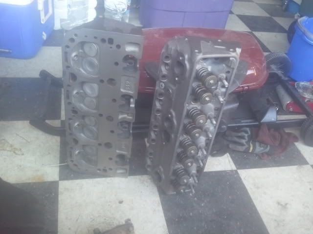

Took them to the machine shop. He said that the 883's are an older cast so it may or may not have hardened seats. And they 883's arent quite as notorious to crack. They are thicker, the 624's have material removed around the water ports to lighten the head, which makes them weaker and makes them run hotter. So, hes going to pull apart the 883's and check them out. Going to.use whichever parts he may need from my 624's. Going to be about a week or 2 since theyre busy. Ill post back findings.

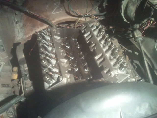

Okay! Picked up my heads yesterday at 430. Brought em home, got them all torqued down and got the valves adjusted. I used a remote button on the starter to turn the engine to compression for each piston, and cranking the engine caused my fuel pump to fill up the lines and when i was finishing up the last 2 pistons, fuel started puking out of my carv all over.my.wngine bay. My carb is sitting on my passenger wheel well with the fuel line still hooked up. so, i didnt feel confortable pressing the button anymore because i didnt want to explode. I unhooked it from tbe battery and called it a night.

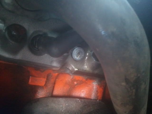

Alright! Finished up puttin her together today! One thing that i am extremely upset about, and about to go to checker and raise heck, when i first started it up to time it and get water in the block, the temp gauge raised to about 160 so i figured the tstat opened. I filled the rad to the top and started her back up to adjust the idle and look for vacuum leaks if any. Took me avout 10 mins. I went back and looked at the temp gauge. 260. Oh S***. The machine shop installed little warranty tags on the heads, and the center of the tag will melt out of it if the temperature goes above 260° well, sure enough, they started melting, which may void my warranty. So i popped the water neck off and pushed the center of the tstat down with a screw driver and it started steaming and most of the water drained out of the radiator. I just replaced the tstat like 2 months ago, and it seized and could very possibly have damaged/warped/cracked my brand new(technically) heads. So i pulled it out and my truck is running at 180 steady. Im very unhappy. Checker will be buying me a new engine if anything is wrong with my heads. I will make sure of it. on a second note, i finished putting my truck back together, and drove it about 8 miles tonight. Im amazed with the power it has with the taller tires on the rear. It doesnt have as much off the line acceleration, but i spun the tires all through first gear and halfway through second, at about 3n4 throttle and easy acceleration off the line. I will post pictures tomorrow when i get to a computer for photobucket.

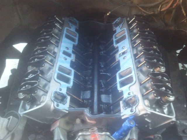

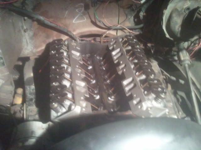

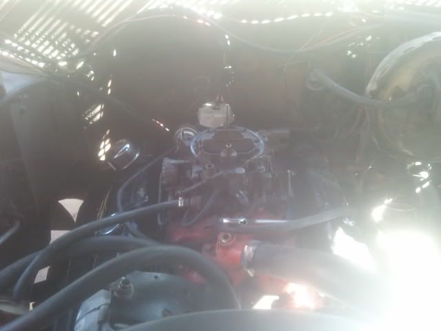

I'm going to repost a few pics just so its easier to follow, and because I uploaded the others and I'd rather post the IMG code.
Got the sexy heads back from the machine shop.
Slapped em on and torqued them down. there is a specific torquing order for the bolts, from the center out in a clockwise spiral. and I
     torqued them in a certain pattern, 30, 50, and then 65, in the special order.
Got the pushrods and rocker arms in and adjusted. Bring the cylinder to TDC compression and then tighten the rocker nut while turning
     the pushrod. When the pushrod stops turning, turn the nut another 1/4 turn.
Set the intake gaskets on with a thick bead of RTV around the water port corners, both sides of the gasket.
Got the intake torqued down to 30lbs. and the carb bolted on and vacuum lines ran.
Valve covers on.

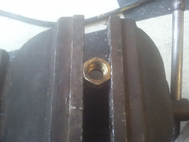

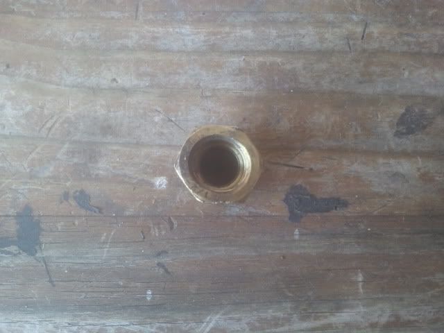

The fitting for the temp sensor to the block was out of round some how. /:
Quick fix with a bench vice. (:

I've put several top ends together and I admit its been a while, but I don't think I've ever seen the rtv around the end water ports.  The only rtv I thought was required was on the front and back if you do that instead of using the small gasket pieces ???  I'll have to look it up soon myself, but on the rocker nuts I thought it was zero pushrod play and then 1/2 turn?
Offline 1979C20
  • Posts: 1659
  • Kyle Taulton.
Re: Hopefully not a cracked block....
« Reply #44 on: June 21, 2011, 03:52:14 pm »
I looked around all over the web and i read that with hydraulic lifters to take it to zero play and another 1/4 turn. The rockers arent rattling, so it should be fine.
