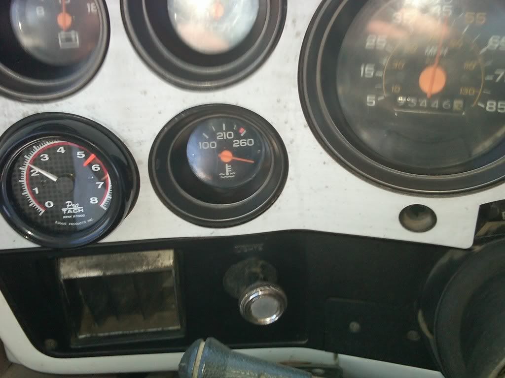

So if you were driving along and looked down to see your temp gauge looking like this, what would you think is wrong?
I went through the cooling system about 6 months ago. I replaced the radiator with the biggest one I could find. I replaced the hoses, thermostat, heater hoses and heater core. It's always read dead on at 195 until last week it just up and did this.

is the radiator full?
a wire may be damaged or the sending unit isnt working.

I second the idea that it may be the sending unit or wiring from the sending unit. The needle looks almost comically far to the right.

I like your tach. Does the temp gauge peg that high when you turn the key on and a cold engine? If ao, sending unit or wire.

When it's cold it sits at 3 o'clock. When it's at temp, it points at 4. It's like it still works, but the scale has shifted by +200*. I checked the wire last night and it looks okay. I'll replace the sender and see what happens.

My experience with air pockets is erratic gage fluctuations, not pegged hot.  I believe the wire to the sender is grounded.  Either the sender is internally grounded because its gone bad, or the wire fell off and is touching metal, or the insulation burned off and the wire is shorted to ground.  Take the wire off the sender and verify that it goes to cold.

I replaced the sender this weekend. It was definitely bad, with the electrode moving around in the sender body. Unfortunately, the problem is unchanged. The gauge sender screws into the center of the left head. In the center of the right head is another sender looking thing. I finally figured out from reading this board that it's the switch for the auxiliary fan. It was broken off and the green wire that connected to it was lying all burned up on the exhaust manifold. I replaced the switch and the wire and now the auxiliary fan works again! Yay! But God is it loud. I totally expect it to burn up in the next year. Anyway, when I can scrape together a few dollars, I'll hit the local Pick-A-Part for a new gauge. Till then, I hope I don't have any cooling system problems. I guess if I hear the auxiliary fan over the sound of the engine, traffic and a squadron of F-15s taking off right beside me (shouldn't be too hard), then I'll know I'm running hot.
