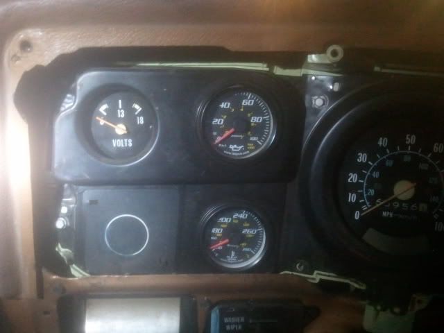

Here is how I did mine.
I cut out the black metal piece to fit the gauges and use the mounting threaded ring that is included with the gauge to install it.

Do you have a picture of it complete? Did you use the clear plastic as well, or just put the outer bezel on?

Ill have to take a new one complete, I cant find my old one  I used the clear plastic piece when I first did it, I had to cut out circles around the gauge so it would sit flush, but the plastic broke one of the times I was working on my dash.

I just added in an a/t temp gauge in the clock spot.  You can see the clock adjuster hole in the plastic still, but it blends very well with the oem gauges.
I tried mounting it to the clock face plate, but that was too small.  So I just used a scrap of sheet metal.  I spend too much time trying to match the oem bend.  I just a flat section with enough bend to get to the mount screws would be fine.
On my '81 they did away with the metal cover over the gauges and it is flexy plastic you couldn't mount anything to that.
