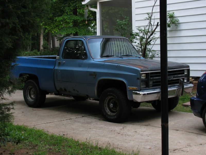

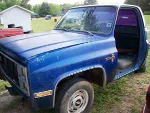

I bought a 1986 K10 from my buddy back in 2009 for $700.00 with the intention of using it to pull my jet ski to and from the lake..... little did I know I would be selling the jet ski and keeping the truck as my toy. It originally had a 4.3 liter 6 cyl. engine and is an Illinois truck so you can imagine the rust. My buddy replaced the 6 cyl with the 6.2L diesel and a 700R4 trans when the original engine blew. He thought the diesel would have more power.... boy was he wrong. Haha.
Pic of the truck when I brought it home:

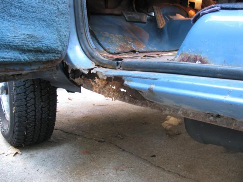

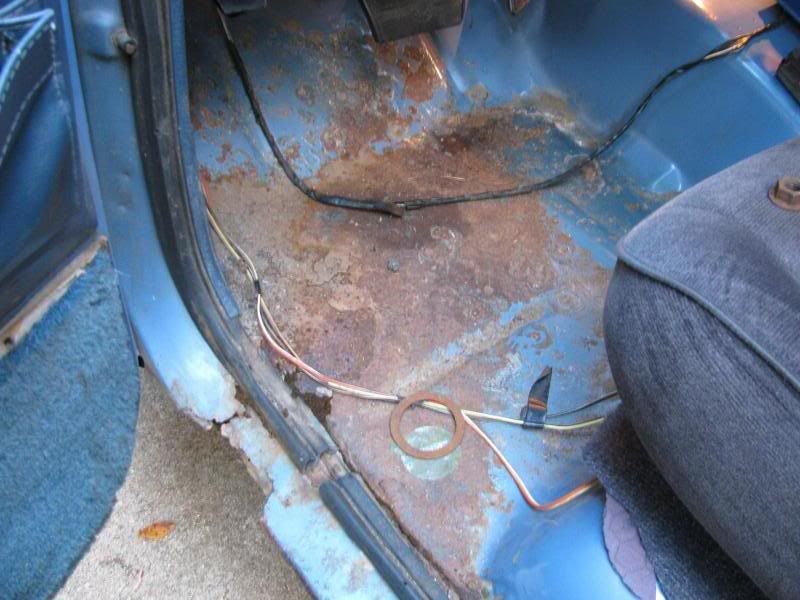

I ended up driving it one more day out of the year and decided I was going to do a rebuild on it when I found this:

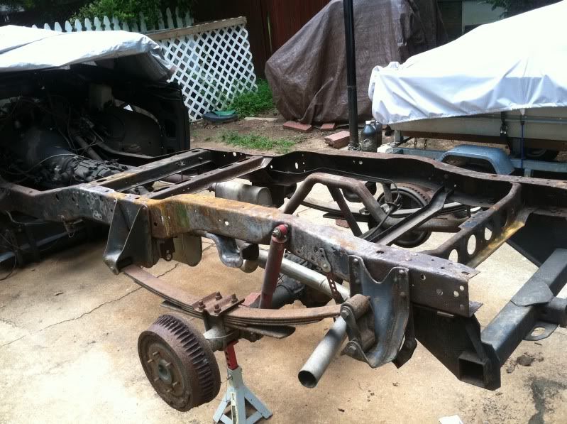

I realize now that I could have just gotten patch panels welded in and it would be done.... but now that I have the bed off I'm glad I didn't since that was rusted really bad and so is the frame.

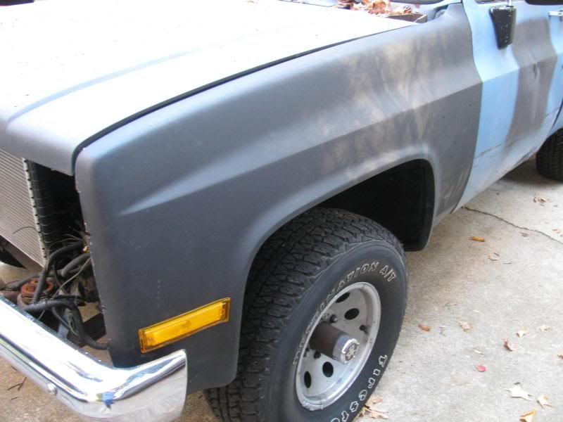

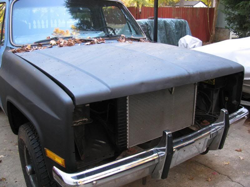

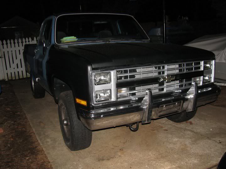

I went out and bought a cab for it for 200 bucks, a fuel tank and sending unit, brackets, a bed for 400, and a bunch of other miscellaneous parts. I used the original radiator core support (I sandblasted it and painted/bedlined it), the original front bumper (new brackets and bolts, just polished it up and it looks new), headlights, passenger fender. I replaced both inner fenders and the driver side fender since it was dented real bad from a blowout.
Front end done:

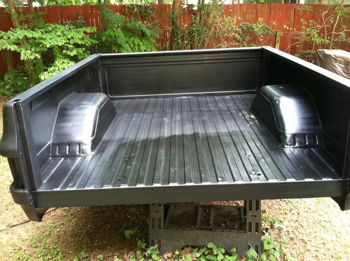

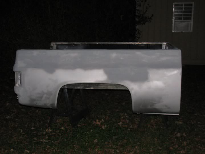

"New" bed before:
Bed as it sits now:

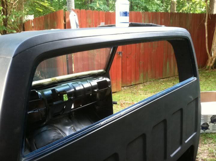

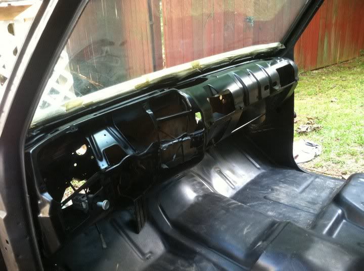

Cab after sandblasting and priming the floorpans:
Cab as it sits now:

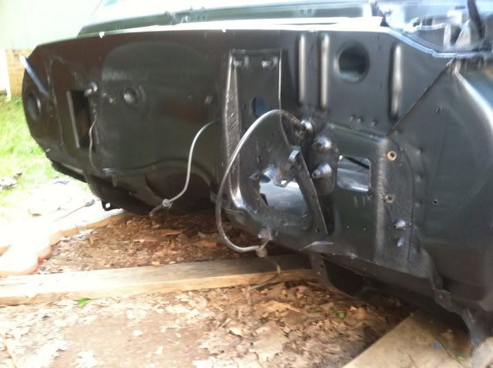

Painted firewall:
You could have fixed that cab but it looks like you would have spent close to what you paid for your new cab in patch panels by the time you were done.

I think you did the right thing by replacing the cab is what I meant. Just buying the patch panels would be about what you spent on the new cab. Rust is always deeper than it looks on the outside. Plus you saved a lot of work. $200 well spent on the cab.

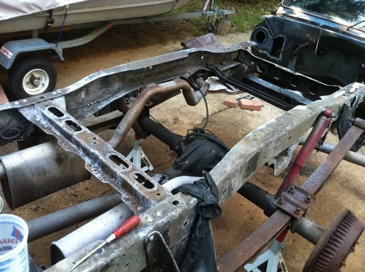

Thought I would post an update....

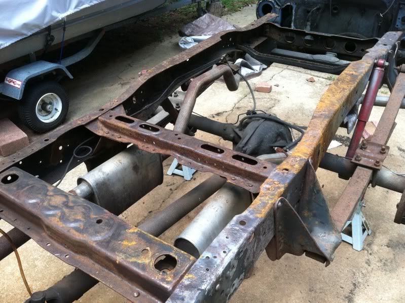

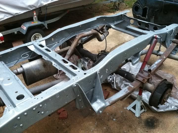

The cab is off and I just coated the frame this past weekend. I used KBS Coatings Rust Seal 3 Step system.
Check out the before picture (I had already used the wire wheel to get the loose rust off)

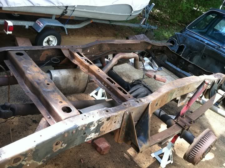

After I used the Aqua Kleen degreaser:
After I used the Zinc Phosphate "Rust Blast" stuff (notice the cloudy looking color the metal now has):
Final product! (I still have to paint on a couple more light coats, but you get the idea)
