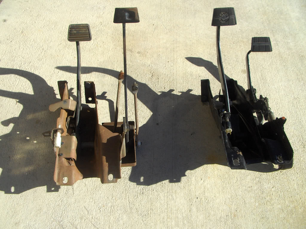

Is this hydraulic or mechanical?
Here is a picture of both: Hydraulic on Left, Mechanical on the right:
