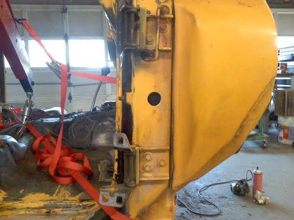

This shows how the hole is centered between the hinges on the A pillar

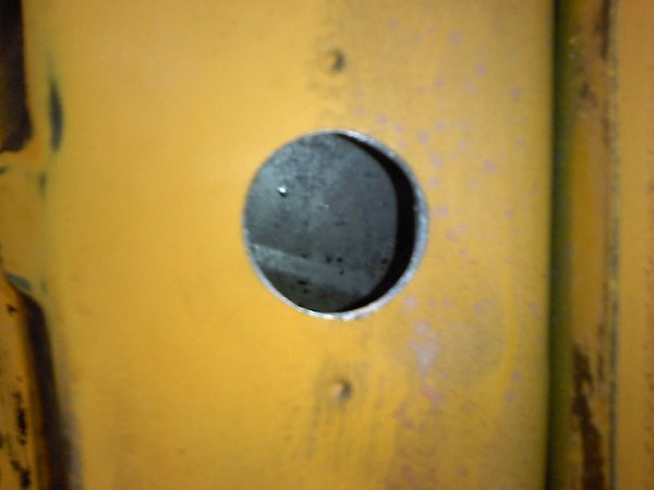

Close up of the dimples for the rivet holes on the A pillar spaced 2 5/8" apart

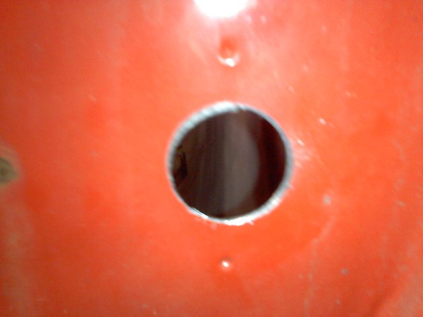

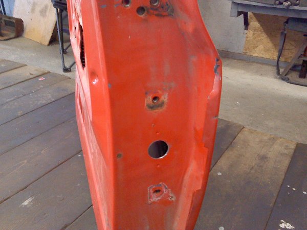

Hole in the door centered between hinges
Close up of the dimples for the rivet holes in the door spaced 2 5/8" apart same as the A pillar

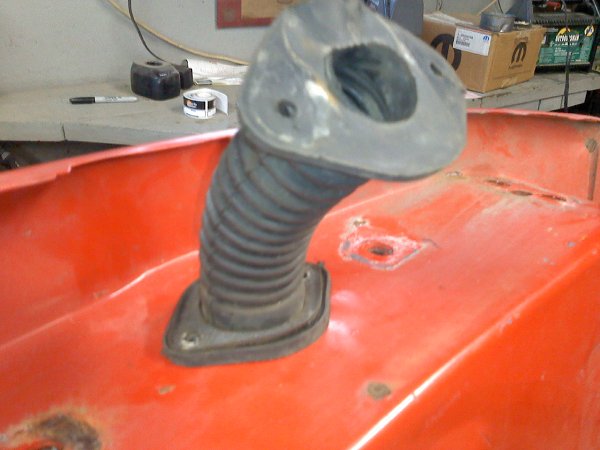

Boot that gets riveted on to both the door and the pillar
