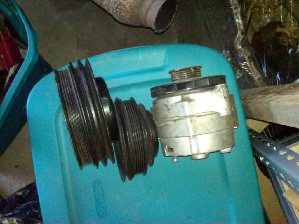

This is the best pic I have.  This was in my 87.
Screamin, Shoot me a PM if you have these pulleys layin around.  I need the Crank pulley, water pump pulley, alternator pulley (including any spacers under the pulley on the alternator) and maybe the PS pulley if you think it's different than what i have on my 78.  the PS pulley on my 78 is a double belt pulley.  I think They'll work, or I'll just make em work... :)

I'm almost certain I have the crank alt and water pump pullie. Like I said I had that same setup on my 86 trans am then used them on my 82 trans am and when I sold the motor I kept all the accesories. Ill look through my garage tonight or tomorrow and see what I can find.

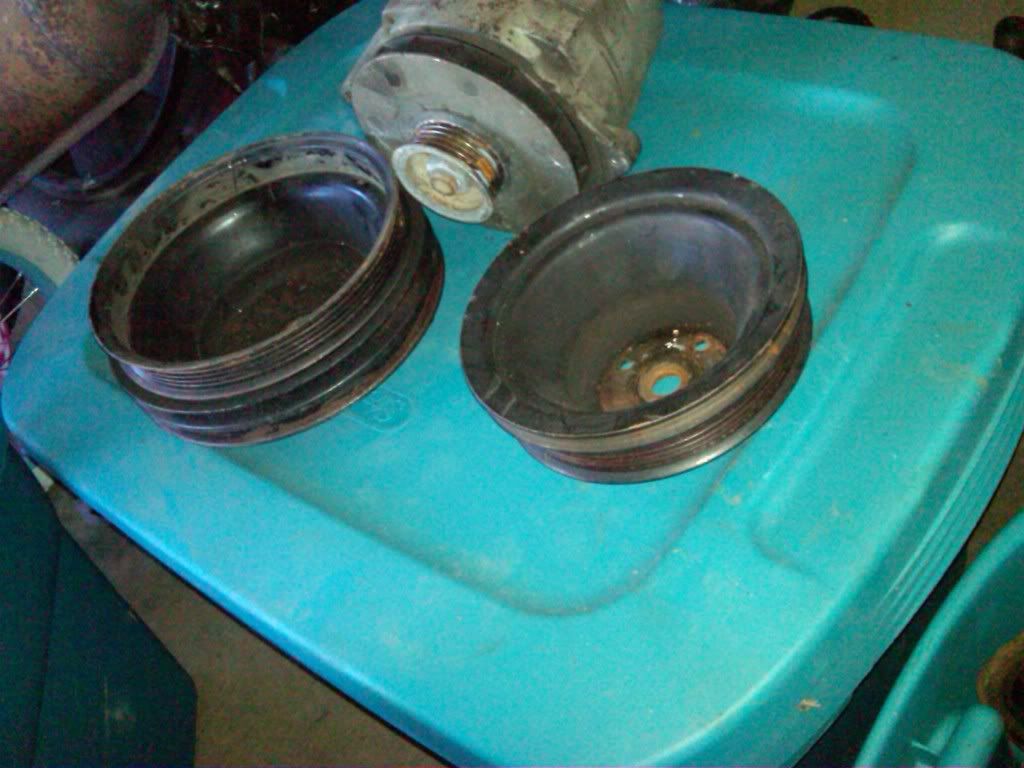

here is what i have. actualy come to think of it these may be the actual stock ones from my k10 i think i used the other ones i had on the truck since they were already nicely painted from the last builds they were on lol.

Looks perfect man!  I sent you a PM.

screamin sent me the pulleys, they look great!
I'm kinda injured right now.  I'm in an arm sling, but when I'm able to, I'll get them cleaned up and painted and I'll put what i find out about them in this thread.
Only thing I kinda recall from my 87 was that I had to put washers under the PS pump bracket to get it to line up properly, but otherwise everything was fine.   This was on a 1973 400 I fitted all the TBI stuff to.  We'll see, either way its gonna work.

I got my 3 new Goodyear Gatorback belts ordered and Dad got the pulleys done for me.  He bead blasted them and painted them with clear hard hat paint.  They look like pewter.
Now I'll have to give him my PS pulley too.
Also figured out, if the PS pulley needs to be moved forward to line up, I'll just leave the PS pulley up the amount needed on the shaft, then dont have to mess with spacers.
I'm hoping the Belts I got will fit.  I bought the serp belt for an 86, and the rest for a 78.  the belt dimensions are the same section wise, but i hope the length works out, as the new crank pulley looks a fair bit larger dia. than the old crank pulley.  well I'll let you all know.  When this works out, this might make a good tech page to help people with high-AMP alternators when the old V-belt doesn't have the grip to turn it at high loads.  I'll let you guys know the differences and how the math works out and what speed everything will be turning for each pulley set.
