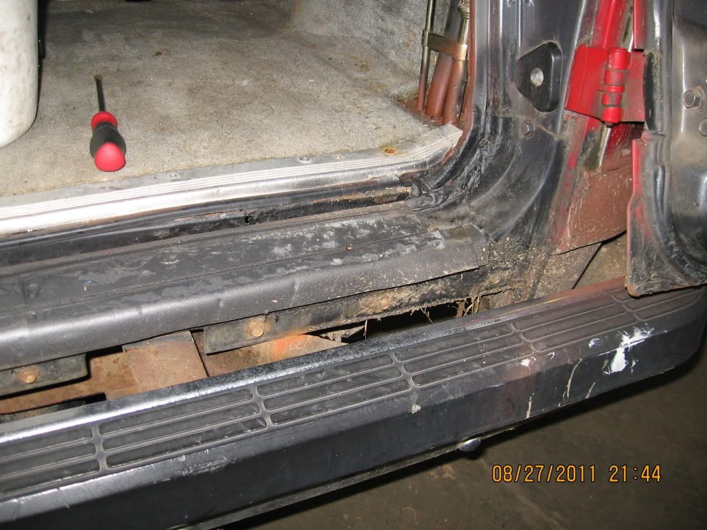

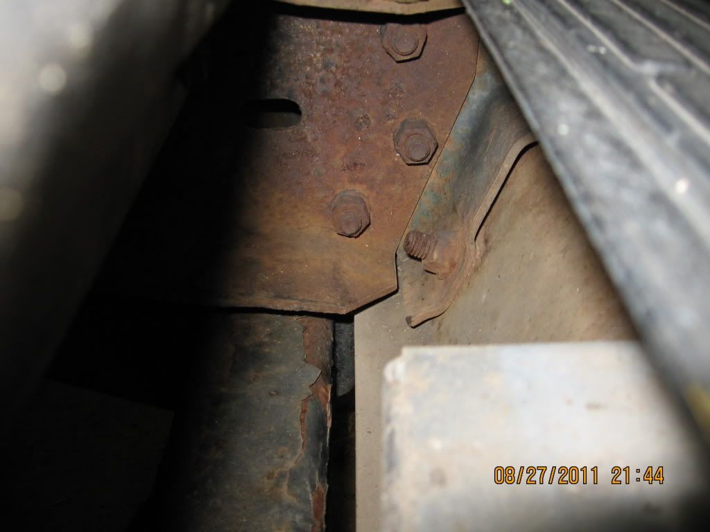

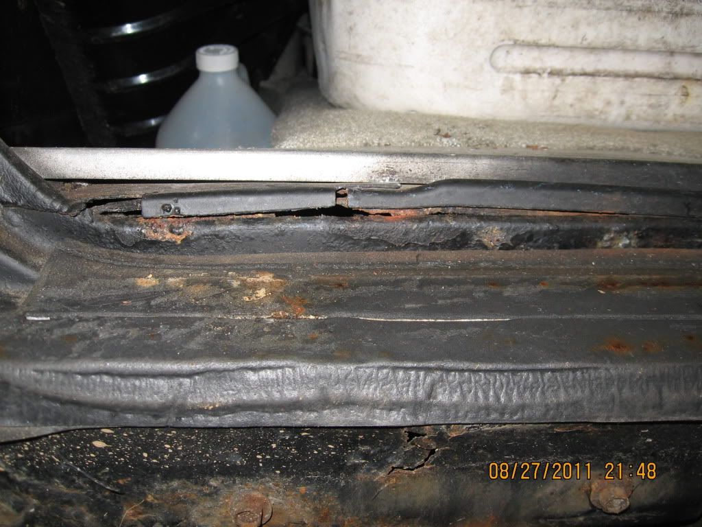

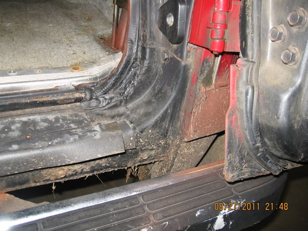

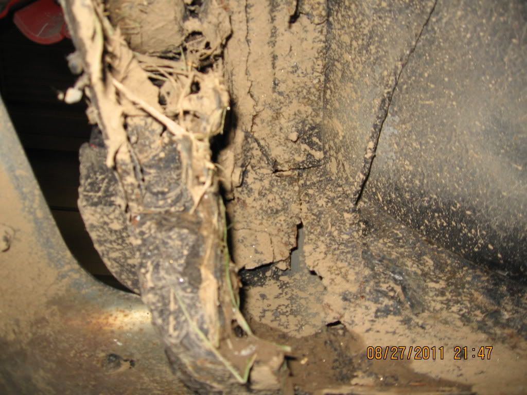

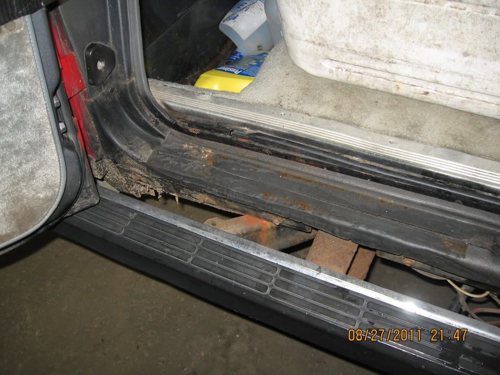

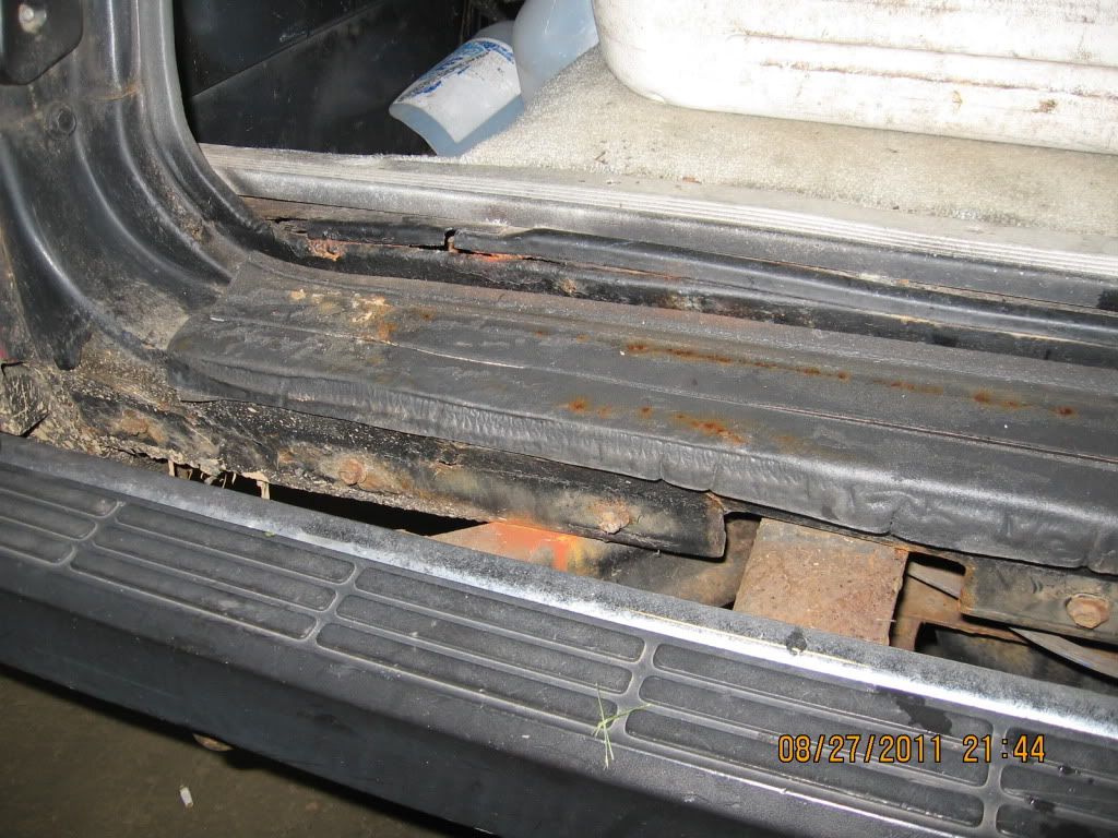

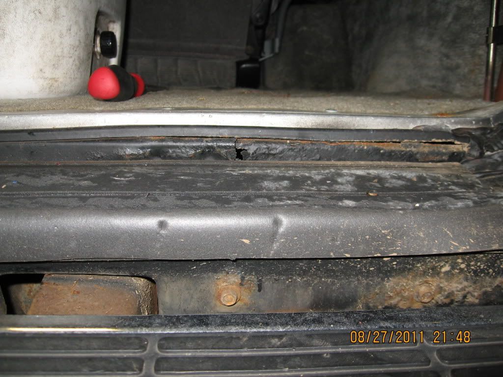

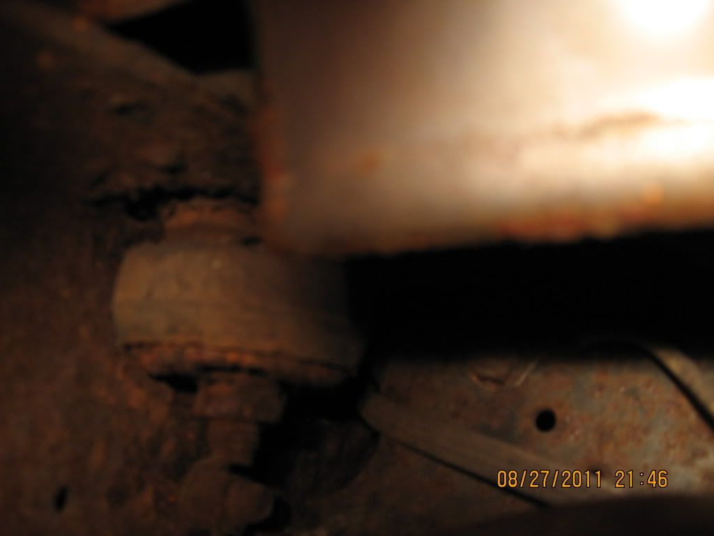

Here is some pics of the rotted out cross member on the truck:

If you look close at the last 2 pics, you can see the floor sagging around the body mounts on the door sill there, it's like that on both the right and left sides, and the tail pan is actually sitting and rubbing on the bumper brackets as you can see the rust scrub marks in some of the pics on those bumper brackets.
I bet I will get another 1" of lift in the rear of the body after this is done, and it will remove some stress from the other body mounts and body frame parts in the rear of the truck.
Little by little I am going to start picking away at soaking fasteners and chasing threads that is holding this all together to prep for this project. I think I will be able to save the rubber parts on the rear mounts, just need to replace the bolts, nuts and washers.
Got to get the bumper in a ready to remove position also, as it has to come off to access this area. This will also give me a chance to attack any rear body and chassis area with my needle chisel gun to clean that shoot off and rust reform it.

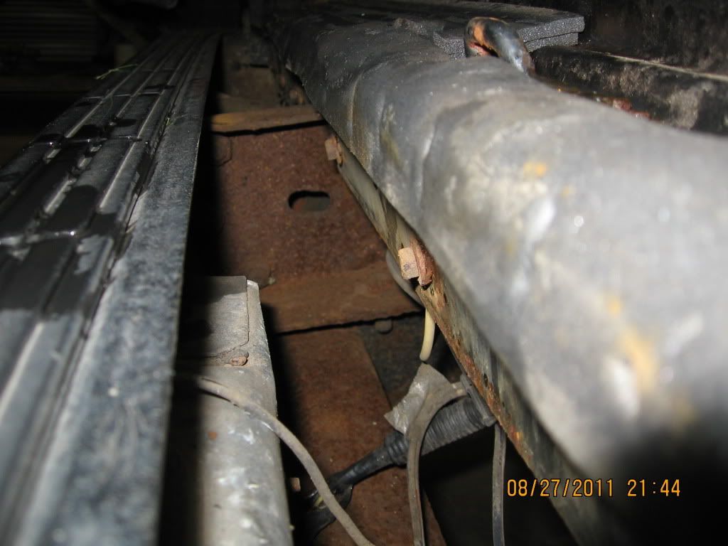

« Reply #6 on: January 15, 2012, 12:06:14 pm »
1989 GMC Suburban V-1500/5.7 L TBI/700r4/NP241C/GM 10 Bolts
