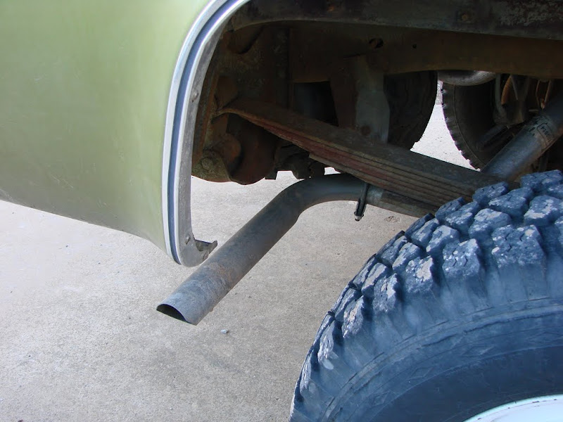

The first photo is what was on the pickup since around 1997 (how time flies).

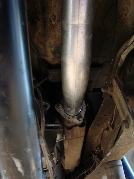

The first photo is looking up the passenger side near the exhaust manifold.
The second photo is looking toward the front from behind the transfer case.  There is a close clearance to the transfer case support brace, but I just couldn't seem to avoid that. Either the pipe went near the brace, near the transfer case or near the cab floor.  I figured that located near the brace was better than near the other two options.
