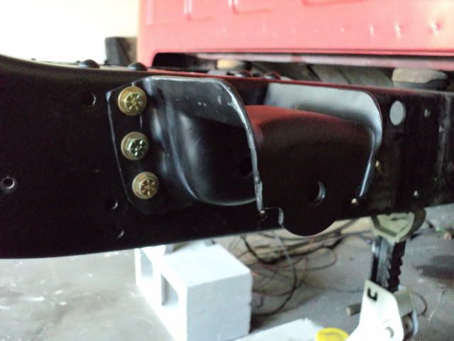

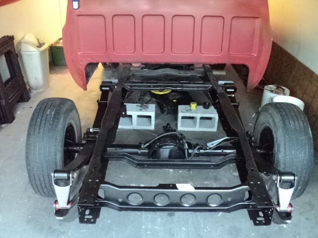

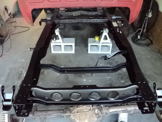

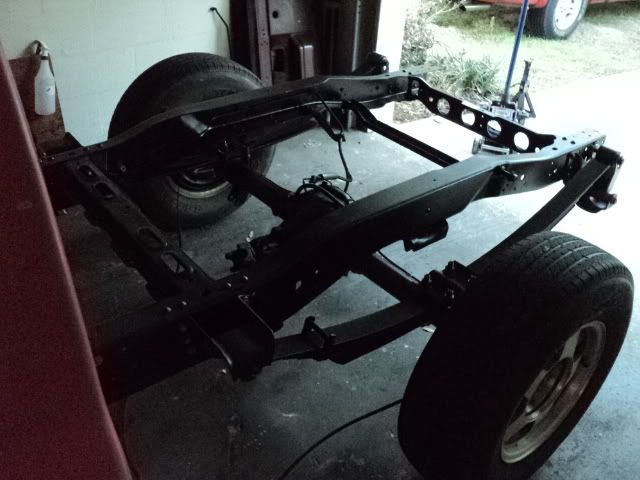

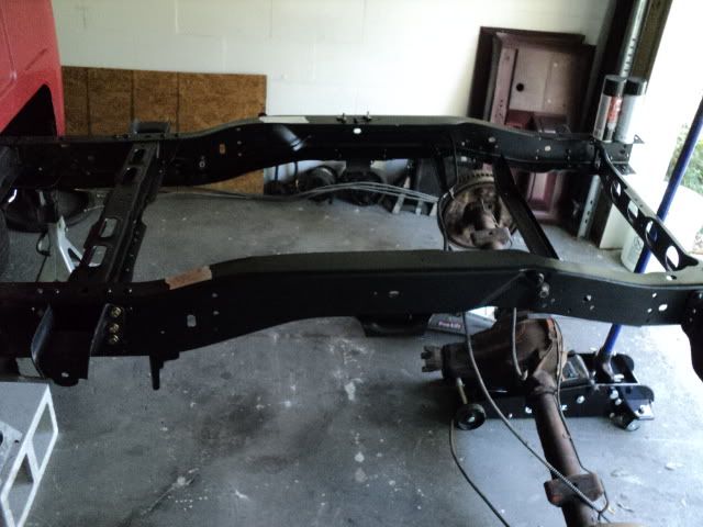

Offline chevymanrob
  • Posts: 100
Re: C-notch needed? lowering rear 4-5". (pics added)
« Reply #6 on: December 20, 2011, 04:42:15 pm »
ok here are a few pics to show everyone my wreck...and the weird looking stuff on the top of the frame is masking tape where i had measurements and notes...just easier to keep it there!

Rob, I see a couple things that you should be aware of. (1) Moving the front perch on the frame 4" or so will only lower your truck a bit over half of that distance. (2) The pinion angle on your rear axle is going to be WAY positive. (3) The front spring eye should always be lower than the rear to control anti-dive, I suspect yours the way it is now is higher.
At this point you could install 2" drop rear shackles which are inexpensive & will go toward  lowering the truck & fixing the pinion angle.
Originally I had done my rear suspension similar. I put 2" drop rear shackles on & moved the front hangers like you did, however I stopped at something around 3".  The total drop at the center of the wheelwell was about 3 1/2". Not near enough for me so I ended up doing a flip. Hope this helps you in some way. Lorne
