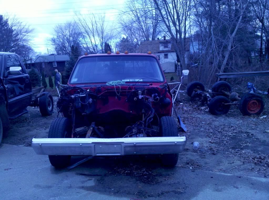

   Just found this site and was impressed with the knowledge of everyone with these trucks so I figured I would share a project I am working on. It's a spare time project. Anyways Plan is to build a Daily driver that will be an all around good truck.
   The Lowdown, I have two young kids so a back seat is a must, It snows up here in CT so 4wd would help, Gas prices are just rediculous so it has to get good fuel mileage. Also I don't like being like everyone else.

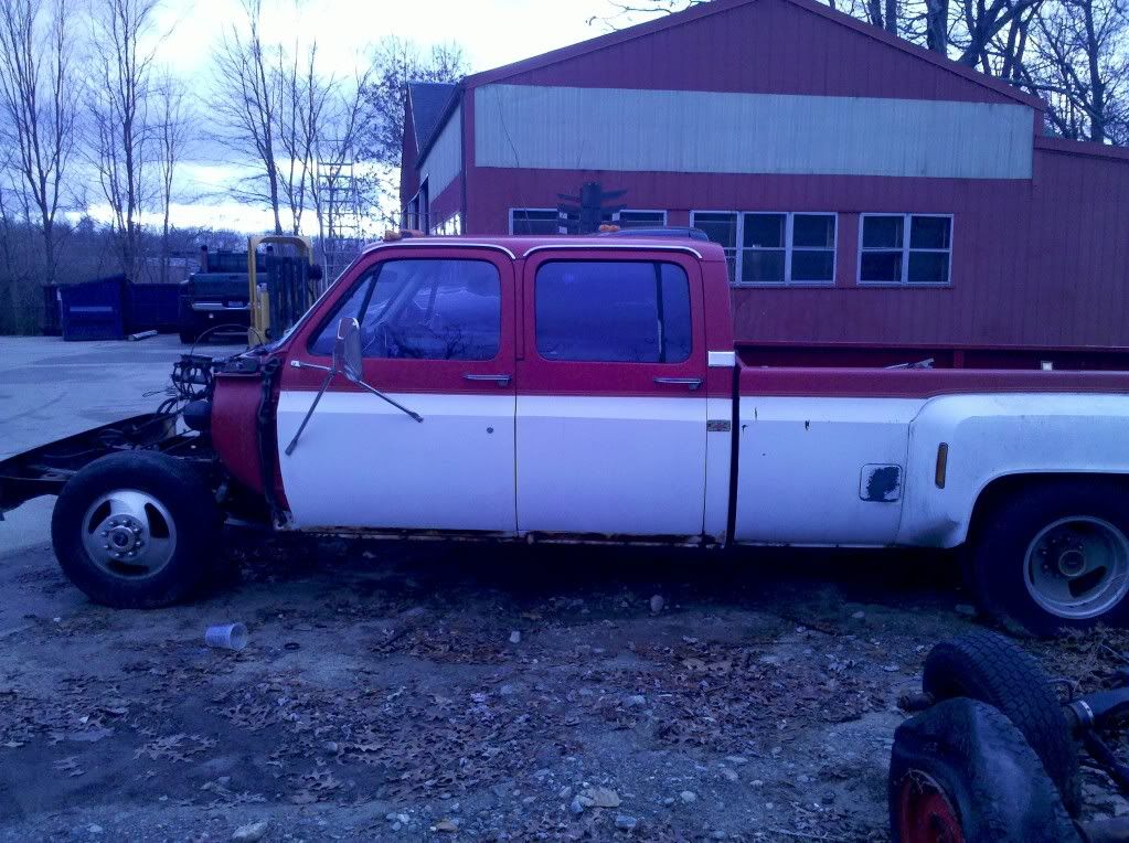

   So with that being said I had a 87 R30 that I drove a few years ago. Cam went bad and it got parked.

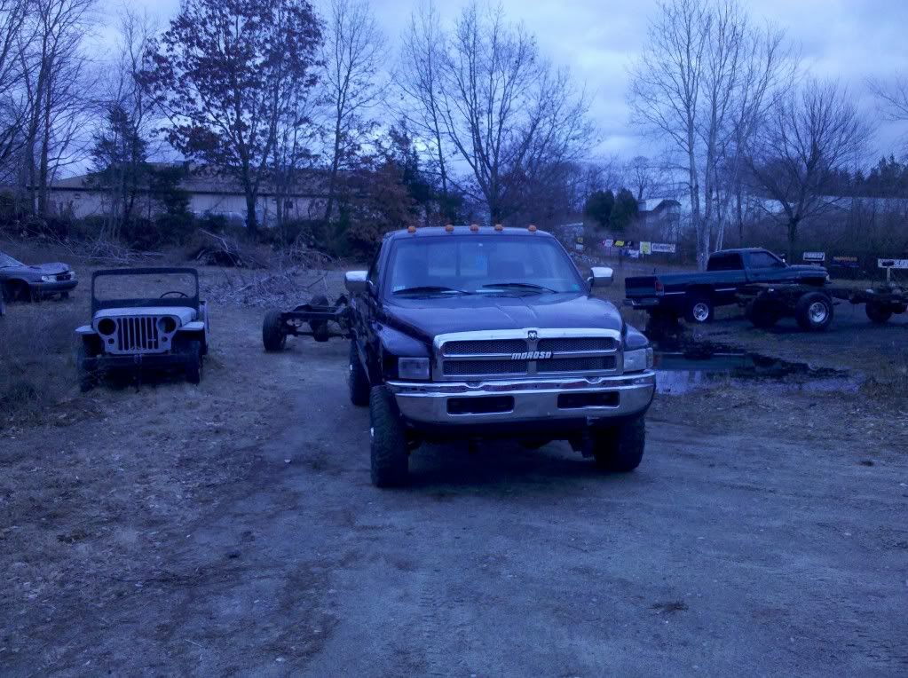

Started by ripping off the front end Pulling the 454 and TH400

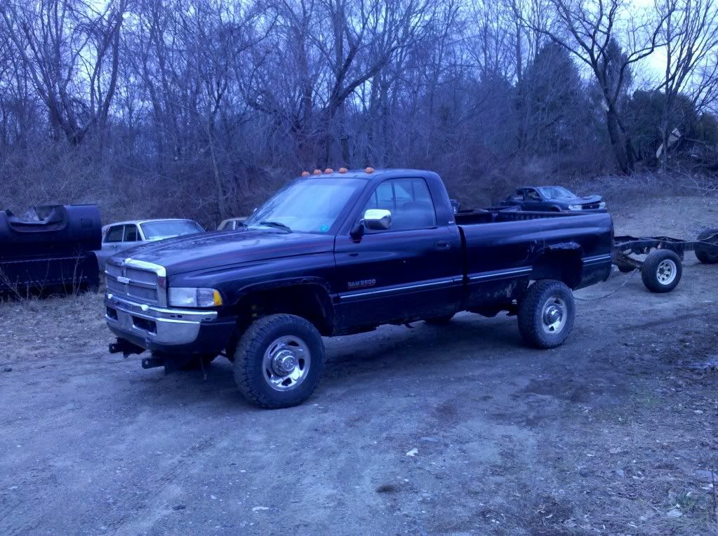

The truck that was going to give it's drivetrain
Picked up a short bed.

Entire drivetrain from the Dodge will go in. Down the road after it is all together and the bugs worked out I will start upgrading the drivetrain with a built tranny and swap the unit bearings for Ford knuckles, spindles, hubs.
Right now the Dodge  truck runs and drives fine

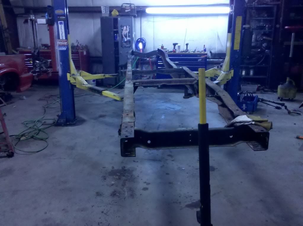

Last Monday I got started. Being a holiday I was able to work all day on it without getting interupted or the phone ringing.
Lifted off the cab
Took off the bed and moved the cab and bed outside
Removed front and rear suspension

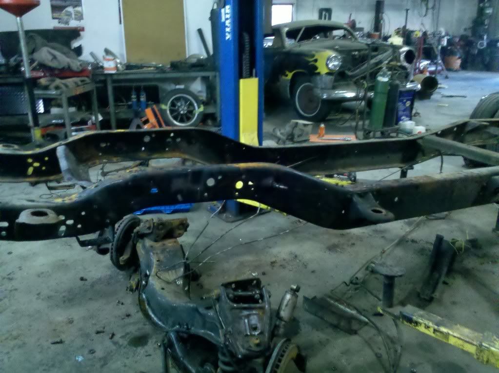

Bare frame ready to shorten

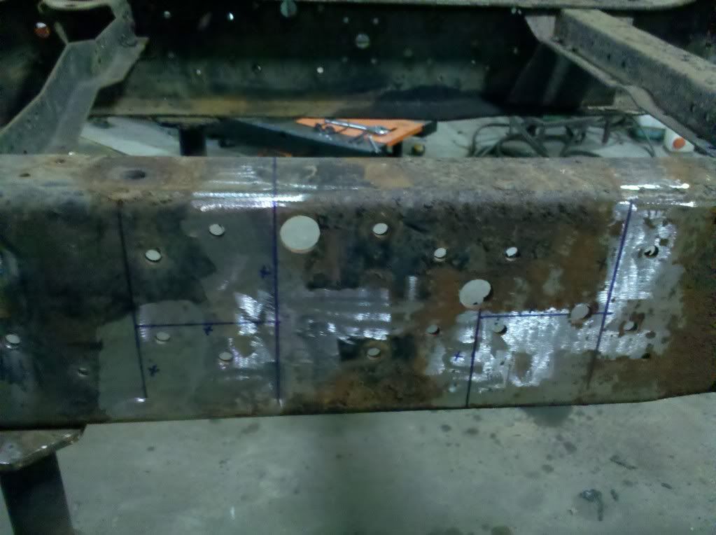

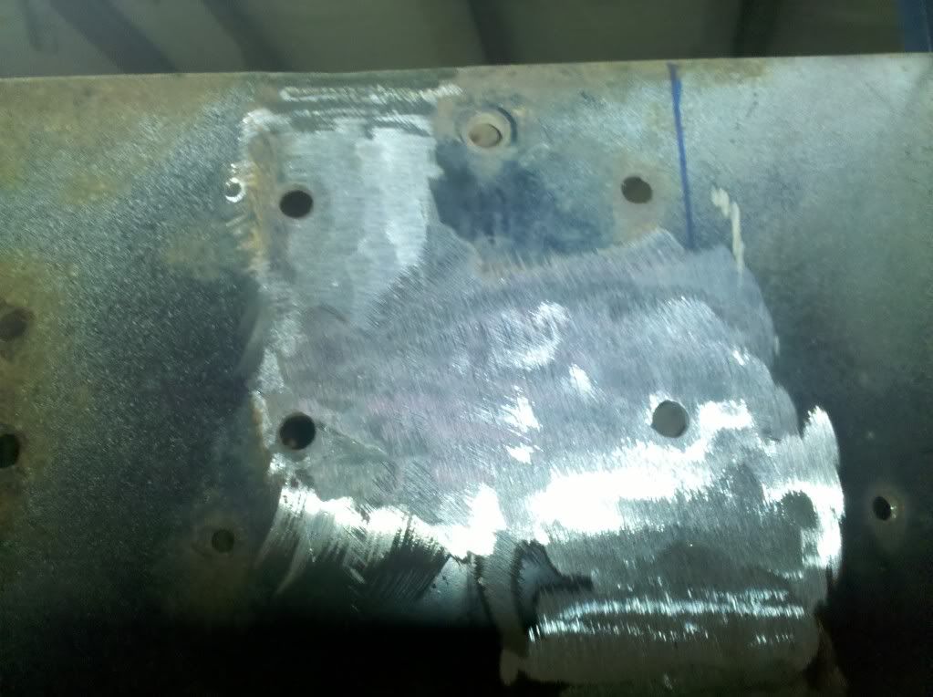

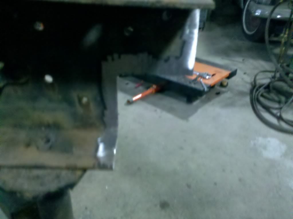

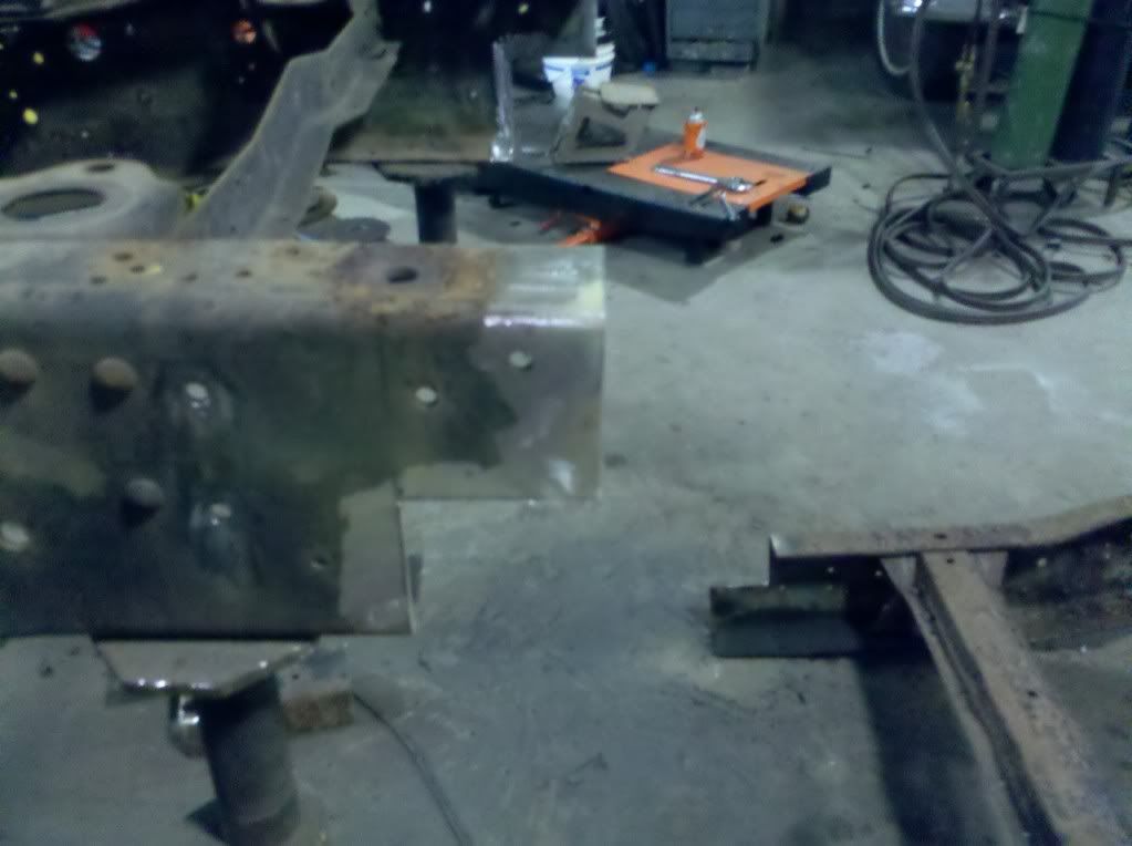

Ground the rust away and layed out where to section. I am taking out 10" instead of the normal 14 to fit a shortbed. You'll see why later in the build
Frame cut
Cleaned the inside of the frame also for a good weld

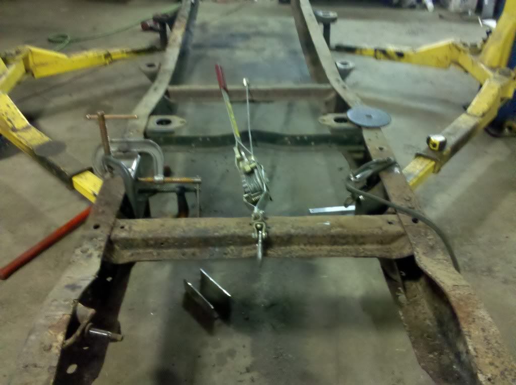

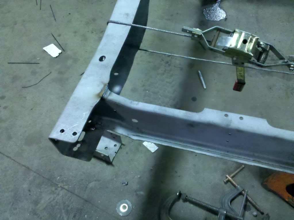

Fit the two frame peices back together, got them perfect needed to trim a bit on one side to get it square

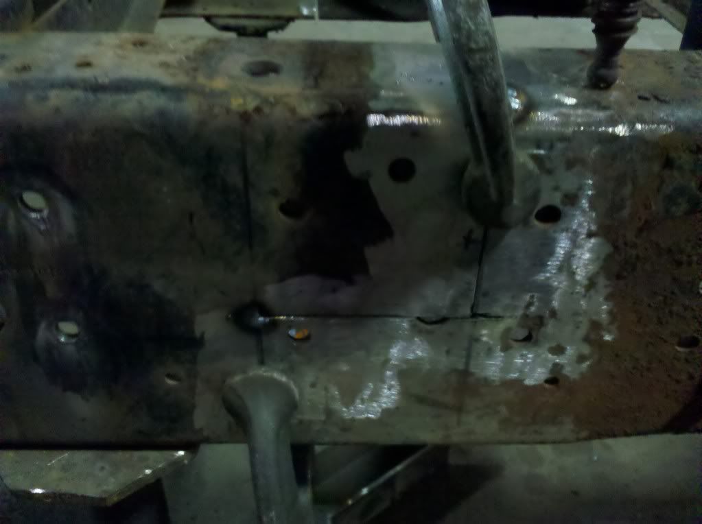

After it measured up I tacked it together then ran a 1/16 cut off wheel back through the cuts leaving the tacks so i could get the propper penetration.
All welded up Back ground the inside and welded that up also. I then ground it smooth

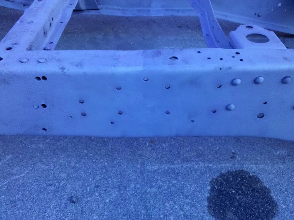

Got the frame back from sand blasting now the fun begins
Have to look hard to see where I cut, ( yes it's getting fish plated on the inside)

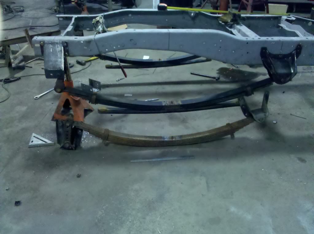

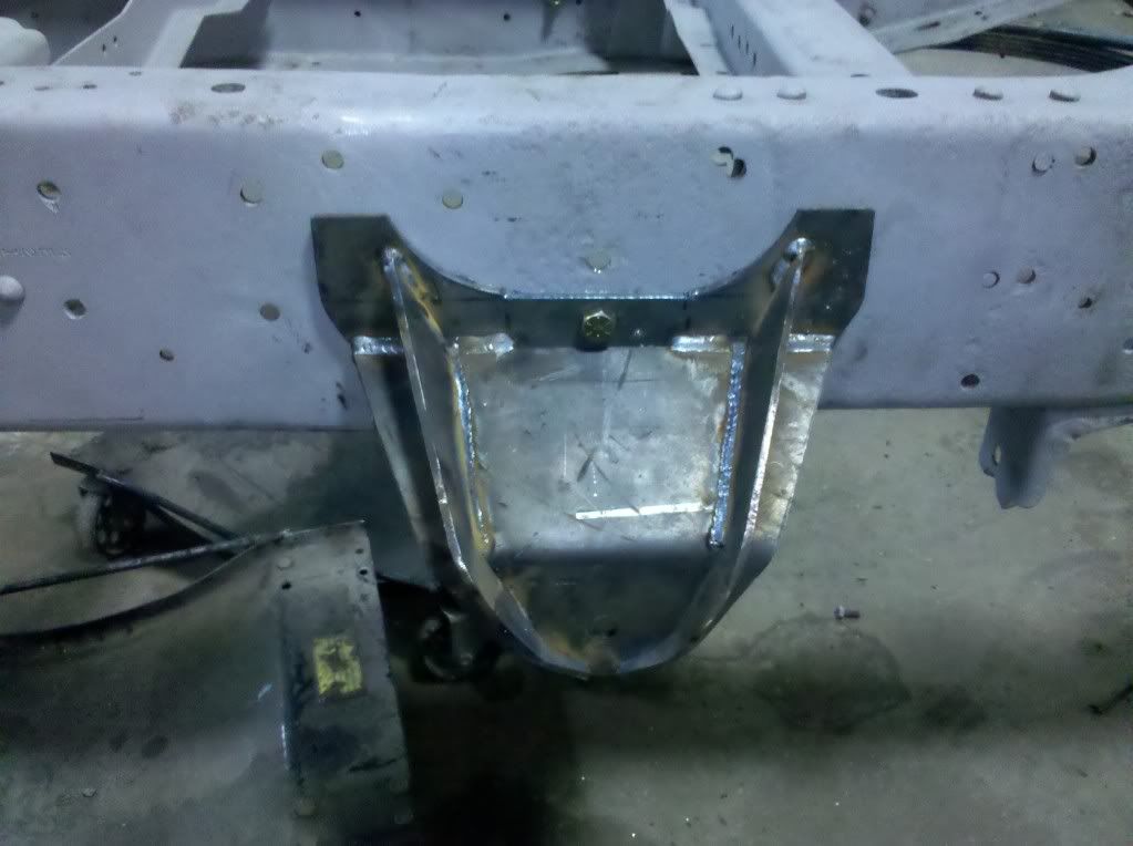

Made some rear shackle hangers
Moved the rear crossmember up 6" welded it in and vut off 6" from the frame

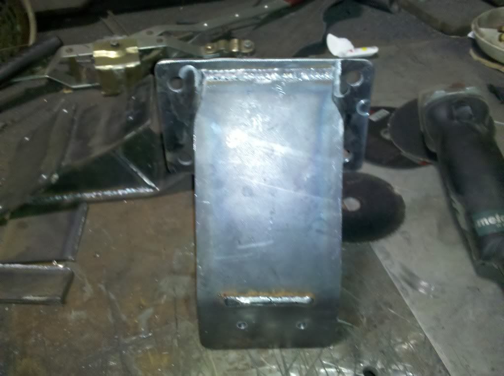

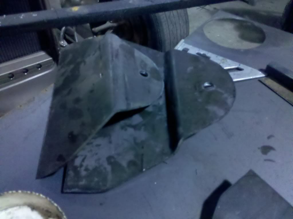

Started building some front spring hangers, Plasma cut out, and bent.
Front hangers almost done
I want a nice ride so I figured my buddys 05 Silverado 2500HD rides nice. So I got a set of springs from one
Big difrence compared to the old ones.

The rear springs are 2005  Silverado 2500 64" leafs. The front will be coils not sure what coils to use yet. Have to get the drivetrain installed I will weight the front axle and get some progressive wound springs. The kdp will get tabbed when I reseal the engine.
