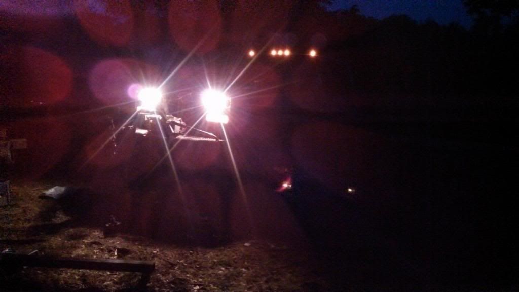

Lights installed (gift from the wife)

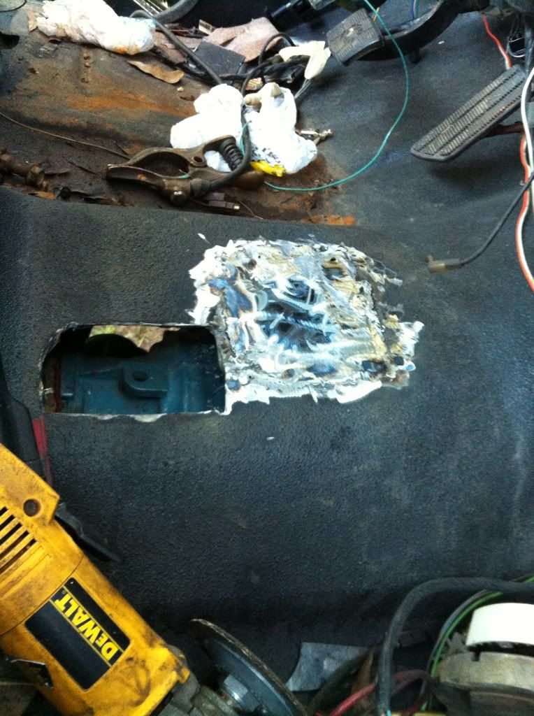

Hole for t case shifter (2wd cab) always measure more than twice before you cut lol

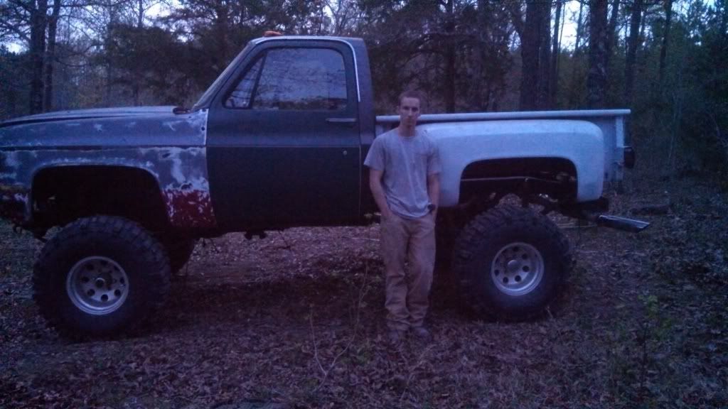

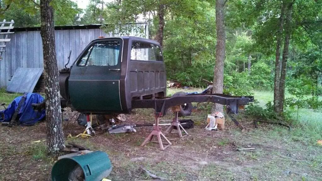

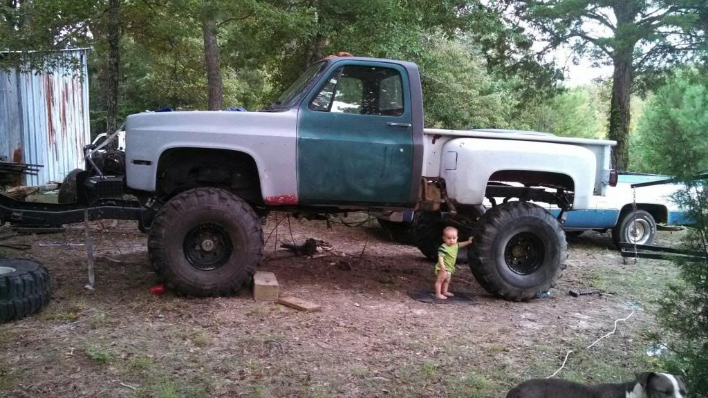

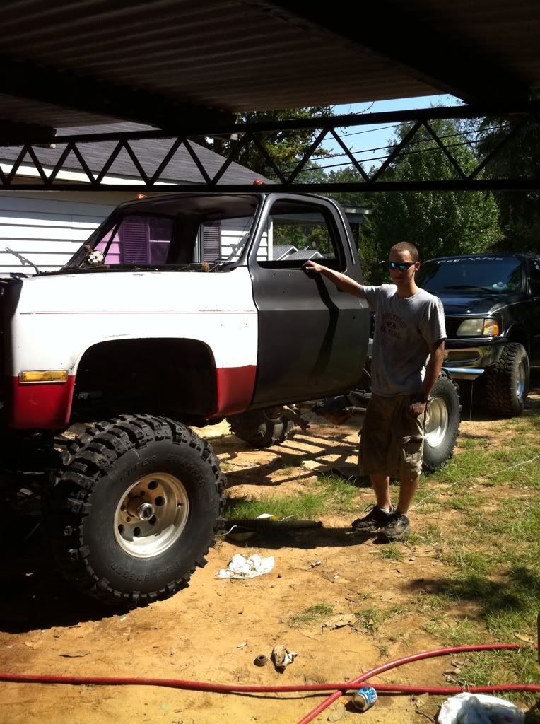

OK been a WHILE had  a little boy, changed jobs, got married. Now back to the truck lol everything has been put back together besides the engine I built its still sitting in the shop were I work (need heads) anyways been driving it with just rear driveshaft and no bed or grill in it. Put a bed on it tonight, put power doors on a few weeks ago hopefully getting the grill in next week. Here's an updated pic

« Reply #35 on: February 02, 2014, 09:34:49 pm »
UPDATE:
finally got settled enough to start back tinkering on my truck its been a long time, between work and watching my little boy i havent had much time.
 built the truck realized the frame was bent and had been patched a few times.... so out with it and in with another one.
New setup (go big or go home :))
Dana 60
14 bolt ff
sm465
205 t case (twin sticked)
39.5 tsl's
15" bead locks
Kevlar stainless steel braided brake lines
91 blazer front end
power doors
warn 12000lb winch
custom front bumper
step side bed
floor boards sprayed with bed liner
PLANNED UPDATES:
custom diy4x dash
disk brakes on the rear
window tint :)
build a back bumper
transplant steel bed floor into step side bed.
relays for headlights and door glass ( already done this to a few trucks anyone want a write up?)
LED lights everywhere! haha
im sure im forgetting something. me and the family are about to watch a movie, when i come back ill add pics and fill in all the empty spots on the build

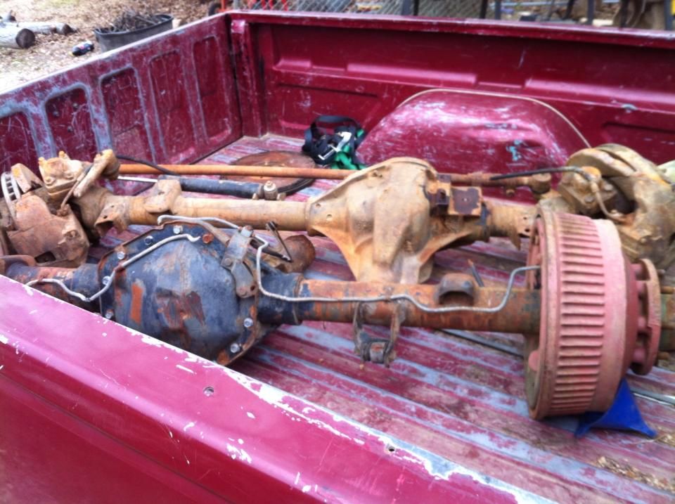

Got some parts! dana 60 and a 14 bolt ff 4;56 gears and a Detroit locker in the rear

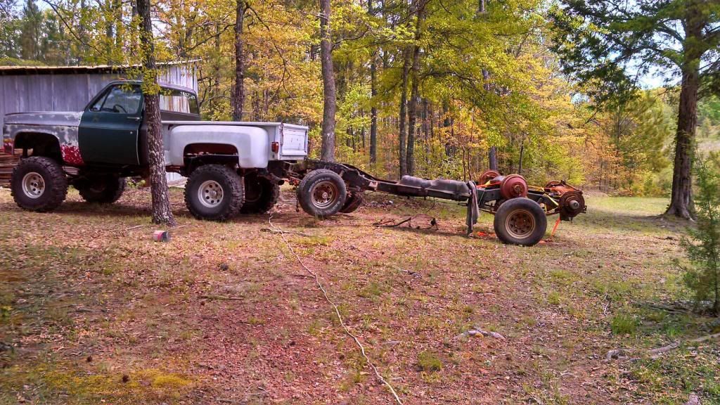

moving the donor frame to the new work location (who needs tow dollys?)

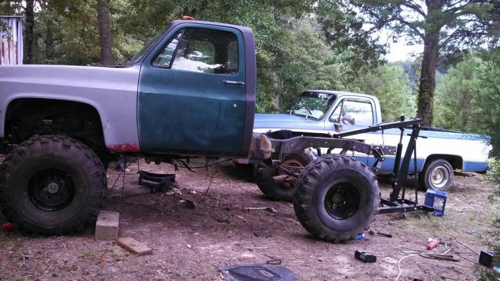

The tear down has begun!

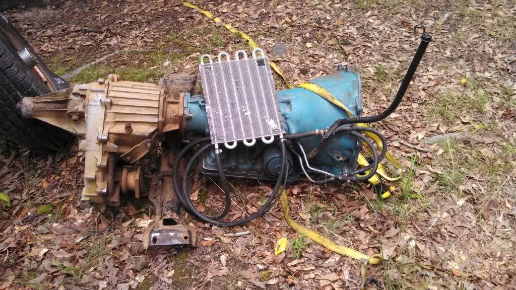

needed help moving cab so started on the drive train. picked up an sm465 and np205 from a guy that turned out to be a very big help in my 4x4 adventures lol.
old 700r and 208

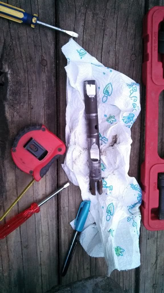

205 shift rails ground for twin sticks (i actually did it right the first time)

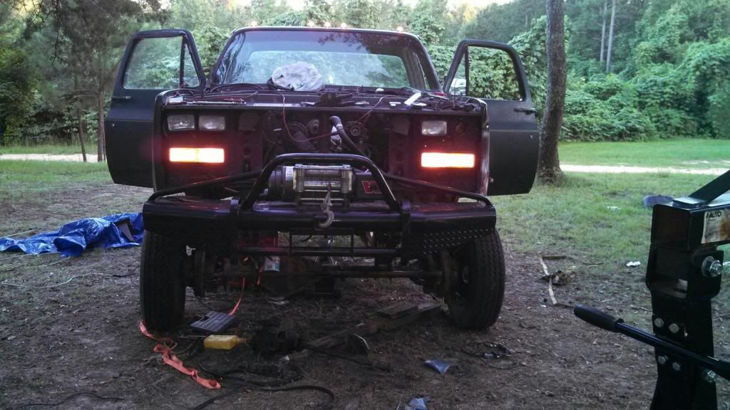

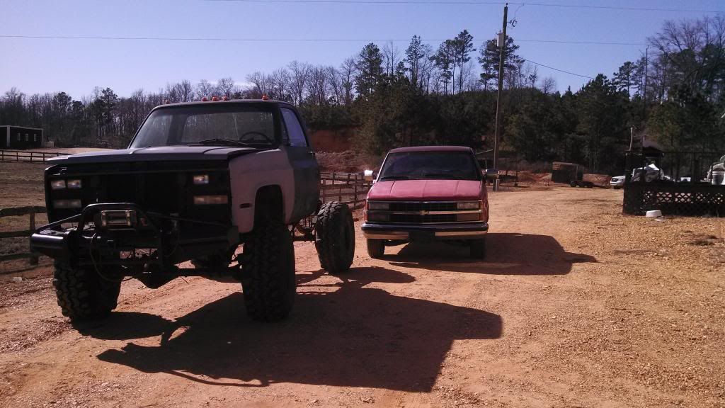

front clip wired up. also added a custom bumper and warn 12000lb winch (thanks to the 4x4 guy aka Mr Belcher again)

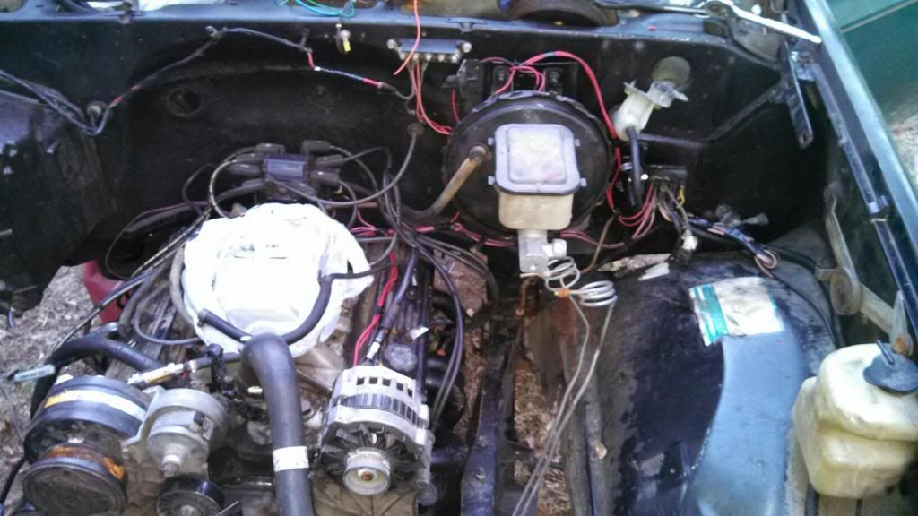

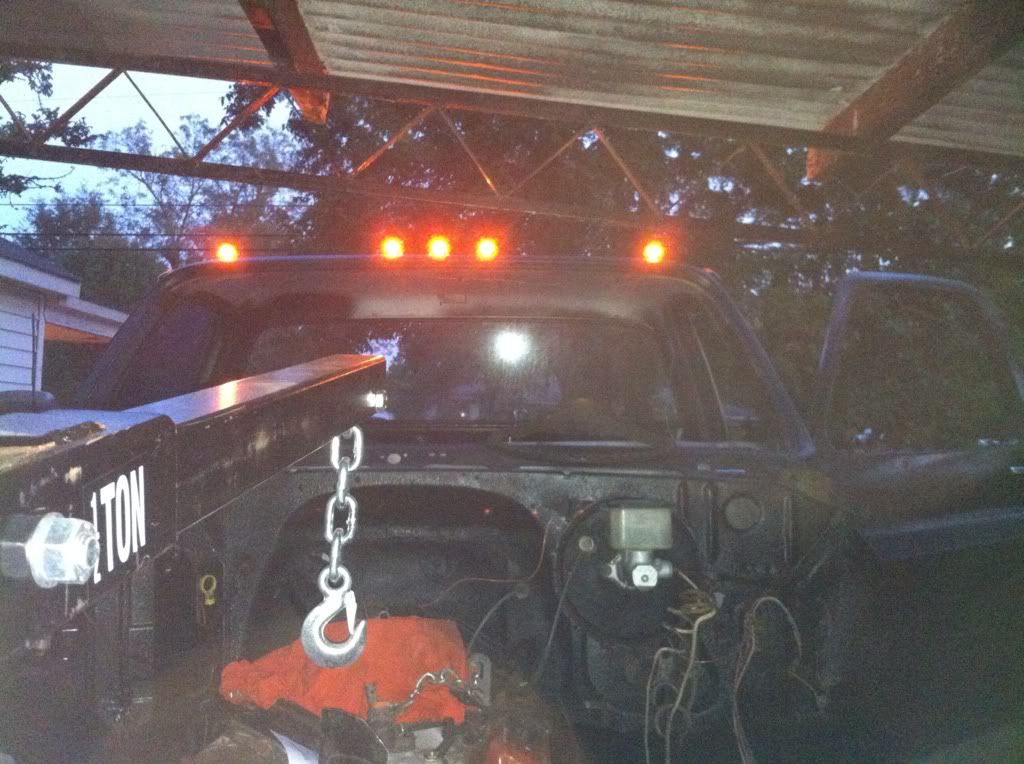

got some wiring fixed in engine bay. used a junction block off a 90 model chevy i had out back

this is where we are now

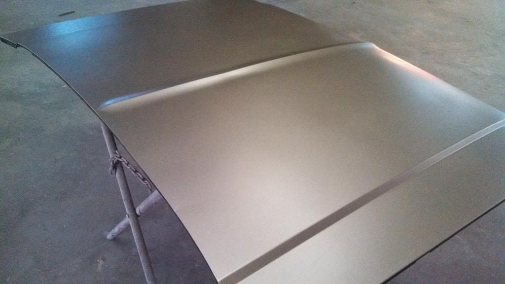

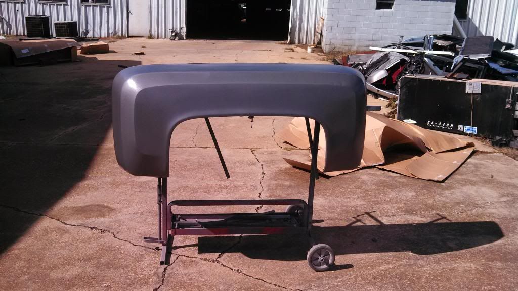

bed side painted
hood based in
