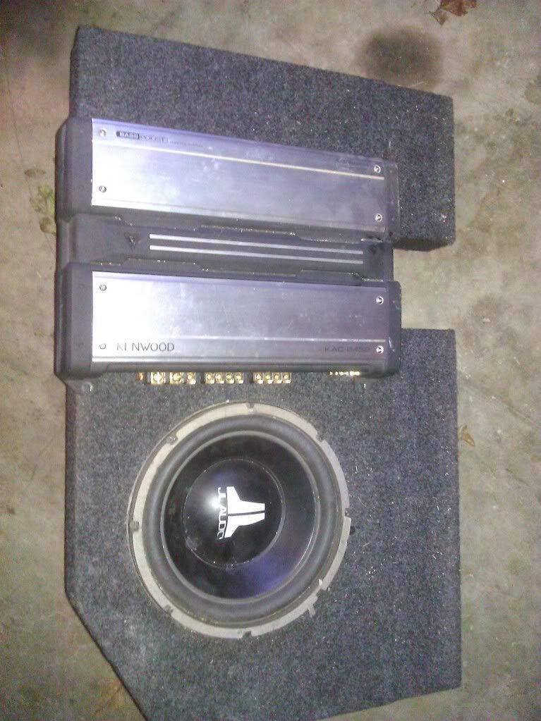

Also, got these from work for free. Got to love working at a dealership and people not caring about what goes away when they trade in a vehicle.
More to come soon!
