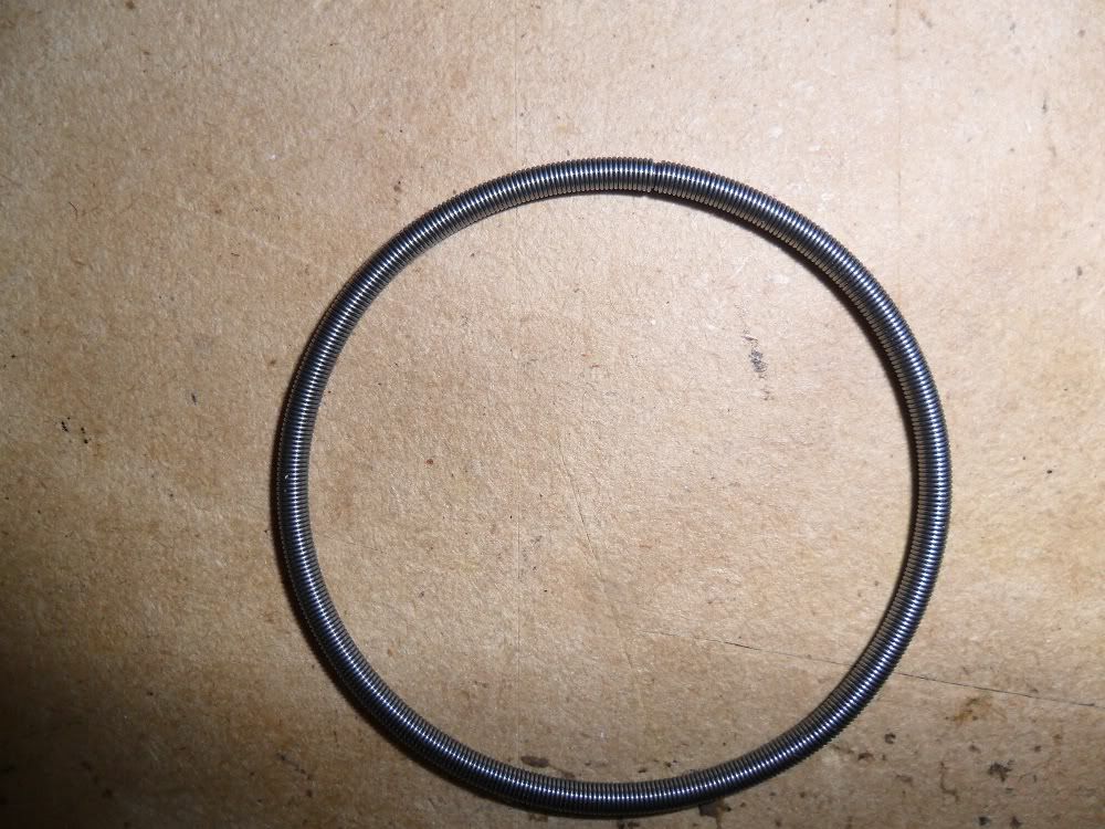

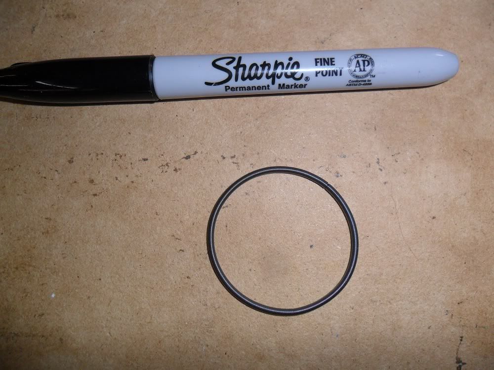

Also I found this weird spring-ring in there. Its real springy and stretchy. Not sure how to put it back cause I found it laying on the ground under the tail shaft lol
