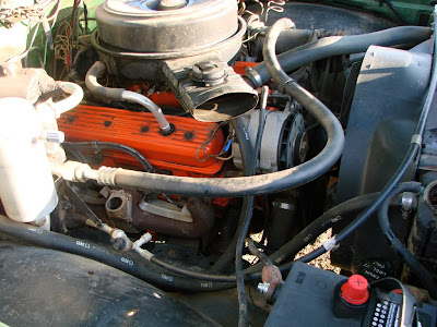

For the most part the '74 is pretty much stock.  Here are a few photos of the truck.

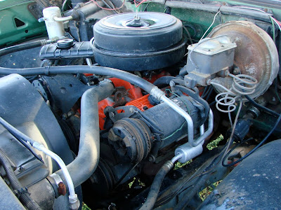

Under the hood resides a '76 4-bolt main 350 with TBI style heads, Edelbrock performer intake and an electric choke Quadrajet from a '85 Dodge D-350 dually pickup.

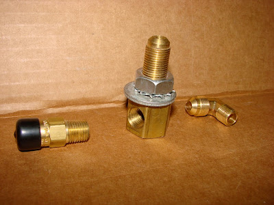

Bulkhead fitting, line pressure blow off valve and 90 degree fitting.

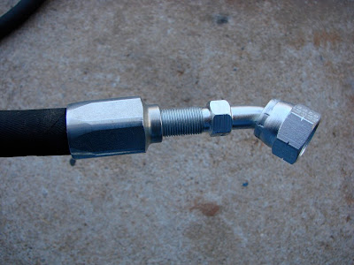

LPG liquid line. I used about 15 feet which was more than sufficient.

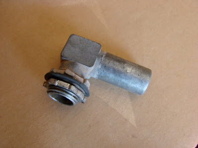

Example of a fitting for the LPG liquid line. I used two 90's, one straight and one 45 degree fitting. The 45 is shown in the photo.

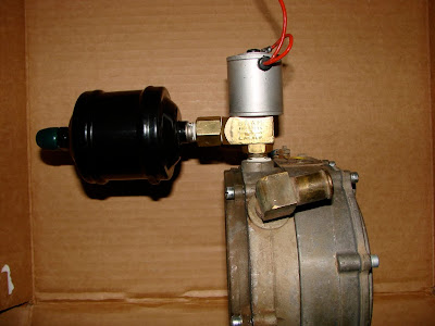

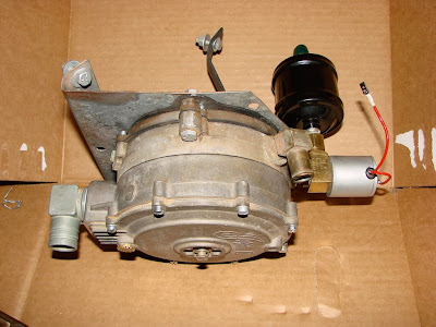

Impco Model E regulator, filter and fuel lock-off valve.
Regulator mounting bracket

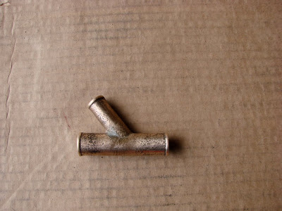

Heater hose y-connector.  There will be two, one for the 5/8" hose and one for the 3/4" hose.

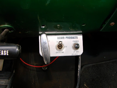

Fuel selector switch, primer switch, bowden cable and bracket. Here is a photo after installation. This bracket is incorrect in that it says in for gasoline, out for LPG.  It is actually the other way around.  The fuel selector switch is a simple three position toggle switch.  The primer switch is a momentary push type.

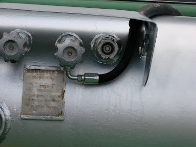

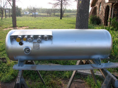

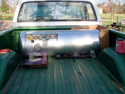

Last but not least, the propane tank.  I bought the tank used, cleaned it up and installed new valves and fittings.
There will be a few other brass fittings that may be necessary. When installing the gasoline lock off valve, I had to use several different brass fittings. The fittings necessary will depend upon the lock-off valve style.

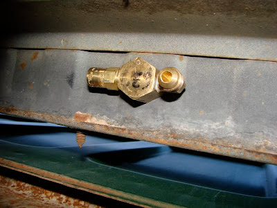

The first thing I in the conversion process was to install the propane tank and bulkhead fitting into the bed of the truck.
Assemble the bulkhead with the blow off valve and 90 degree
Be sure to remove the protective cap from the blow off valve you hook up any LPG.
For the assembly, I used Ace Pipe Thread Compound on most of the LPG and gasoline fittings, otherwise I used teflon tape (per the propane supplier recommendation).
Then,
I cleaned and washed the front side of the bed.
When deciding where to mount this tank, I had to be careful and consider there is a crossbar under the bed that is approximately 1 1/2 inches wide about 3 inches back from the front of the bed.
I mounted the bulkhead slightly off center.  Pilot hole first then the 7/16" hole.
Then insert the bulkhead fitting and tighten the mounting nut.
View of bulkhead fitting from under the bed.

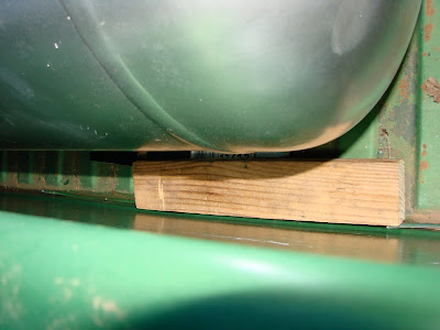

Next comes the actual propane tank.
When deciding to mount this tank, I had to keep in mind the crossmember under the bed floor.  So I either had to mount the tank extremely close to the front of the bed or drop back to clear the crossmember.  I chose the later. A 2x4 will by the bed wall will show you about where the front edge of the crossmember is located.

I decided to go ahead and replace the heater hoses and install a new thermostat. So I drained the cooling system and flushed it very well with clean water.  I installed a new 180 degree "heavy duty" thermostat and new hoses.

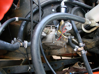

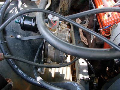

Next, I assembled the propane regulator, fuel lock-off and filter.  I used the pipe thread compound referred to above on all the liquid connections. I used teflon tape on the vapor hose fitting.
Next, I mounted the regulator assembly to the regulator mounting bracket.  I put some rubber between the aluminum regulator and the galvanized steel bracket to try to keep corrosion to a minimum.
Front view of bracket, regulator side.
Side view of bracket
Side view with top brace installed.
View of rubber insulator
View of regulator assembly installed on bracket.
I installed the regulator assembly on the fender well. As LPG will have some petroleum oils, I oriented the regulator as shown to allow any oil accumulation to drain to the bottom of the regulator.  Also I mounted the regulator somewhat low to prevent potential cooling system air pockets in the regulator.
Next, actual plumb the cooling system into the regulator using the Y fitting.

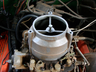

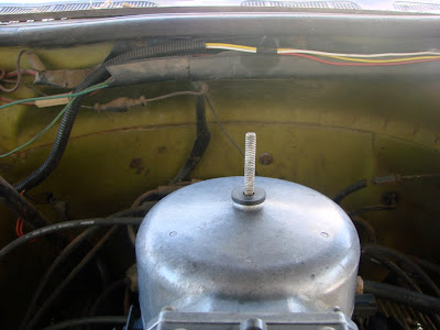

The last step in the installation process is to install the propane mixer/carburetor parts.
First remove the air cleaner and air cleaner stud from the carburetor.
Next mount the propane mixer/carburetor adapter to the gasoline carburetor. Make sure there is a gasket between the adapter and the gasoline carb. I reused my old air cleaner gasket. Note the orientation of the adapter, as this will affect the rest of the assembly process.
Next comes another gasket.

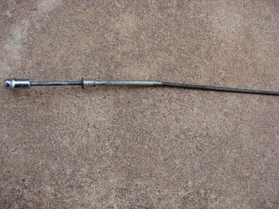

Before the next parts could go on, I had to install the bowden cable for the dual fuel operation. As I was using the speedometer cable grommet to route the wiring for the Primer and LPG & Gasoline lock-off valves I wanted to add some insulation to the bowden cable. I used heat shrink tubing so the wire armor on the cable wouldn't chaff the electrical wiring for the rest of the LPG system.
Here is the cable without insulation.
Insulation installed from where the bowden cable mounts to the bracket to past where it goes through the firewall.
Close image of the insulation on the bowden cable.  I layered several pieces of heat shrink tubing to ensure there wouldn't be any chaffing on the electrical wiring.
After insulating the cable, I routed it through the LPG switch bracket.  Don't forget to install the lockwasher and nut that secure the cable to the switch bracket.

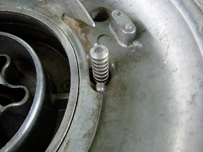

This is a closeup of the ramp and how it relates to the spring loaded pin on the adapter assembly. The adapter is in the closed (LPG) position in this photo.
After the cable is mounted, I carefully turned everything right side up and installed the assembly to the carb adapter.  This was a bit tricky to line up everything and install the mounting bolts.
Closeup of mounting bolt.
Once everything was bolted down, I pulled the cable out to the open (gasoline) position. I checked to make sure the cable opened and closed the air diverter properly. If it didn't operate correctly, the cable would need to be adjusted at the end to get the diverter to open and close properly.
After I checked the operation of the air diverter, I installed the bottom plate for the air filter.
Then I installed the air filter and top plate. I secured the top plate to the mixer.  These type mixers usually have three brass nuts along with the three screws. I swapped the wingnuts on instead of using the brass nuts.

For the propane liquid lines, I used new hose and fittings. The liquid line is a heavy duty tubing with with wire and poly reinforcement.  I used a sawzall with a fine tooth blade to make the cuts.
Here is the liquid line again.
Here is one of the propane line connectors/fittings taken apart for installation
I installed the ferrule end of the connecter to the liquid line and used a ratchet and socket to tighten it down (counterclockwise). I wanted the end of the hose snugged down to the inside of the ferrule. Tight, but not too tight.
Then I installed the end of the connecter and tightened everything up.
The same operation happened for all the other liquid line fittings. As for connecting the tank to the regulator, my setup looks like this.

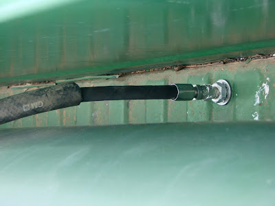

Connection at the tank.  I routed over the tank because there isn't much room under the tank.
Connection on the top side of the bulkhead fitting.  I slipped a piece of heater hose over the liquid line to help prevent sun damage and to keep the hose from rubbing on the tank.
I have to get an under the truck photo of the bulkhead fitting connected to the liquid line.
Connection at the fuel filter at the propane regulator
When checking the connections, once I opened the liquid valve on the propane tank and pressured the lines, I used soapy water in a spray bottle.  I sprayed all the connections to ensure there were no leaks. Leaks would produce bubbles when sprayed with the soapy water solution.  I had to go back a few times and retighten a few connections. Of course, the most difficult connection to get to would be the most problematic, that being the fittings on the bottom of the bulkhead connector.
As for the wiring, everything is pretty simple.  A power wire to the three position toggle switch and primer switch at the dash. Then run wires from the switches to their respective positions.  I used a dedicated ground wire for each valve to ensure proper operation.  You can color code the wiring however you wish.  I used white to the propane lock-off valve, yellow to the primer and red to the gasoline lock-off valve.
I have never used the primer before, but when the primer button is engaged it energizes a little valve within the propane regulator.  When the valve is open, additional propane vapor can be fed through a vacuum hose a vacuum fitting on the gasoline carburetor.  It provides a little extra fuel for cold starts, if needed.  Like I say, I've never had to use it and didn't hook it up (yet) on this setup.
In this photo, the primer is located on the right side of the regulator (with the yellow wire).  Some regulators have it, some don't.

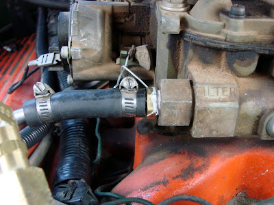

On my gasoline fuel lock-off valve, I used an older style with compression fittings to adapt the valve to the fuel line.  Then more fittings to make a fuel delivery setup that wouldn't pinch itself closed.  It's not the best and definitely wouldn't be ideal for full on racing, but works well for regular driving while using gasoline. A newer style lock-off would probably be a better setup if one was planning on using gasoline more, but I think this will be adequate for my needs.
Additionally, my gasoline carburetor had a working choke, so I disabled it from operating for now by wiring the choke open. At least for now I'm sure the choke won't set while the truck is on propane.

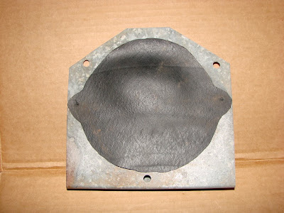

As for the propane mixer/carburetor; when I rebuilt my mixer I used the silicone diaphragm as it is supposed to last longer than the rubber diaphragm. It is the yellow piece in this photo.

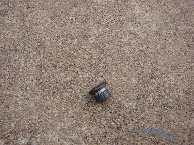

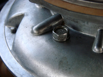

To adjust the air fuel mixture of the propane mixer, remove the plug on the top of the mixer.
This is what the little plug screwed into the top of the propane mixer looks like.
In the mixer is a little slot screw.  Adjusting this screw will allow fine tuning of the air/fuel ratio delivered to the engine.  While tuning, if you allow the weight of the screwdriver to rest on the screw, it will affect the ratio. So I used a light hand and tried not to allow the screwdriver to rest on the screw.

With the Impco 300 setup as shown, the cable operates a cam under the mixer/air cleaner assembly which in turn opens a "valve" to allow outside air to bypass the propane mixer and go straight into the carburetor.  This would be for gasoline operation.  The 300 with an adapter is normally set to propane, you pull the cable for gasoline.  There is a photo that shows the mixer without the air cleaner and the "valve" in the open position for gasoline operation.  I guess I didn't get a photo of the valve in the closed position.

View of the silicone diaphragm

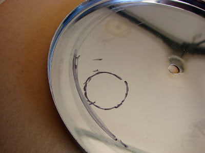

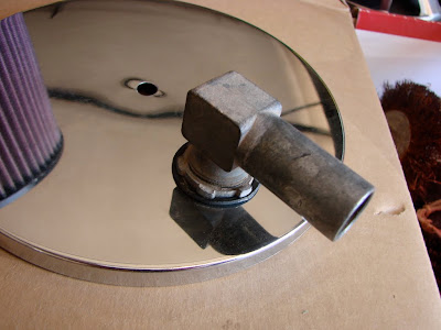

There are no crankcase vent ports on the 6 1/2" cleaner so I added an inlet to the top of the air cleaner. I set the filter on the air cleaner "top" and marked the inside diameter of the filter
Then using a air cleaner fitting from another propane setup, I marked the hole in the top of the air cleaner.
After I drilled out the hole, I installed the fitting and snugged it down.

Finished shot of the Impco 425 with gasoline carb adapter and a custom air cleaner setup. To complete the install process, you attach the propane vapor line (from regulator to the mixer) and hook up a crankcase vent hose.
This view shows the air cleaner with front bracket.

heck forget the pictures right now, that exactly what i have. a 425.
78 Chevy Custom Deluxe flatbed, PROPANE POWERED
     Once again thanks Jason S, I have really enjoyed reading/learning from you.  One question.
     The back hose is for the propane vapor inlet correct ?  Is that front hose hooked up to the PVC valve ?
     I love that air cleaner set up, it looks great and very clean.
« Last Edit: May 17, 2012, 06:44:57 am by bake74 »
Offline Jason S
  • Posts: 1561
Thank you very much Tom.  I'm still learning about propane myself, but if I can save someone from having to retrace their steps then that will make my day.
When I assembled the parts for the air cleaner, I didn't want to invest a lot of money in them just in case I didn't like the 425. I mainly wanted something inexpensive that would work.
The K&N filter I used (E-3346) was the right size for what I wanted, I just wish it had some more rigidity. I spent a lot of time in the Wix catalog at O'reilly's looking for something else, but either they didn't have it in stock or it wouldn't work...
The back hose is the propane vapor hose.  The PCV valve and hose is still connected to the gasoline carburetor.  The front hose is the breather. I could've just stuck a breather in the valve cover, but I chose to run it to the air cleaner.  For now, this setup works. I'm thinking that I may re-engineer it when I get my shop setup after the move.
Because of getting ready to move, house hunting, new baby and all I really haven't had much of a chance to run the 425 and compare it to the 300.
