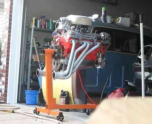

It's been a while since I've been on here, but I wanted to post the latest progress for my '86 K10 short bed. The stock 305 and clutch are about to give up the ghost. I built this small block for it almost 4 years ago. Was saving it to install when I could do a total frame off, but that isn't going to happen for quite some time since I have a lot of other things going on right now. I have to keep this truck up and running since it is also used as a 3rd vehicle when needed, and HAS to be dependable. I haven't driven it daily for the last 3 years since the 305 and clutch are in such bad shape.
So, I dragged this 355 that I built for it out of the mothballs and pretty much have it prepped, tested, and ready to go in now. This video is actually the 3rd start up since I had some fuel leaking at the fittings and at the pump on the second try after I changed carbs and lines out since I thought that I had a problem with the Holley that I originally put on it. And....NO, I didn't let it idle! It has a flat tappet cam! Specs are as follows:
4 bolt main 0010 350 block bored .030 over
Factory forged steel crank, .010/.010 (1182)
PM forged GM rods set up for floating pins
Speed Pro 2VR pistons
"487" GM heads,  ported, polished, 2.02/1.60 S.S. valves
Complete Comp Cams valvetrain and 1.52 roller tip rockers. 268 XE Comp cams flat tappet hydraulic cam. 224@.050/230@.050 duration, .477/.480 lift.
Hedman ceramic coated 1 3/4" large tube headers.
GM Performance Parts dual plane intake manifold.
Carter AFB carburetor.
Now it's a matter of doing the hard part and getting it put in! Hope this video works! Enjoy! ...Joe

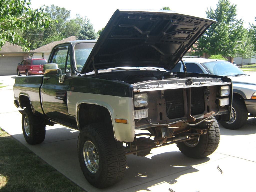

« Reply #10 on: April 21, 2012, 05:17:28 pm »
Here's one. Ugly as sin and needs a LOT of work but still my favorite vehicle!

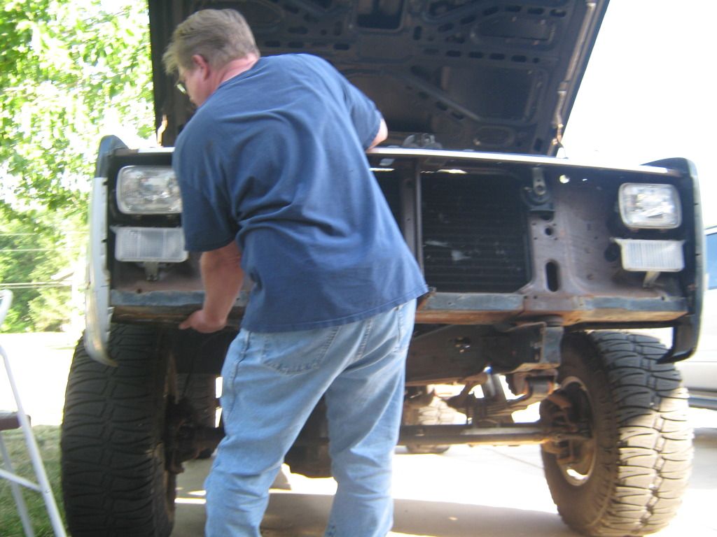

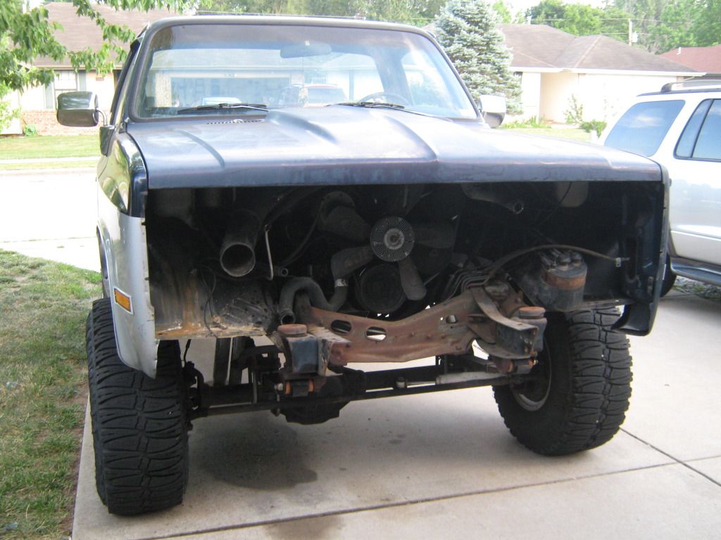

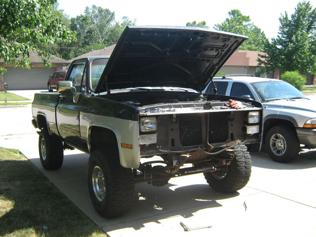

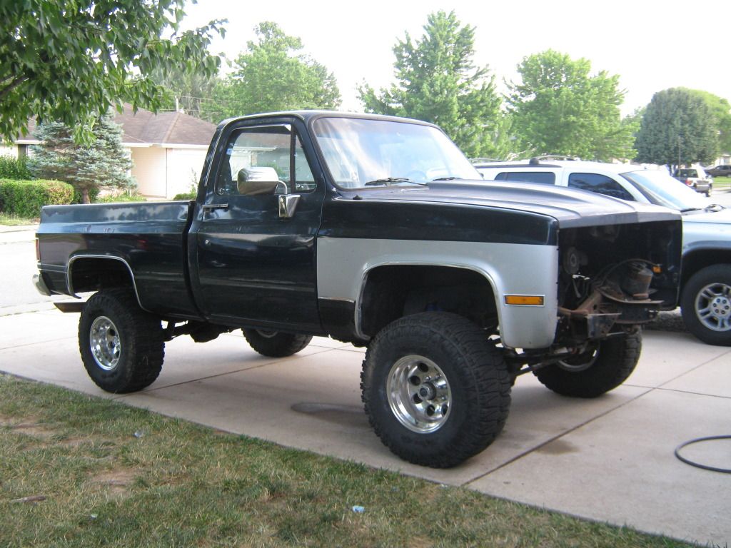

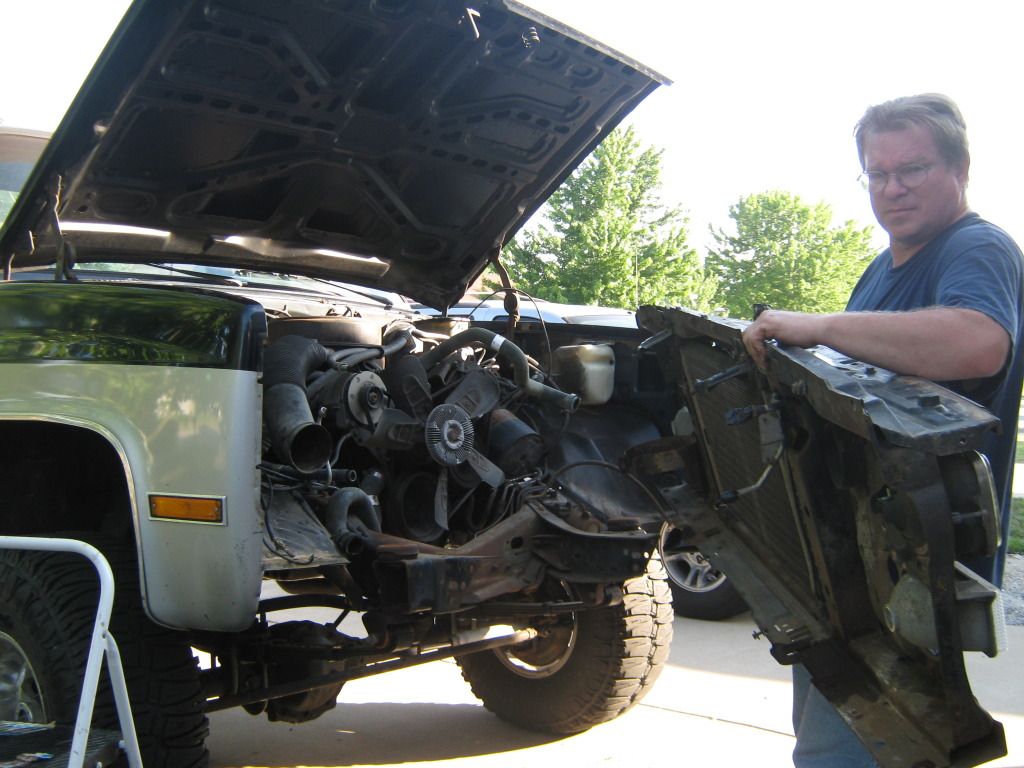

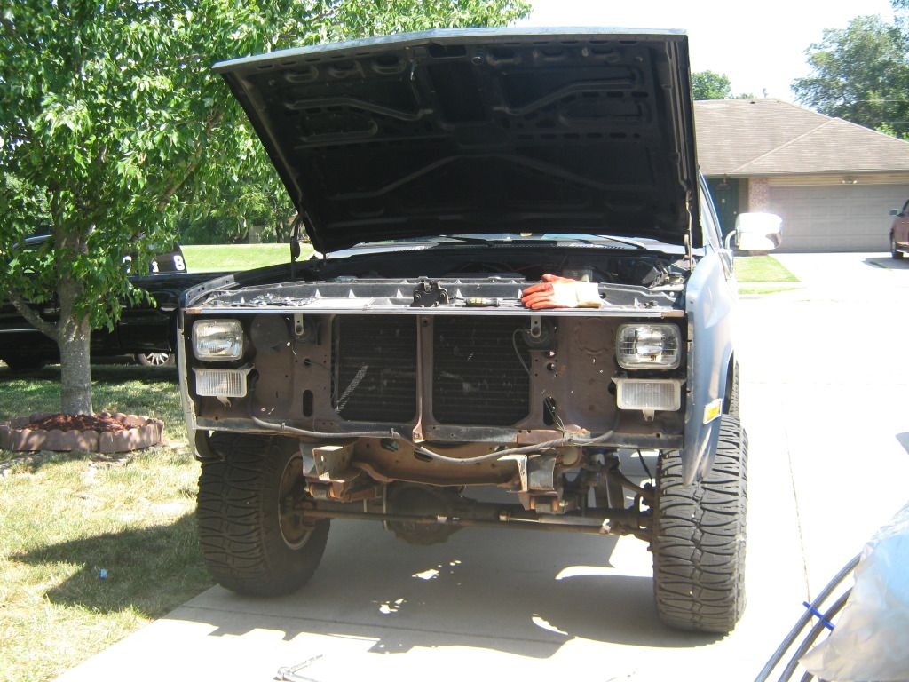

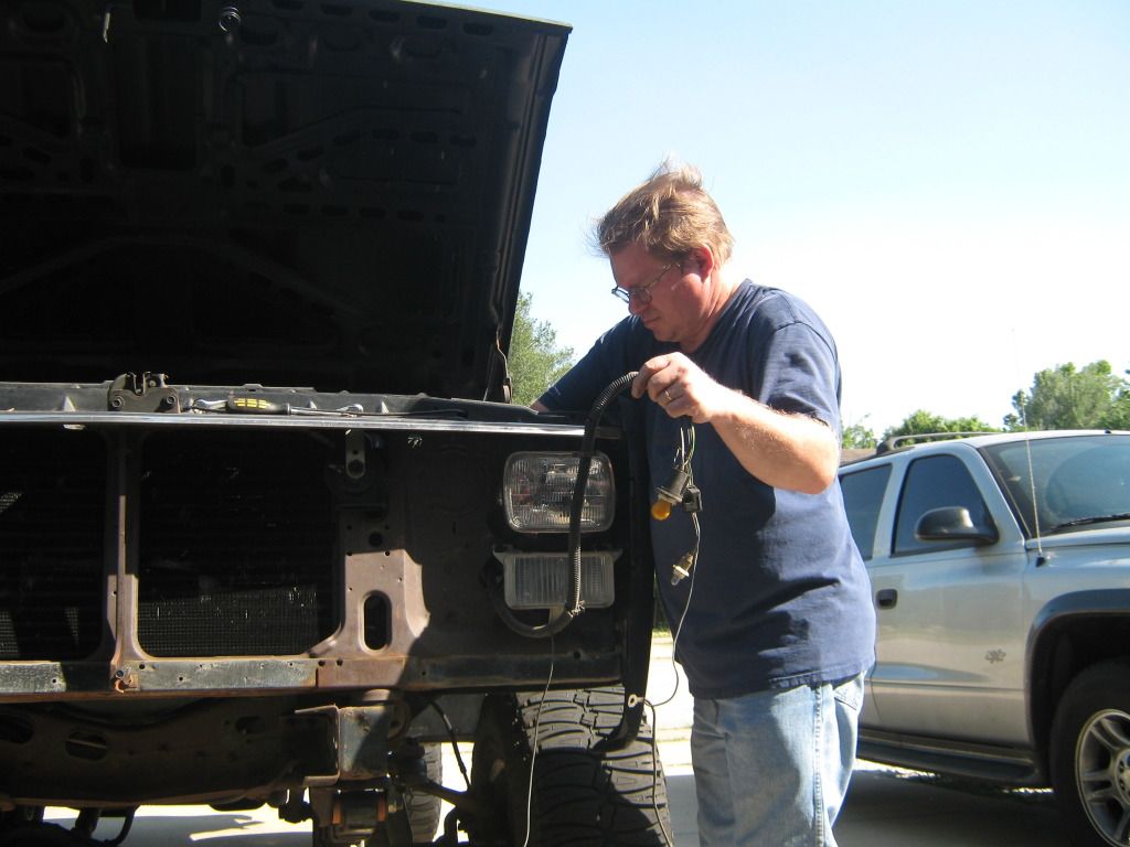

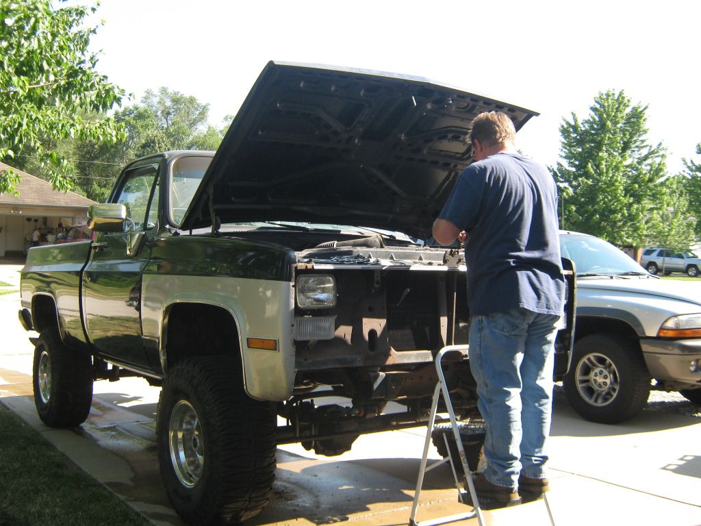

« Reply #11 on: May 30, 2012, 02:43:49 pm »
The tear down has begun. Haven't gotten a lot done since these pictures were taken Sunday since I have been putting in a lot of overtime at work lately. I'm hoping to get the 305 uprooted sometime this week, Sunday at the latest. I have also changed my mind as to which 355 I'm going to install (I have 2 of them). The one that I've decided to install is basically the same as the one in the video posted previously with the exception of a cast crank. It also is a fresh .030 overbore 0010 block, but with 2 bolt mains. It has forged TRW flat top 4 eyebrow pistons, a Comp 280 Magnum cam, and ported and polished 993 casting heads topped with a Summit dual plane intake and Holley 600 carb. I decided that I put so much work into the first one, and that it was such a nice piece that I want to save it for an eventual frame off some day. For now, this one will do the job, and other than the cam, crank and 2 bolt mains is basically the same build. I'd bet that power output between the two would be less than 5 h.p.. Video of this one is also on photobucket. It kind of startled me since it stated right up in the test I did on it. Thought that it was going to jump right off the stand!
