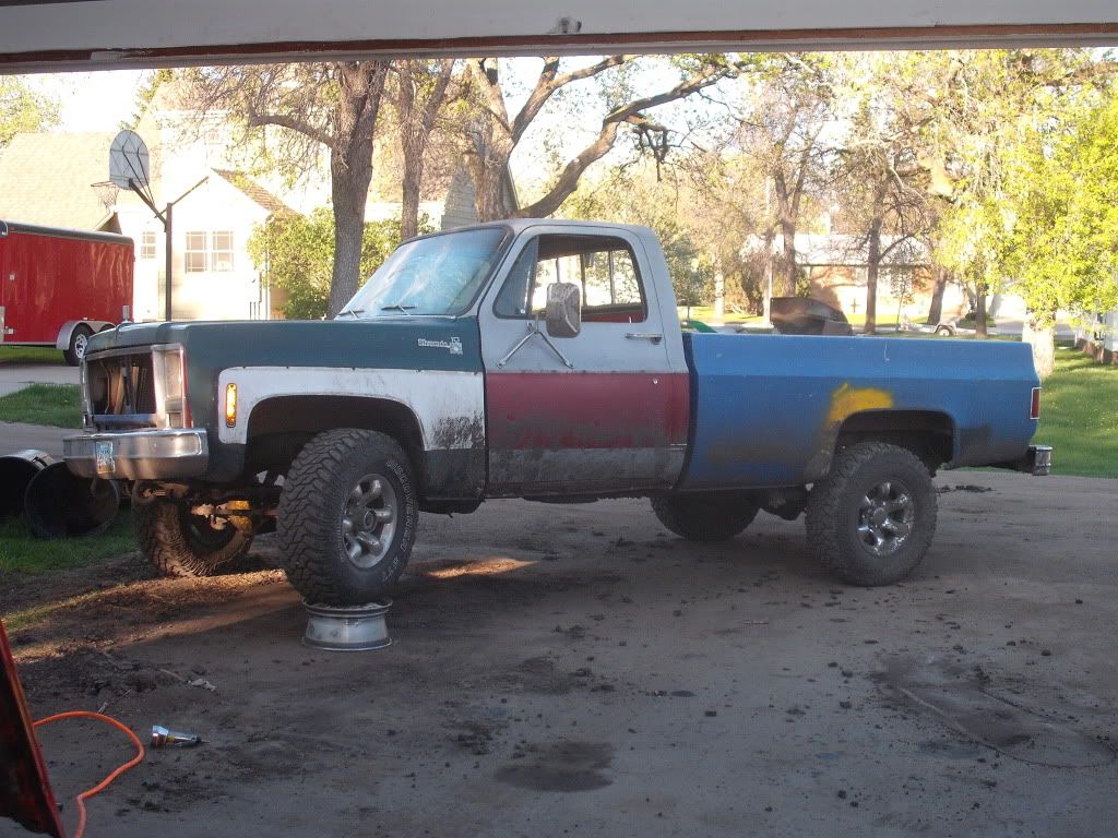

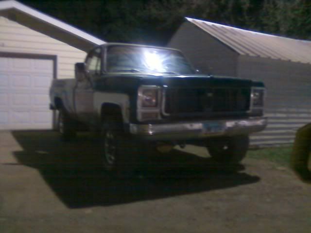

Kay,theres a LONG story behind this truck of mine, My buddie had it after his uncle's died,one day we went out rinding quads he didn't see the approach and Calvert (night time ditch riding) and 50mph jumped the quad rolled it a few times and totaled out the quad(my brothers quad)So in return he had no money but the pickup,So the 77 was now my bros.When we go it it didn't run (flexplate bolts where loose,carb work)So i pulled the 350 out replaced it put new plugs and wires in,got it running....needed a new steering column(they broke the key ignition to pull it on a trailer (i found a key under the seat year later) lol,SO one day i told my bro i do all the work so sell it to me (he did,i bought it for like i think $200)I then put a junkyard rebuilt once apoditime tranny in it.it leaks,it will get fixed soon,Motor is really week,the rocker arms sit sideways and make a loud clink noise and burns oil like you wouldn't believe.I got a motor out of a 95(K1500 my lil bros)I'm rebuilding it right now...any way the body of this truck is was really Bad,Dents and rust every ware...80 Rad. support,I have newish bumpers off a 74,Just like new fenders and hood off my 78,different cab and doors from a 76,Box from a 80...the cab has lil rust I'm going to replace with new panels...plans are to paint it flat black with flat clear coat....OH rims and tires paid $1000 for just like new Cooper discover STT 285/75R16 Eagle polished aluminum 16's

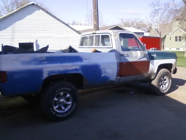

<<<what it looks like now 4/24/2012

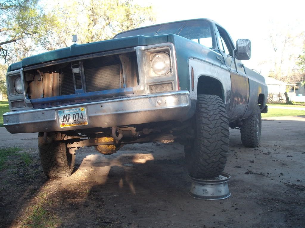

I love those front-ends!

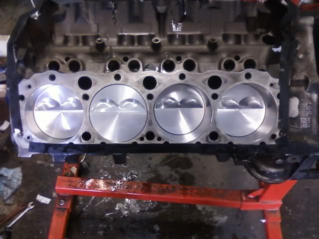

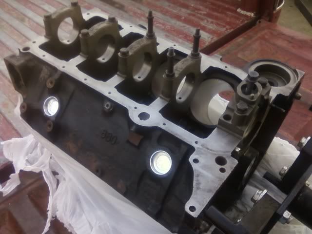

I got my motor back from the machine shop last week. Bored it .030 over
Stock crank,Eagle I beam rods,Keith Black Hypertectic flat tops,Clevette 77 bearings,Compression ratio is ruffly 10.1:1
yes i know my floor is dirty
I plan on port and polishing the heads and intake,Reseat the valves....More to come soon i hope,OH almost forgot,The motor that was in the truck when i got it,I took the valve covers off and found a nasty suprise....ALL of the valve stems,rocker arms where messed up....They sat on the stems cruked and the rocker arms were worn bad and i had a few bent pushrods. Not good

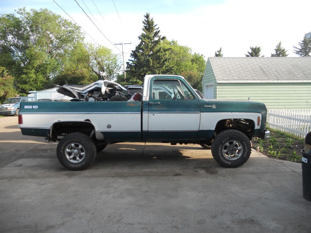

Well,money is tight right now,so i cant paint my truck...Althoooo

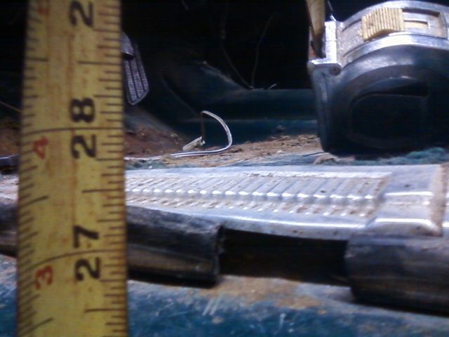

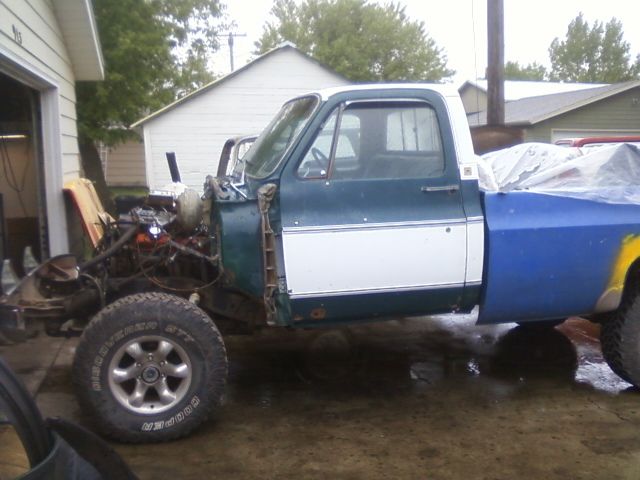

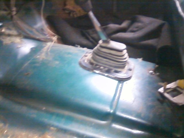

I have a 78 2wd with matching colors (no motor or tranny) Because the 2wd hump on the floor isn't tall enuf and i don't want to cut the floor open,I'm installing a 3 inch body lift. I'm gaining 3 things from this body lift,1 i will have a lil more room for my 33's 2 i wont have to cut the floor 3 its almost to tall to fit in the garage
...Because i don't have my kit yet and needed room lol i used extra body mounts that just so happen to be 3 inches
i found that Prudy cool,i was stoked lol,So let the pics begin.....
WARNING: I did this to get the cab inside and out of the rain
What i did was just use some extra mounts
Works well with a 3inch body lift
Yeap thats not good lol
I cant wait till my REAL body lift arives =)

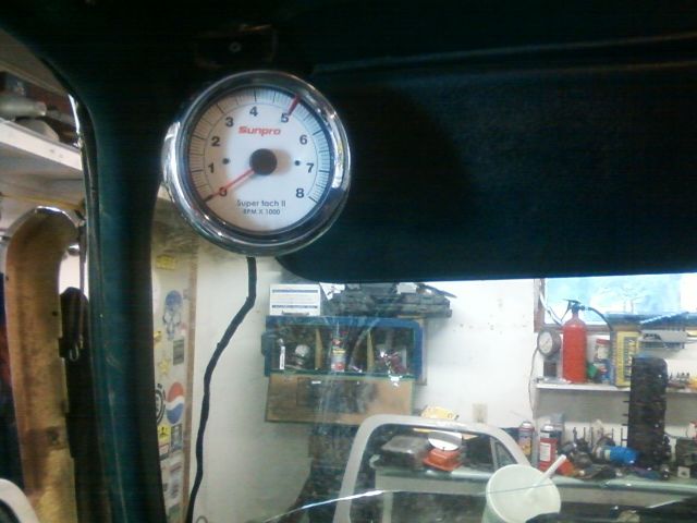

Theres my tach location.I love it there,cool place for it(visers don't really go up tho lol that's OK)
So tell me what you think...ill get my box on this weekend and hope to have it together

That will make putting your body lift in easier with the cab already lifted up for you to work on.

OK got my 3 inch body lift,and polyurethane body mounts....

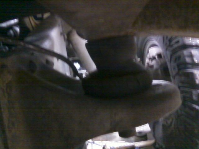

Sagging in the back because the way i took the pic...Other than that it sits lower in the front

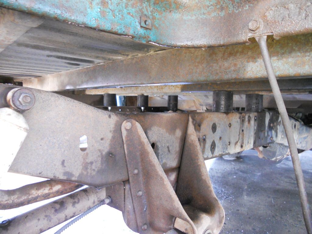

Frame shot...See that bracket in the wheel well....there on both sides WHAT ARE THEY FOR!!!lol doesn't make seance to me
another frame shot

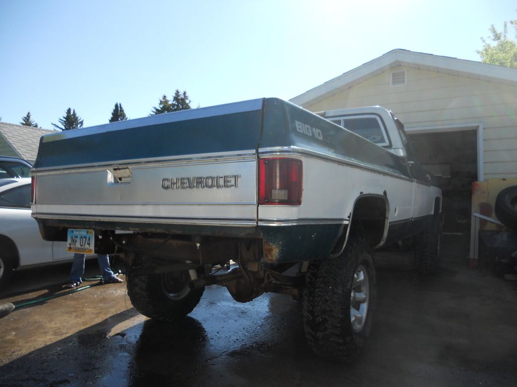

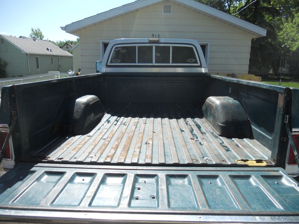

box needs very little work

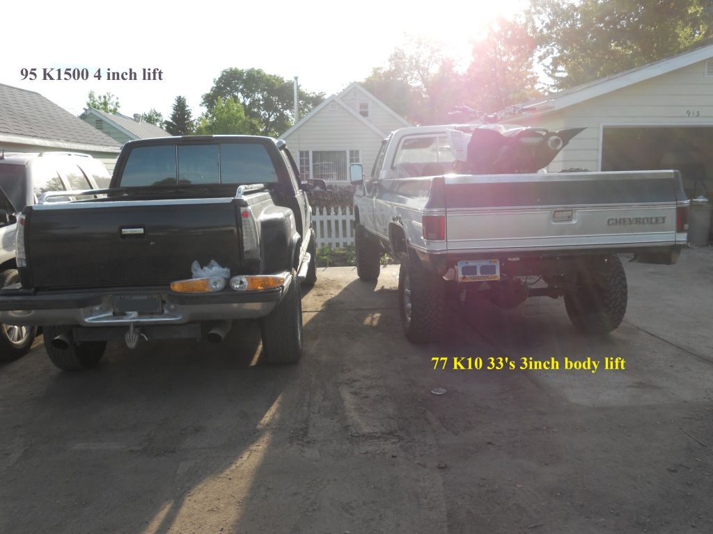

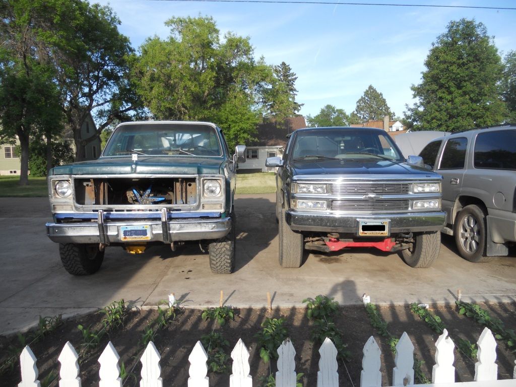

brother 95 and mine
