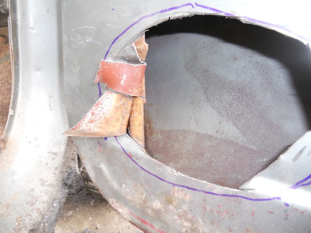

I'm going to tackle puting 6x9's in my 76 K10 (really a 77 with 76 cab),
I found a Brace i had no clue was there
It started to rain out so i quit for today...and i cleaned up the cuts a lil better...More pics soon to come

     That brace is why Kaptkoas says he would never put speakers in a door.  Some people love them in the door and some hate them in the door.  To each his own.  Make sure when you mount the speaker it mounts through the door skin and that brace so it does not vibrate going down the road and kill your speaker and sound like you know what.

Thanks for the info...Always learning new hits and clues

Don't let them discourage you, the bracket isn't a problem in the least.  just make sure the bolt holes you drill in the skin are also through that bracket so the screws will go in right.

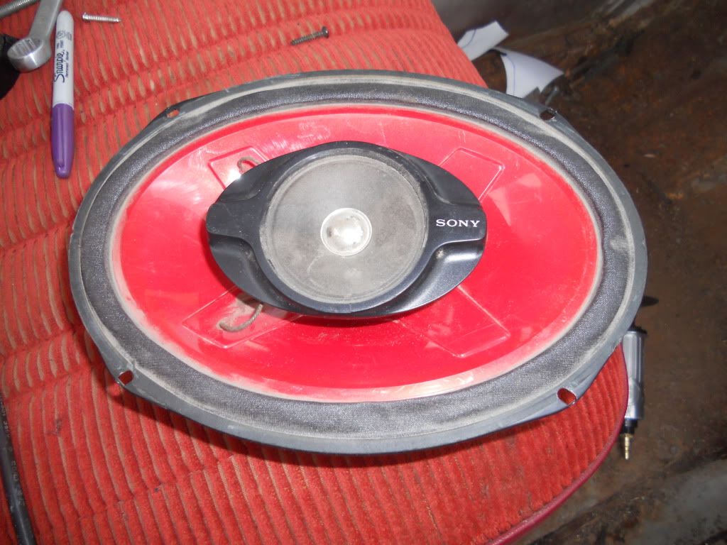

 welp i got one speaker in...i kept having too cut an cut and cut bigger holes each time to get a snug fit

Looks good man.  Only trick I found on my 77 was making the two speakers match, locationwise....
As long as you had to make the hole BIGGER, you're OK.  Making holes smaller is where problems come from...:)
