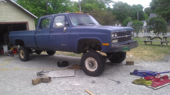

Sold off my mud trucks, scored a screaming deal on my new minivan.
1991 V3500 4x4, Dana 60, 14FF, sb350, 4L80E, NP205, 6" RC lift, and so far, 20MPG!!!!!
70,000ish miles, and not a leak anywhere.
Planning on some nice chrome wheels, 35" mudders, headers, some deep throaty pipes, a fresh paint job, some new stock bumpers, and some better trim up front.  Open to ideas, suggestions, whatnots.
Small concern, I've been looking into this height sensing proportioning valve on the rear of my truck, and since I lifted it 6", you can imagine it don't line up anymore.  I figure I'll have to fab up a longer lever assembly (~6") but what I'm not sure of is how it should look stock.  Does anybody have a stock setup picture?  I was foolish enough to not pay enough attention as to how it was before I pulled it apart.

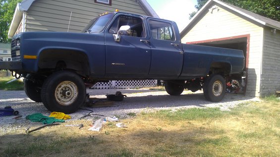

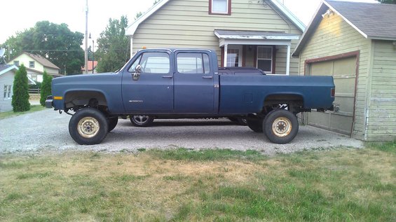

Drove it for the first time since the lift install.  It's taller than I planned.  I forgot about the frame being 2" taller than a regular truck.  Still have to change out the exhaust to put the front shaft back in.  I love lifting these SUPER easy square bodies, simple and straight forward.  It's just routine now.  Buy truck, buy lift, install lift, then it's normal.  Stock trucks look so lame to me...
I don't know the history of the truck.  I bought it from a private party in Minneapolis.  The interior is mostly stock.  Someone, somewhere along the line put a different dash pad in there.  It's got rubber floor liner, cloth seats, crank windows, manual locks, bone stock stereo...  I'm thinking it was either a USAF or a county truck based on the mileage.  Just over 70k!  Fires up and purrs like a kitten.  There are holes in the bed sides similar to military use.
As for tires and wheels, I'm still debating.  I might go with some more mild mud tires, nothing extreme like boggers or v-treads.  I put the 6" springs to clear 35's without worry.  But I hate seeing a lifted rig with street tires on it.  All terrain tires just seem wimpy to me.
